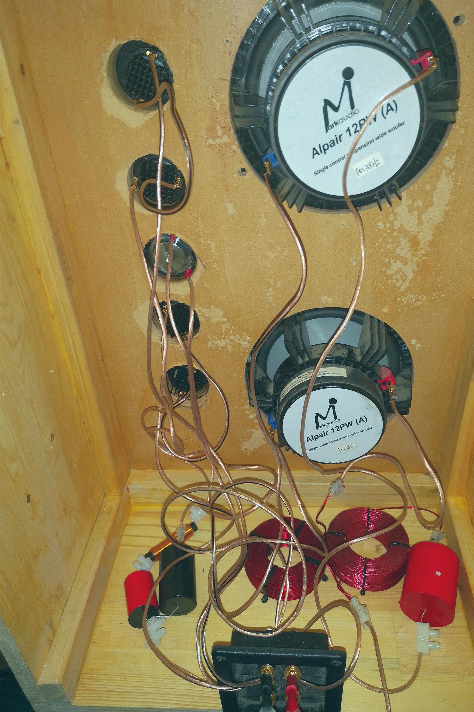

Old school multiway
An amplifier packed it in recently, and I got to thinking an old school speaker without active crossovers or DSP might be a good thing.
This is an existing speaker I converted to all passive yesterday using only spare parts.
Series parallel wiring lets the tweeters cross as low as 900 Hz, so this was a chance to hear how they do with six slopes, and through the rest of the speaker.
Similar bandpassing as with its active version.
Deep bass isn't crossed over, just 60 hertz augmented 4 slope, from 2 spread sealed subs.
Nice low parts count, and I don't feel like the sound lost a thing using just a single small amp on them .
Pretty decent bass with no subs on music, but Godzilla's a lightweight without sub help.
Only one tweeter is used as a tweeter, and it got some acoustic foam beside it to limit sidewall reflections a little.

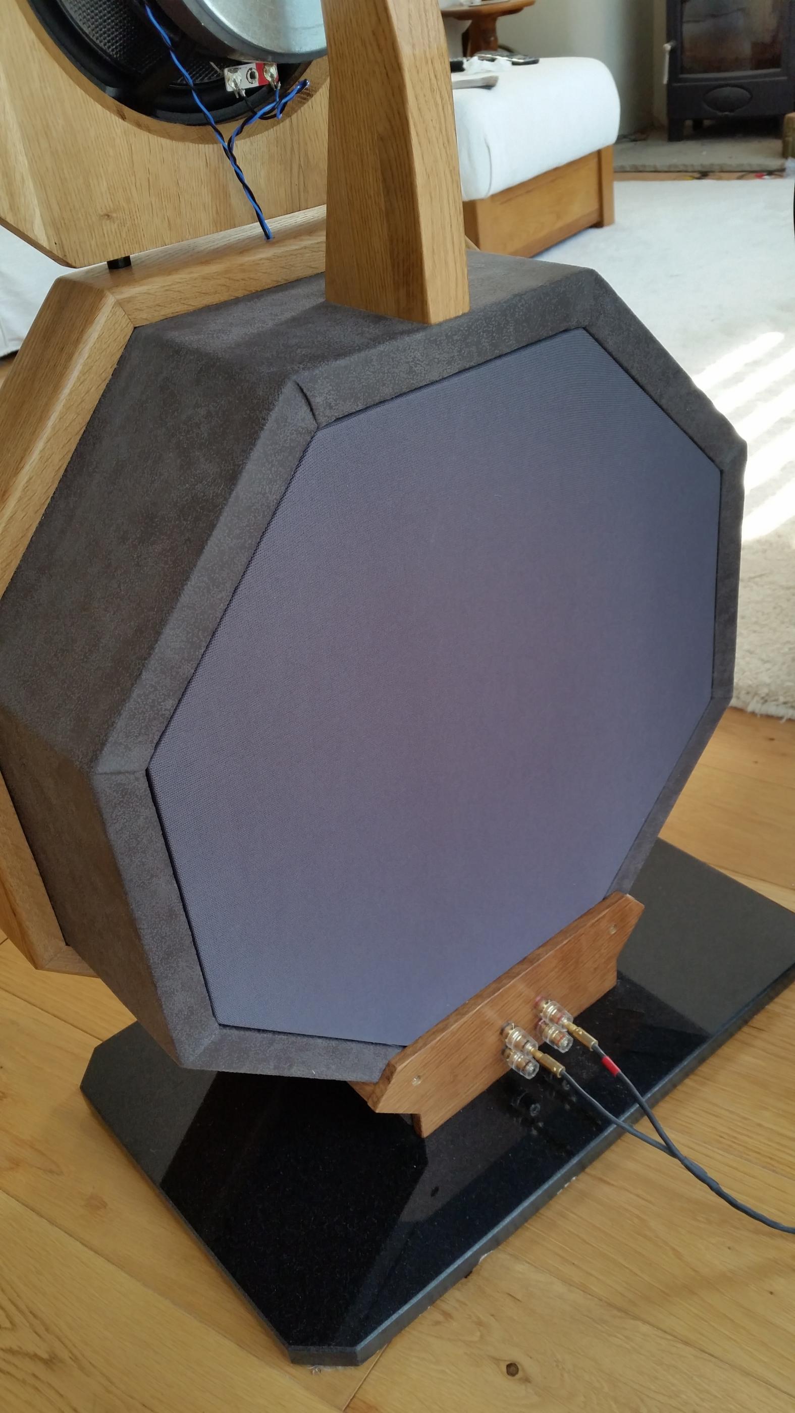

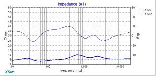

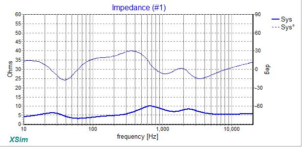

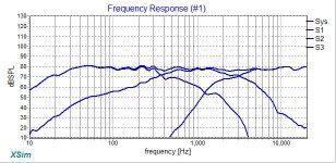

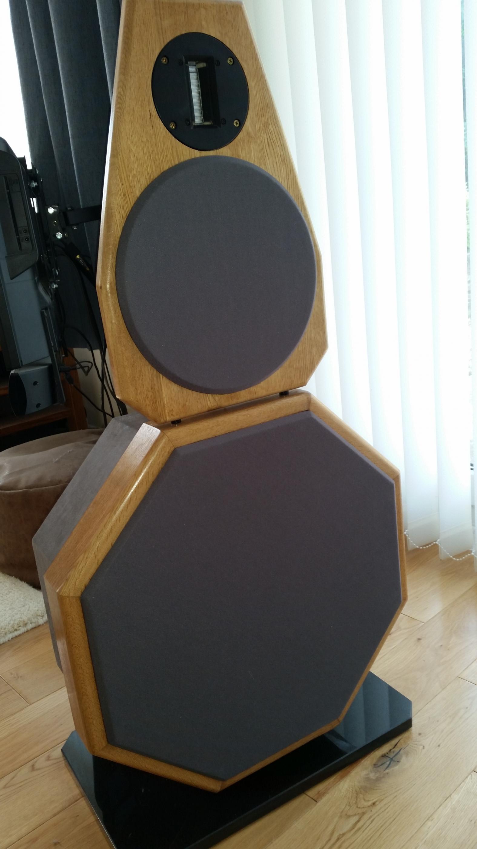

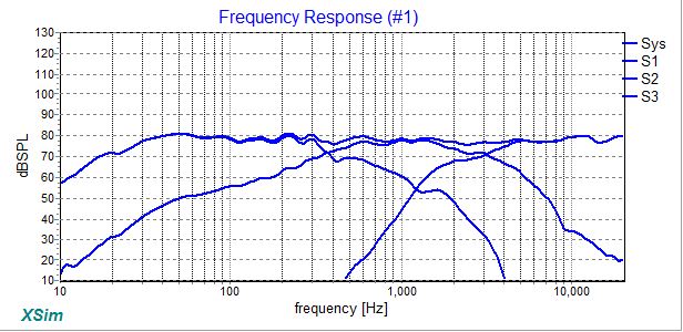

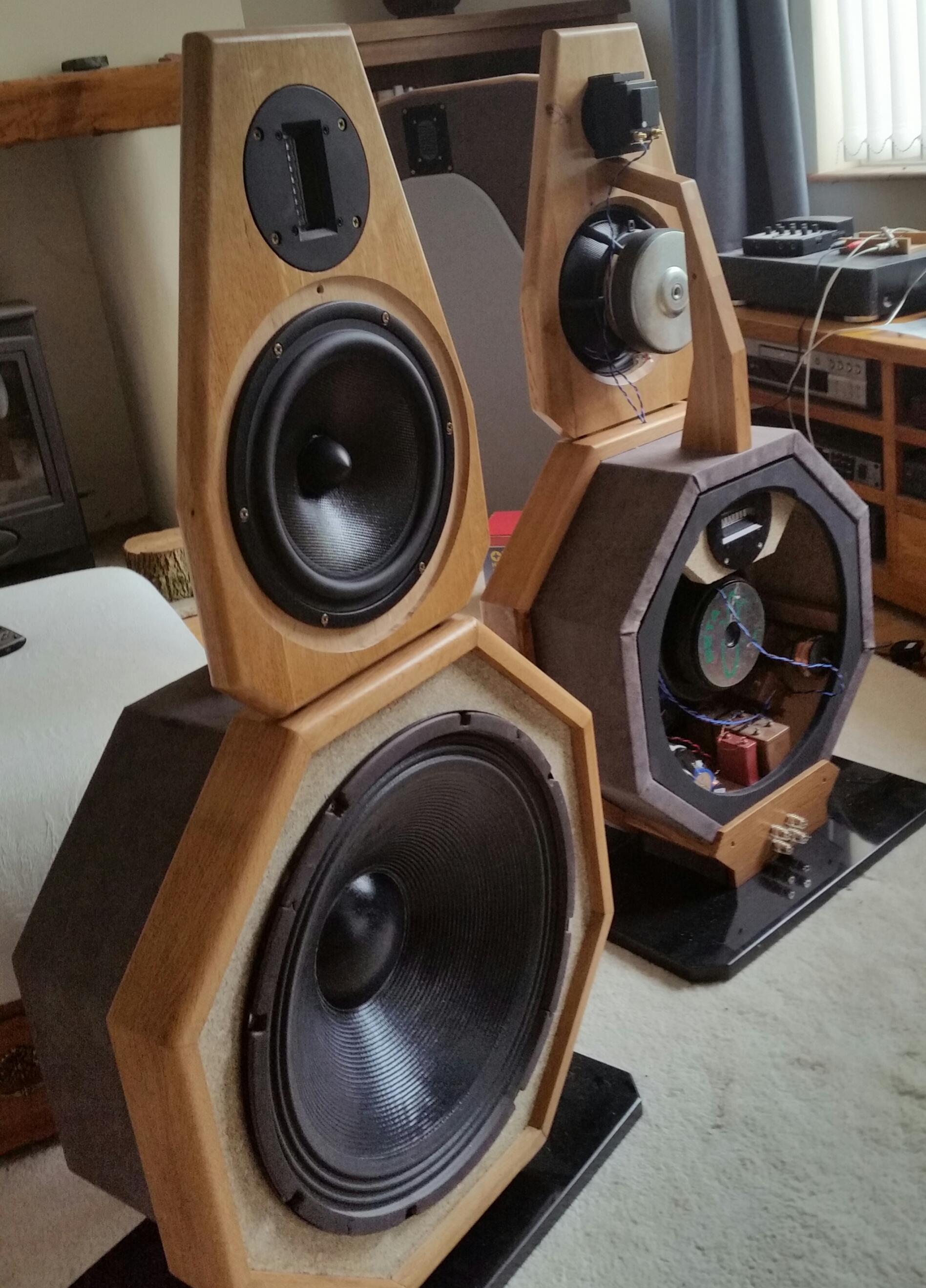

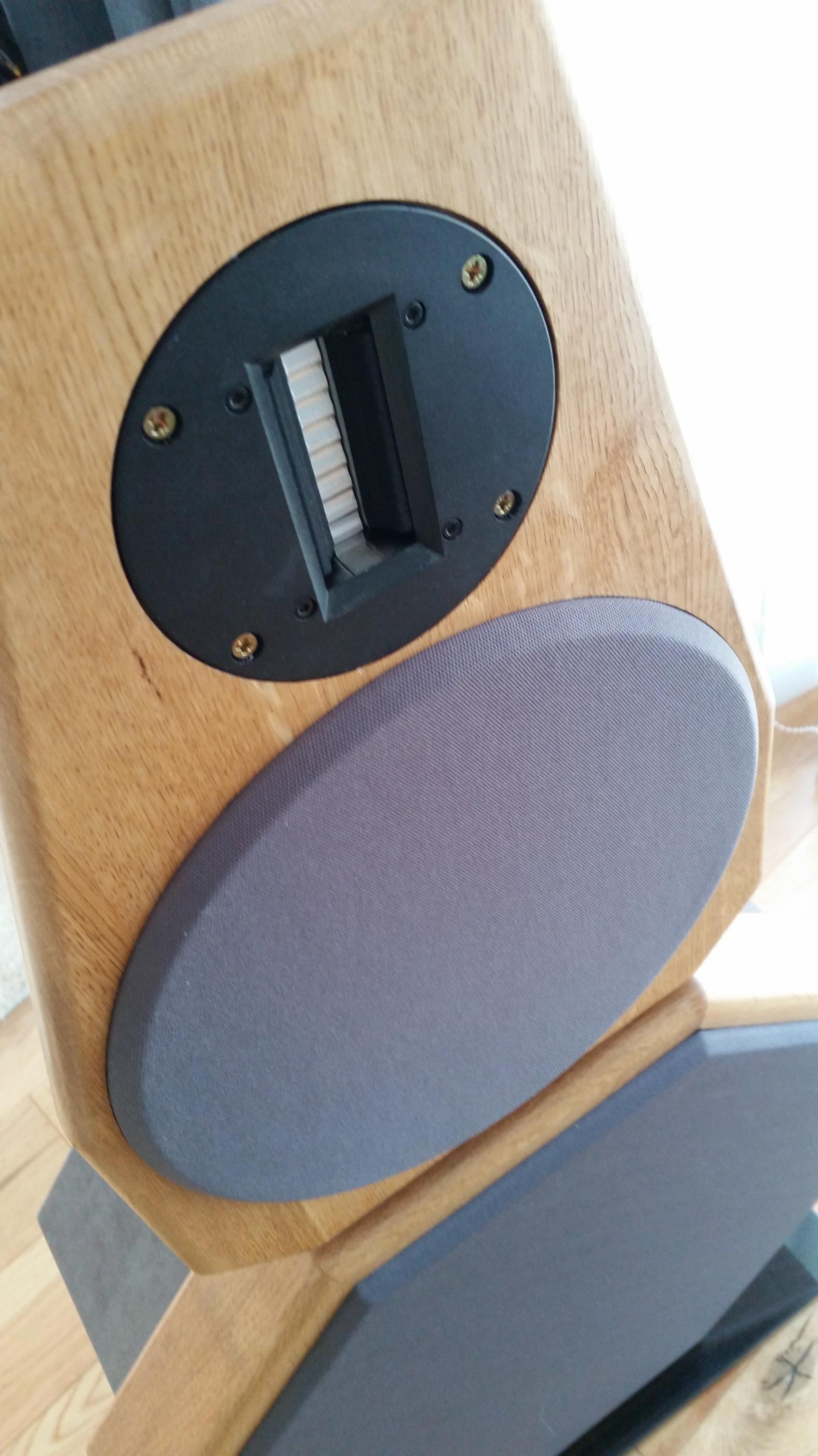

Here is my latest open baffle design/build.
Drivers are Beta15a, Seas U22 and Aurum Cantus G2si and there's a second tweeter on the rear as I prefer that to just a single front one.
My previous OB which was on a single, larger baffle used open-backed Mundorf AMT with Seas U18 and Alpha 15a and though I like the Alpha very much but the Beta does seem to sound cleaner. Overall the sound is very smooth, clean and transparent :cheerful::cheerful:
