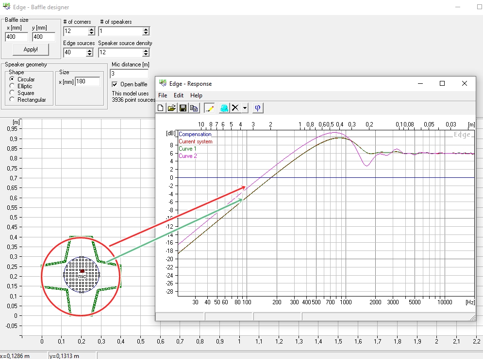

Can anybody suggest a way to simulate a drive unit in open space, i.e. not on a baffle?
In Basta when I simulate a very small baffle around the driver I can see the baffle step response as expected but when I move the driver off the baffle into free space the usual baffle step effect becomes almost flat, which seems strange to me.
I haven't used Basta, but is there Open baffle toggle somewhere like in The Edge?
The Edge is the easiest way for that. Just toggle Open baffle! Yes you must have a baffle, but overlay baffle and driver with tiny bit smaller diameter! Baffle with 12 corners behaves just like a circular baffle with same diameter.
VituixCAD 2 is total speaker/xo simulation package with several modules eg. baffle effect simulation.
Even a naked driver actually has a baffle, as the basket normally has an bigger diameter than the cone.
So for good simulation results of a naked driver in Edge, I would take the cone diameter as driver diameter in Edge and create a circular baffle (or use the method described by Juhazi) in the size of the overall speaker diameter.
At least for my measurements, this method gave me the most realistic results.

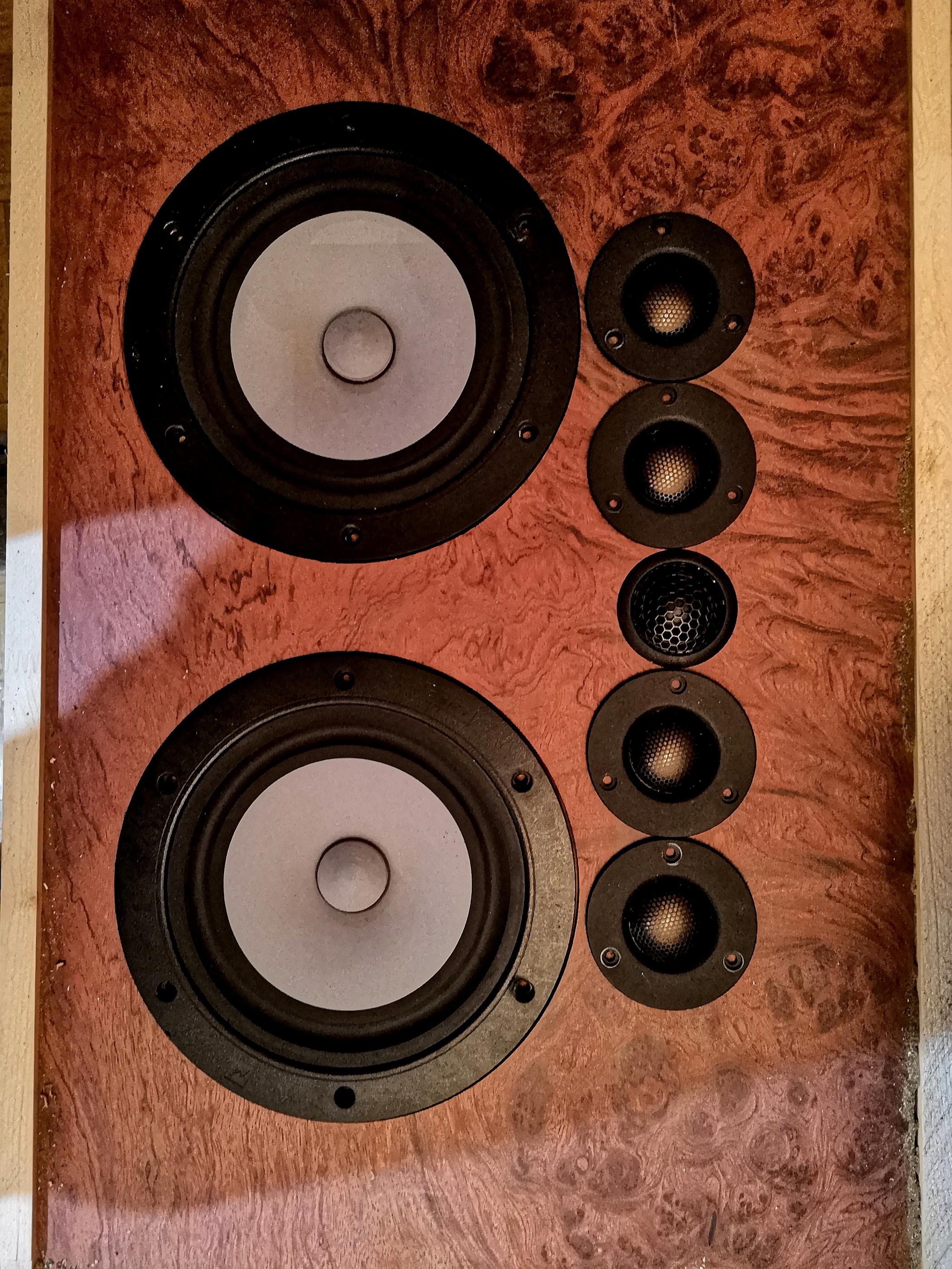

Satellites
Still burning up spare parts.
This is a follow-up to an earlier experiment to address comb filtering. It doesn't quite do it by the numbers, but is far closer than conventional tweeter woofer pairs.
Crossover points are a 2700 hertz highpass to a 2" Seas fabric dome tweeter, 2500 and 800 hertz bandpassed 3" metal dome tweeters, and lowpassed at 800 hertz MarkAudio 12PW full rangers, one lowpassed at about 375 hertz solen split .
Crossover points are just guesses based on similar designs, and will likely be tweaked.
Deeper bass will be provided by a plate amp and existing panels to be used as open back bass players.
Just a first dry fit, enough for one day.
3/4" light stock for U wings, MDF laminated to 1 inch thick baffle. OD 10" x 16" x 25".
Sort of an ugly duckling, but I wanted a tweeter that's an inch smaller than the bandpassed pair.
