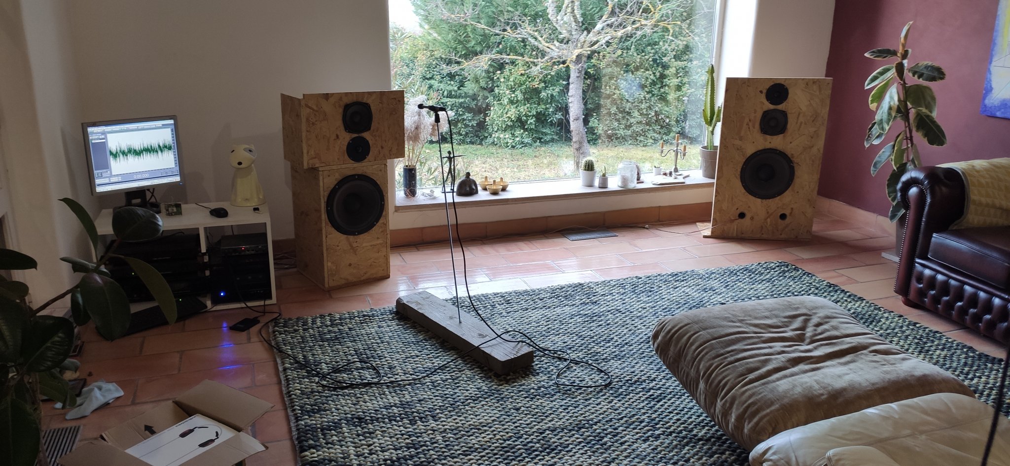

I listen to a wide variety of music, Classical, Jazz, Pop, these speakers cover everything. Recordings from the 70s can be really good and beautiful at times, those speakers can handle beauty. The rolloff is mainly a measurement artefact, I guess. I draw the microphone response correction data myself from the frequency sheet delivered with the mic, so it might not be correct up there. There is no eq shelving in the treble region, I kept the tweeters flat and trust their datasheet. And the crossovers on these speakers are still evolving. Right now I am listening to 24 dB Linkwitz Filters at 90, 300 and 1900Hz, phasecorrected with camilla and like it a lot. A 6dB rolloff from 10HZ to 10Khz sounds natural and right for me and my ears, but that might be a matter of taste. The beauty (and curse
You really should invest in cheapo measurement equipment, and learn the use of it. A sound card + mic sets you back 100€ or so. It is really fun to do and you learn something during the process.

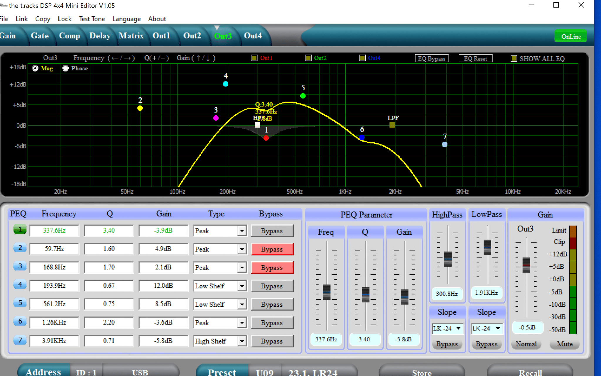

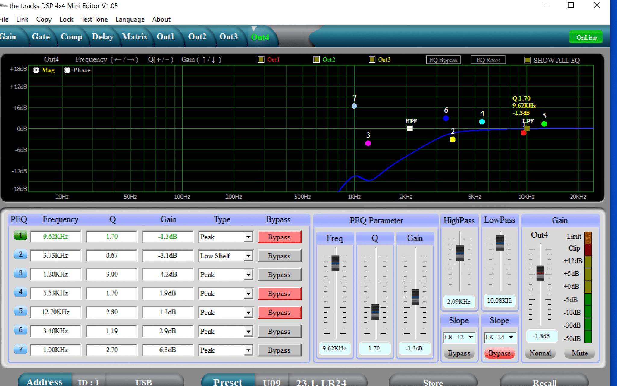

But here are some screenshots of the curves of my T.racks 4x4 dsp that I use at the moment. Since I use individual amps with different gains (like around 18dB for the tweeters, 23dB for Highmid, 26dB for lowmid and unknown for the subwoofer, you cannot simply translate that to another system.
And I just used the sb Satori because I had it at hand, I am pretty confident that the sb-17 would perform nearly as well and possibly better on the rear side of the speaker.
And I installed a volume knob on the subwoofer amp, because the right amount of bass is really different at times, depending on listening volume, recording philosophy and daytime

Ah ok this explains a lot. That is a very cool amp! I have been looking for other affordable amps with DSPs. Good to know that your mic might not be reaching all the way up as well. I do have a U-MIK1 that I have been using to measure and tune my systems. It's a lot of fun.Hi

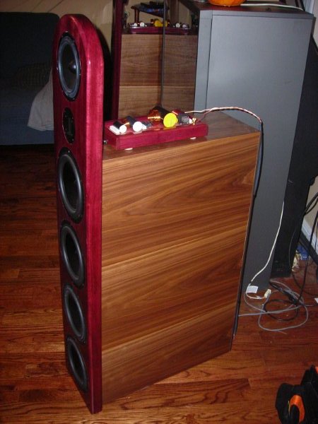

SEAS, Fountk, 4 Dayton 8". Built these about 12 years ago. Listening to them now. No need for subwoofers, great for HT and music. Ppl were sceptical about how they would sound, until I built them. Off axis is great because the wife and I both listen to them.

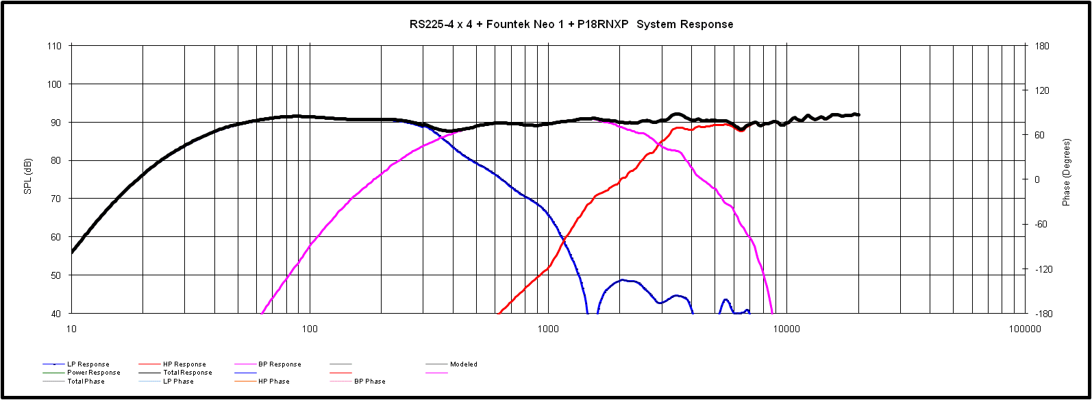

I would have to look it up, but that graph is measuredHello,
What is the cutoff frequency between low and mid drivers ?
How do you deal baffle step especially for the mids ?

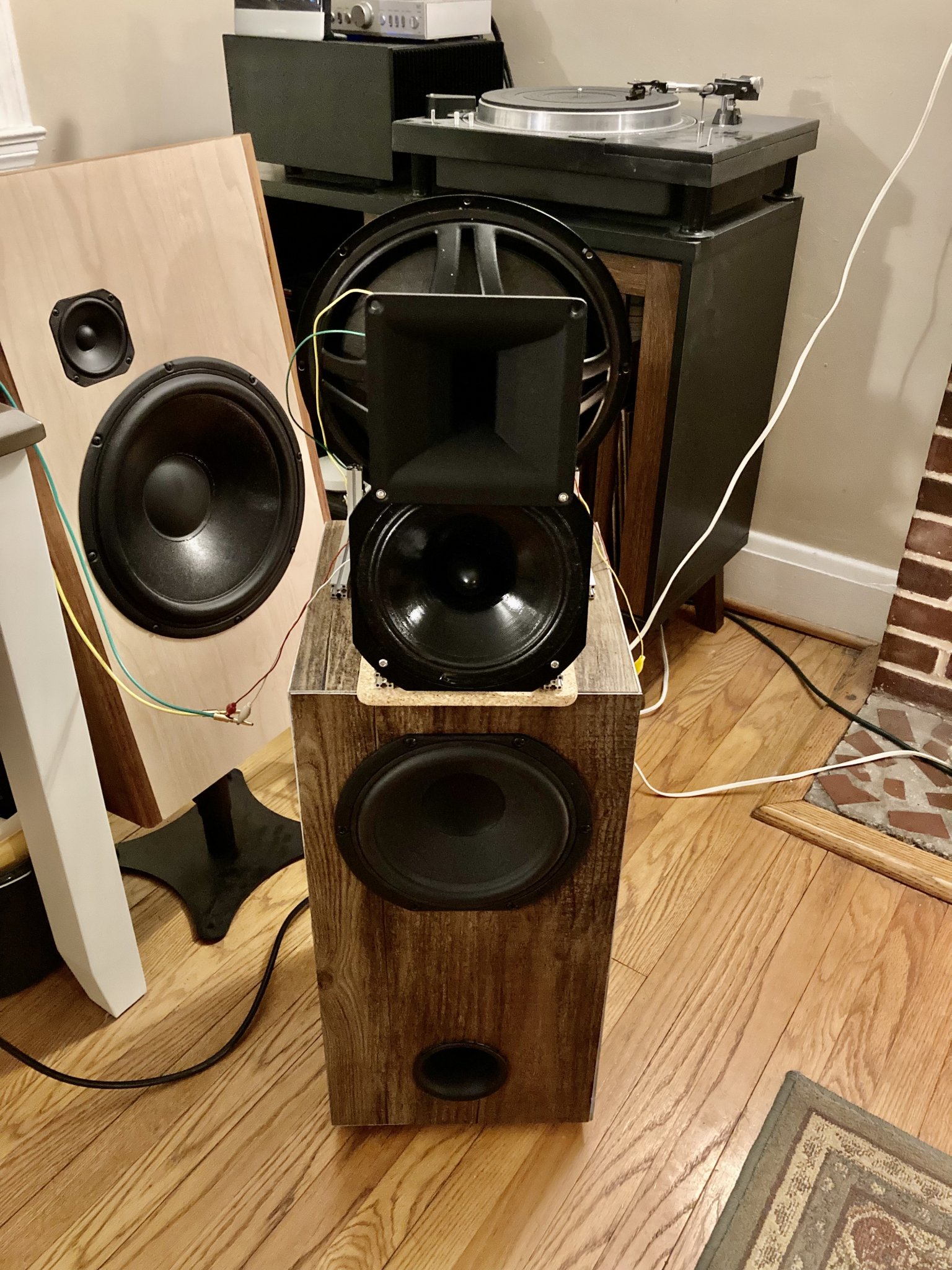

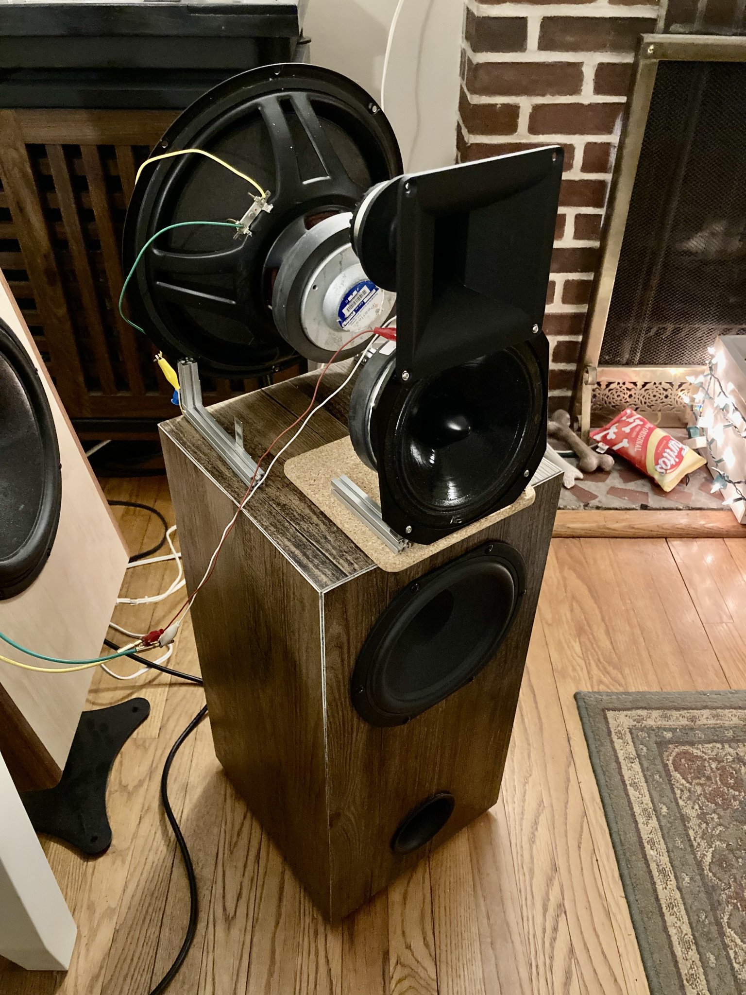

No baffle madness!
The box below is just a stand. Ignore the Manzanita for this instance.
Woofer: Peerless 830669 (leads reversed)
Mid: Focal Audiom 7A2
Tweet: B&C DE360
Software DSP crossover 4th order LR at 300 and 3K.
(https://www.diyaudio.com/community/...over-design-implementation-with-linux.330273/)
Just one in mono is really fun to listen to!
If I had more and longer pieces of makerbeam, this could be a solid and compact unit of a speaker.
I’m sure I’m breaking a number of rules here, but it sure is enjoyable.

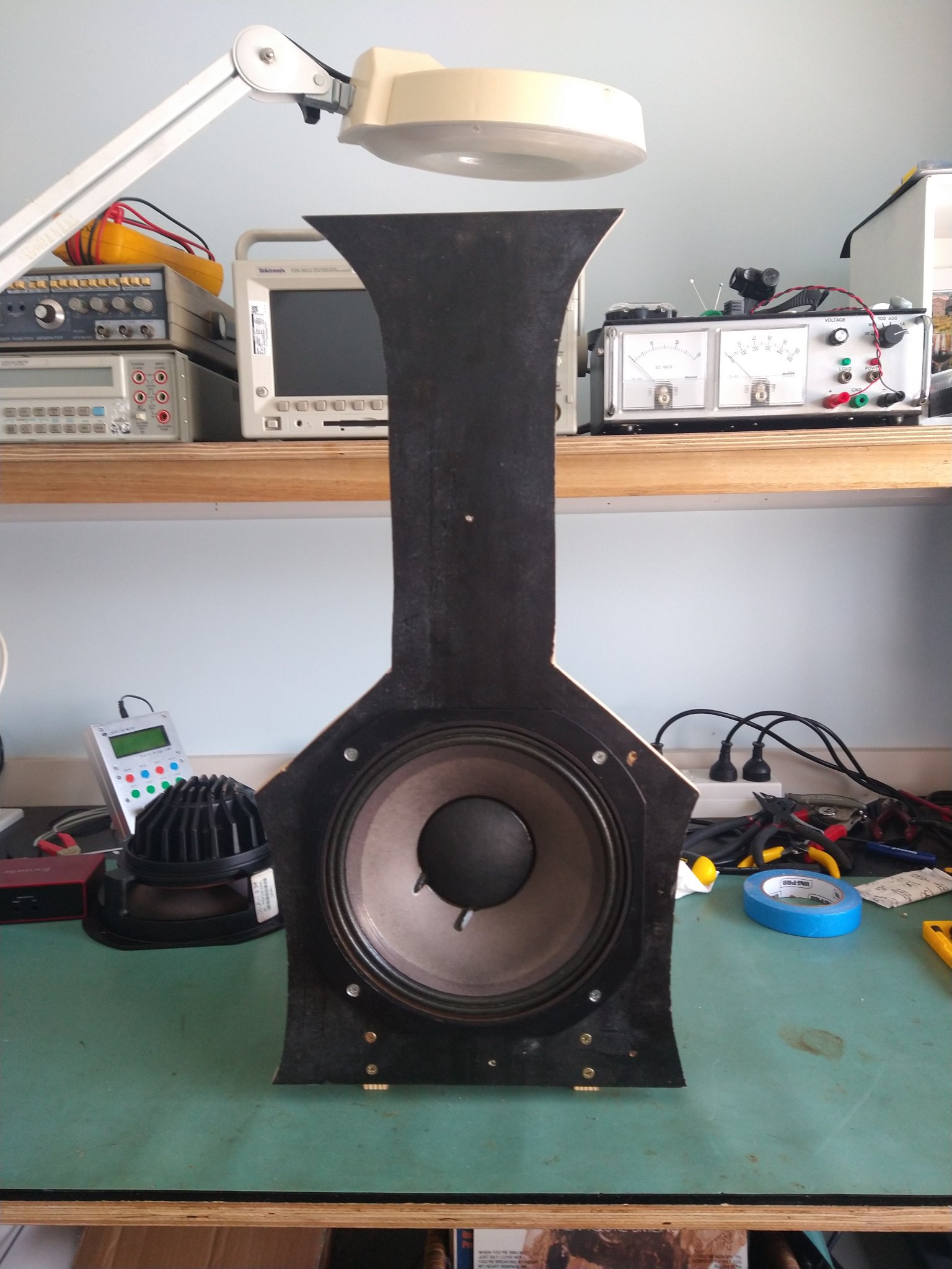

A friend of mine rebuilds JBL drivers and loaned me a set of JBL2251 10" mid woofers to try out in my new OB build. They measured extremely well in a small baffle.
I tried very hard for them to NOT look like LX521's but this baffle measures best. No other baffle shape came close to smooth on and off axis response of this one, oh well I'm after performance and if they resemble the LX521 so be it. I have a pair of LXmini+2 that I will be using the subwoofers for this build.
The baffle is just a temporary mock up to test driver response, once I have the baffle shape locked down then we'll make a nice wood one.
The set up will be 10" Seas L26ROY subwoofer, 10" JBL 2251 mid/woofer, NEO8 and NEO3.

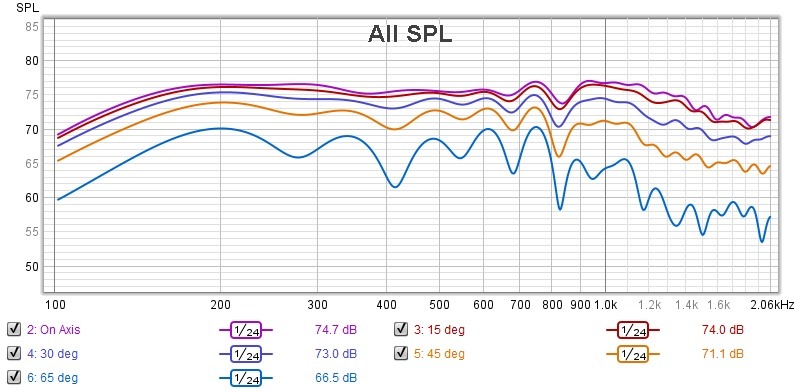

The measurements were done in the shed 1.4m off the ground with a mic distance of 1.4m so I could get the wide gating. Treatment was also added to the floor to reduce reflections.
