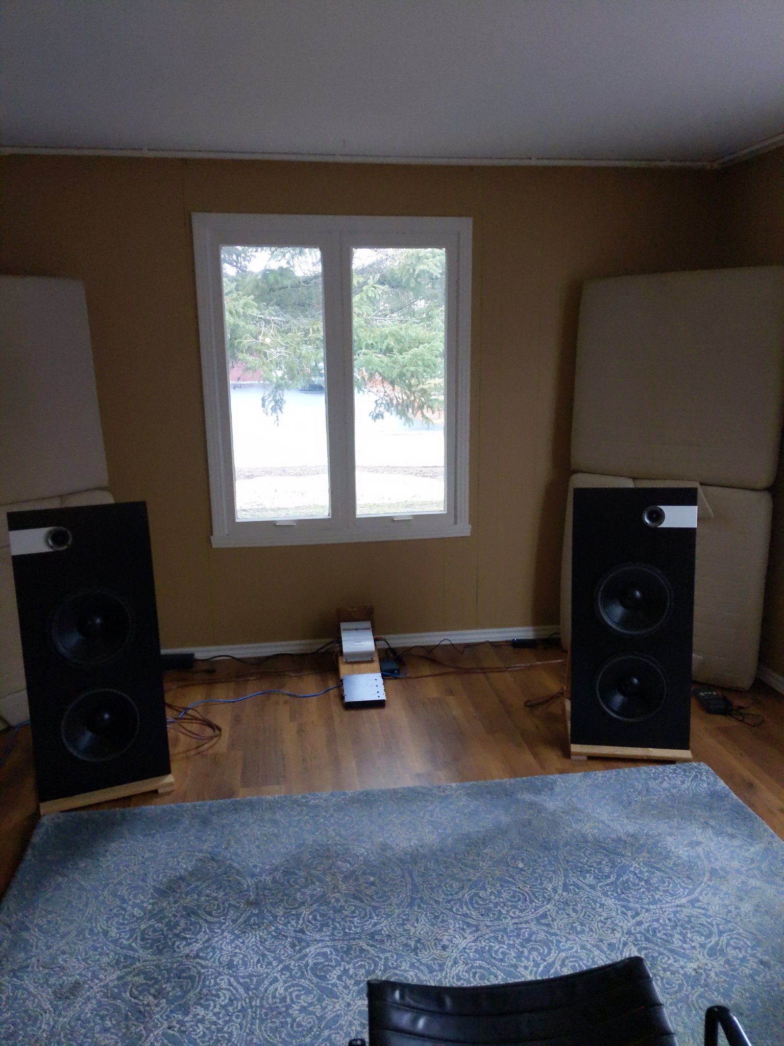

Thanks, those are a set of Roche Bobois modular sofa chairs. I'm sure there is some collector out there that would be very upset with me for using them like this. I have repositioned them for better corner coverage.love the chairs as room treatments behind them!
I also have the speakers bi-amped now and I'm thoroughly impressed with the performance from $350 CDN worth of parts. I will say that the manufacturer's published specs is the biggest issue with inexpensive parts. The efficiency of the woofer was certainly not as published.

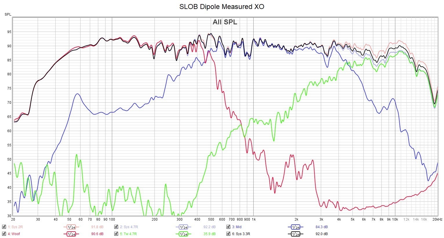

For the SLOB Dipole, here is the measured crossover response. I tried several levels of padding resistors on the tweeter (2ohms, 3.3ohms, 4.7ohms) and found the midpoint 3.3ohms gave the best overall voicing.

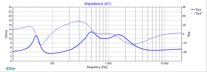

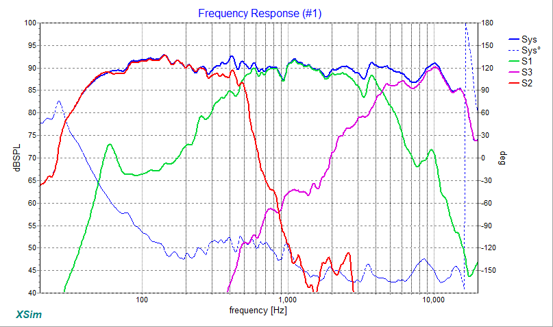

Predicted impedance variation:

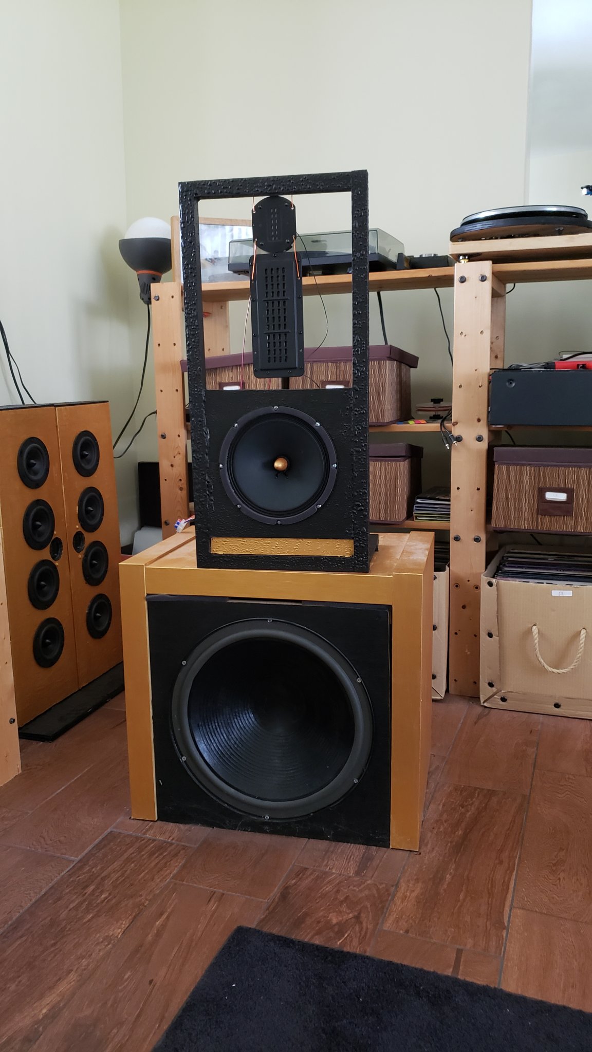

How would you describe the midbass, thinking up to 400Hz, vs a 15" OB on a small baffle? I was under the impression SLOB didn't do so well above 200Hz or so. But your speaker suggests otherwise.
The mid bass from the slob is terrific. Great “chest punch” as there are 4 directional ports that are front firing and equivalent of an 18in+ woofer on a 30in wide baffle.
Through careful design of the SLOB chamber dimensions in Akabak I saw that by minimizing driver diameter (6.5in vs 8in or larger) and minimizing internal volume (magnet in on one) the upper reach is extended to about 500Hz. Using this natural slot loaded band pass effect plus 2nd order electrical filter, we can get steep 4th order falloff to get rid of high frequency noise.
I have heard a dual 12in narrow width OB and this SLOB has bass that sounds much deeper in extension below 60Hz.

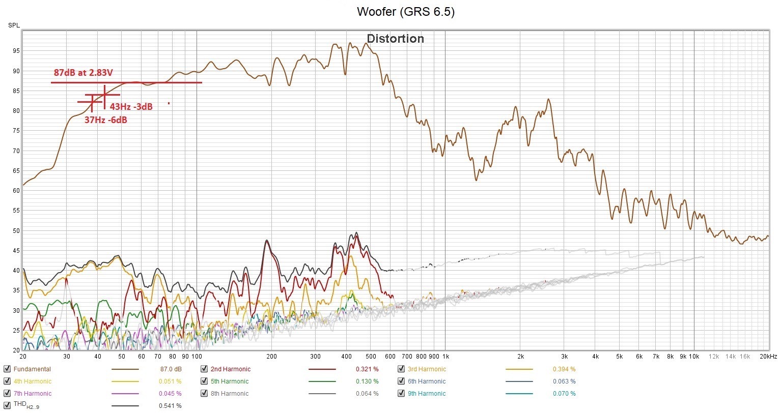

Here is raw measurement (no filters):
A ripole is slot loading but a narrow baffle on the slot. It won’t go as low as U baffle slot loaded.

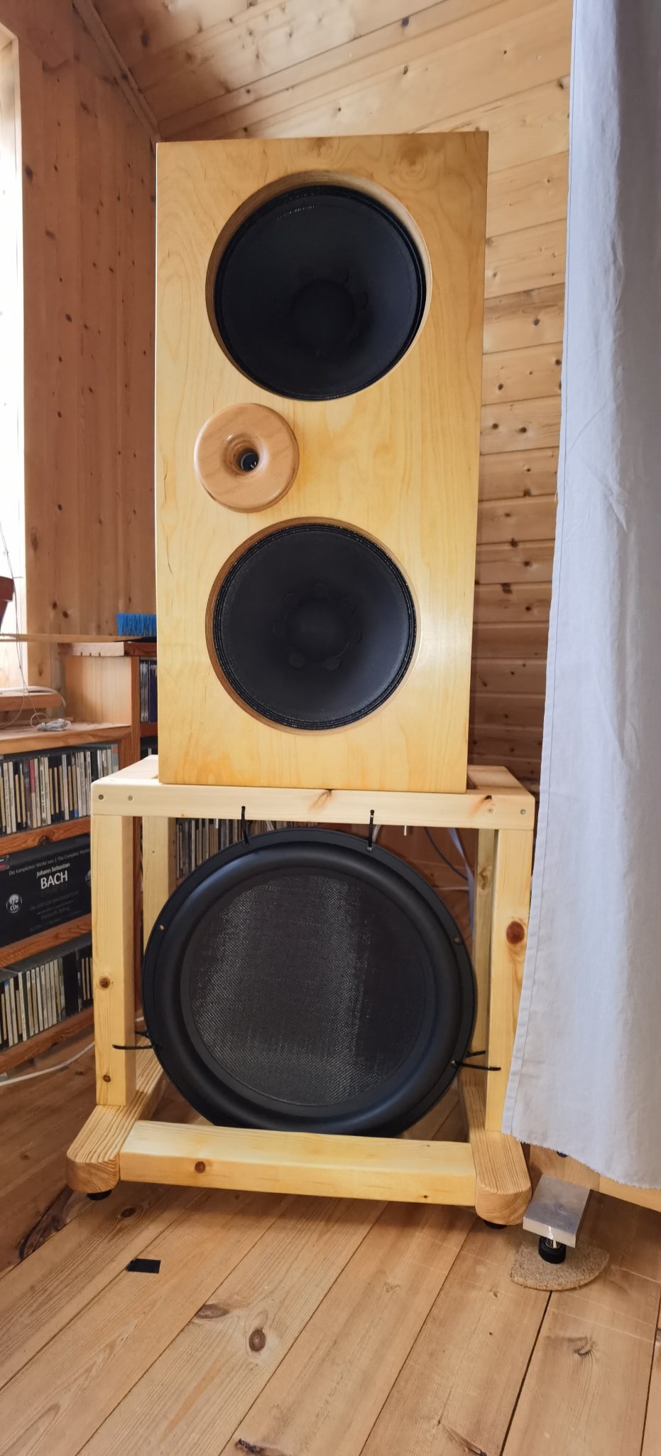

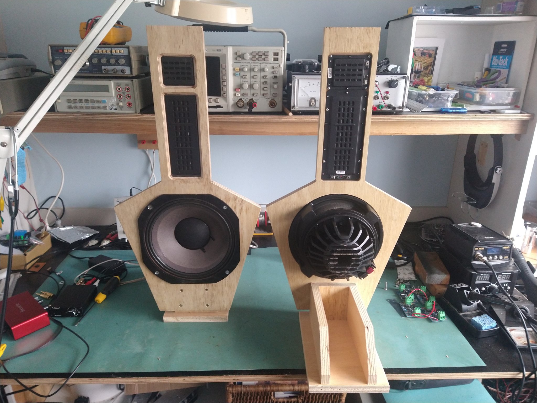

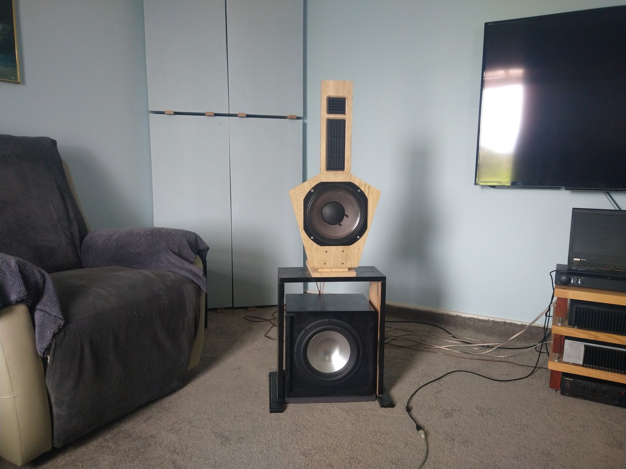

Thought I'd post an update on my build. I haven't finalised the EQ as my Focusrite failed and I'm waiting for the warranty claim to proceed.
The bridges are temporary cut down from an older project, the new bridges will be Tasmainian Oak. I'm pretty happy with the results so far, the speakers disappear in the room and sound almost the same no matter where you sit, the stereo image does not collapse into the speaker. No measurements due the failed Focusrite, currently using a very similar EQ/XO to the previous post.
Nice work warrjon! A modern planar take on the Orion! Interesting idea to use the smaller planar sideways - is that to give better up down dispersion?
Thanks......... The planar tweeter measures better turned on its side, both vertical and horizontal dispersion are better, especially because the XO is 7kHz from NEO8 to NEO3. I can't take the credit for this idea it was another DIYer that did this first, it works.
I tried very hard to not use Linkwitz LX521 style baffle but again it works well for the off axis response of the lower and upper midrange drivers. I also tried many iterations of top (NEO8 & 3) baffles with different shapes and this minimal baffle works well. When I get the new Focusrite I'll keep trying different top baffle profiles to see if I can smooth the off axis response better than it is.
One top baffle that is interesting used wings up top to separate front and rear tweeter waves, it has promise and I'll refine it. Unfortunately my Focusrite died while I was testing this baffle so it remains incomplete.
