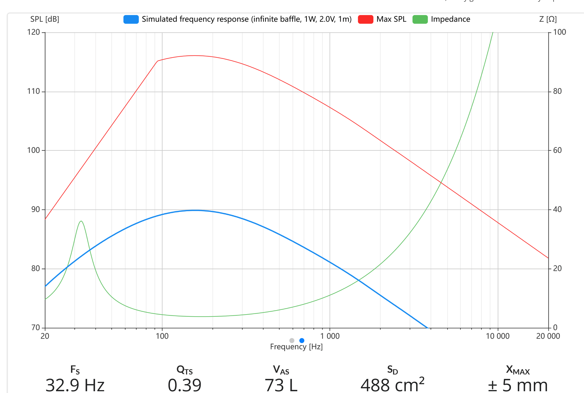

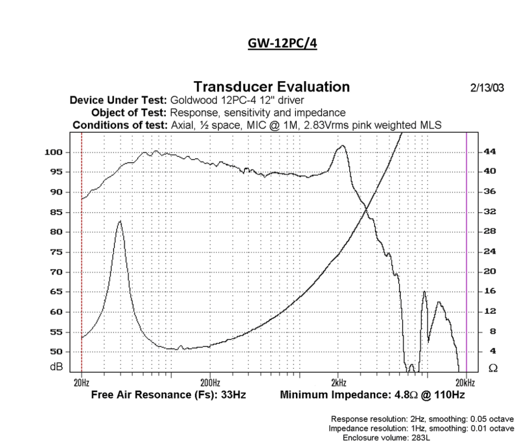

I'm wondering how Goldwood says Fs is 33Hz, but impedance peak is firmly at 40Hz...

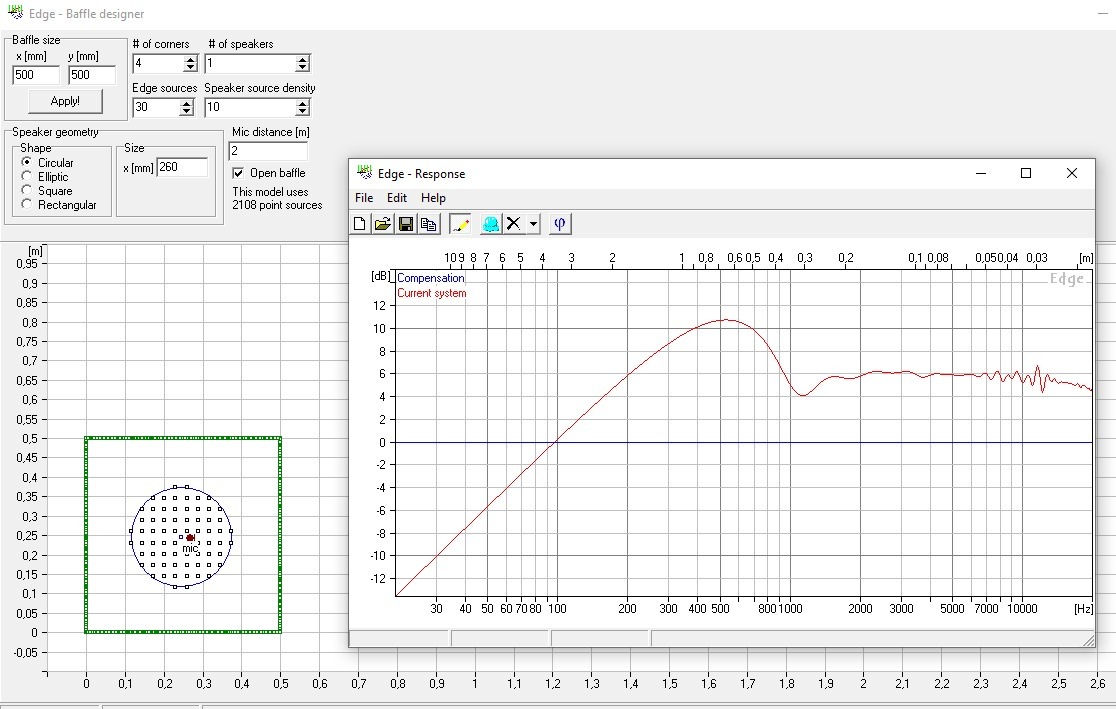

Half space means infinite baffle, no baffle loss in the measurement. So, looks like Goldwood might give nice response in OB without EQ, but it's Xmax is quite low 5mm. High distortion to be expected below 100Hz in OB.

So this would imply that PAP style open baffle will have an odd/skewed soundstage. So what open baffle projects are they on here which are 4 way, variable baffle and passive crossover?You guys are now thinking about only on-axis response. The challenge with OB/dipoles is to maintain similar polar response 0-360 deg and throughtout the spectrum ((or as far low as the designer wants).
Eg. U-baffle works only for narrow range, like any fixed baffle width. This is why a dipole speaker will preferably be 4-way with variable baffle dimensions.

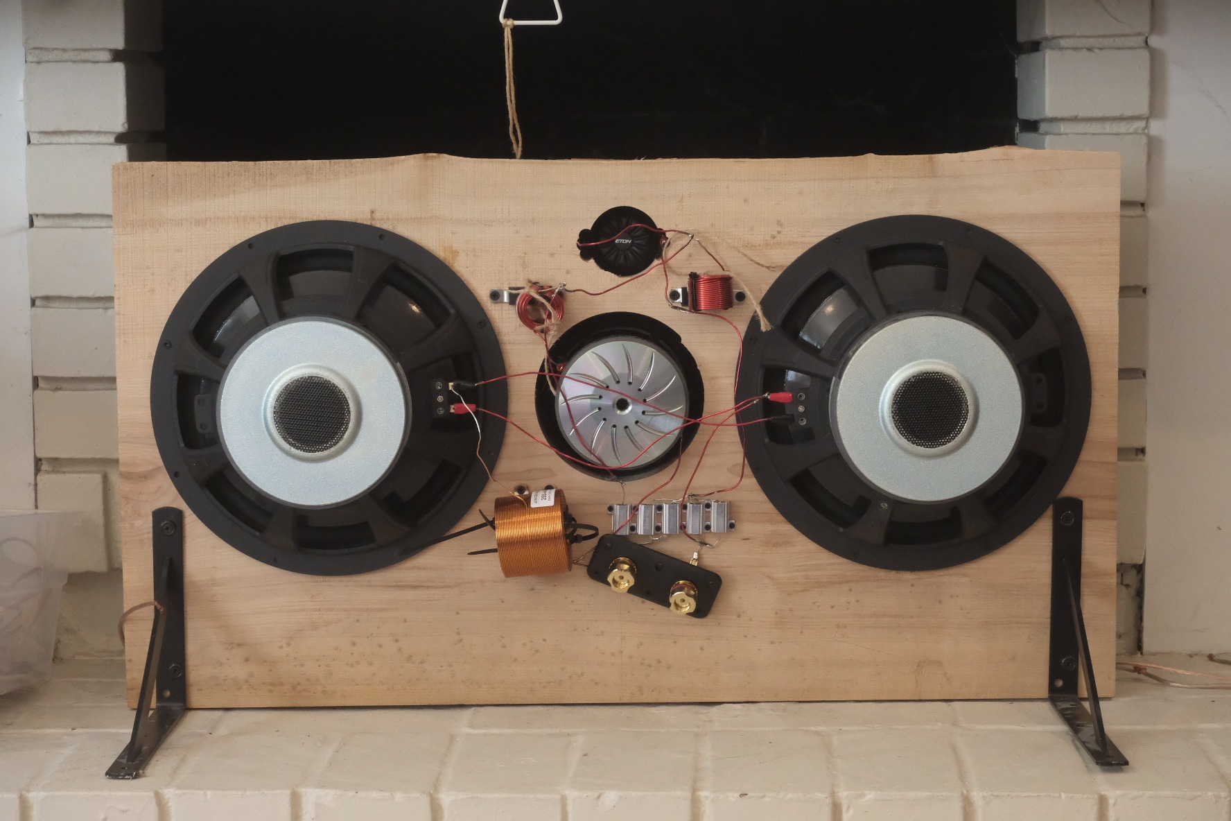

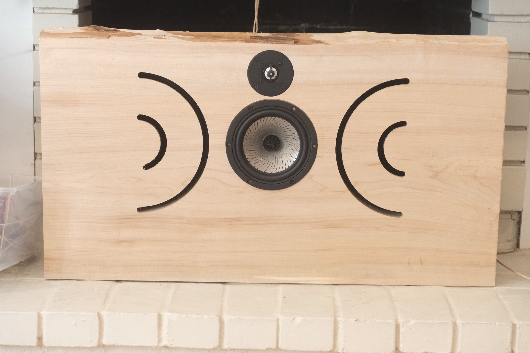

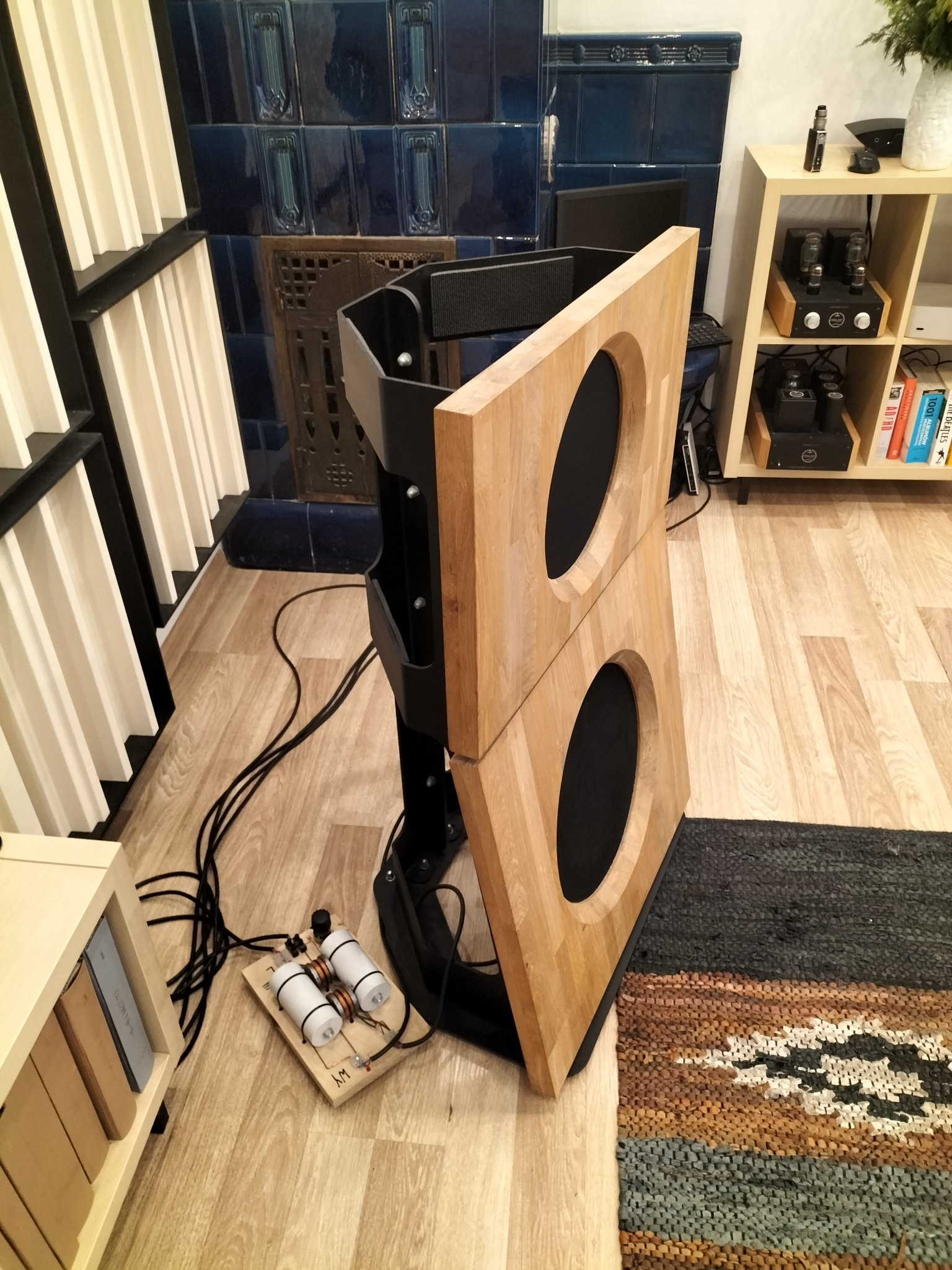

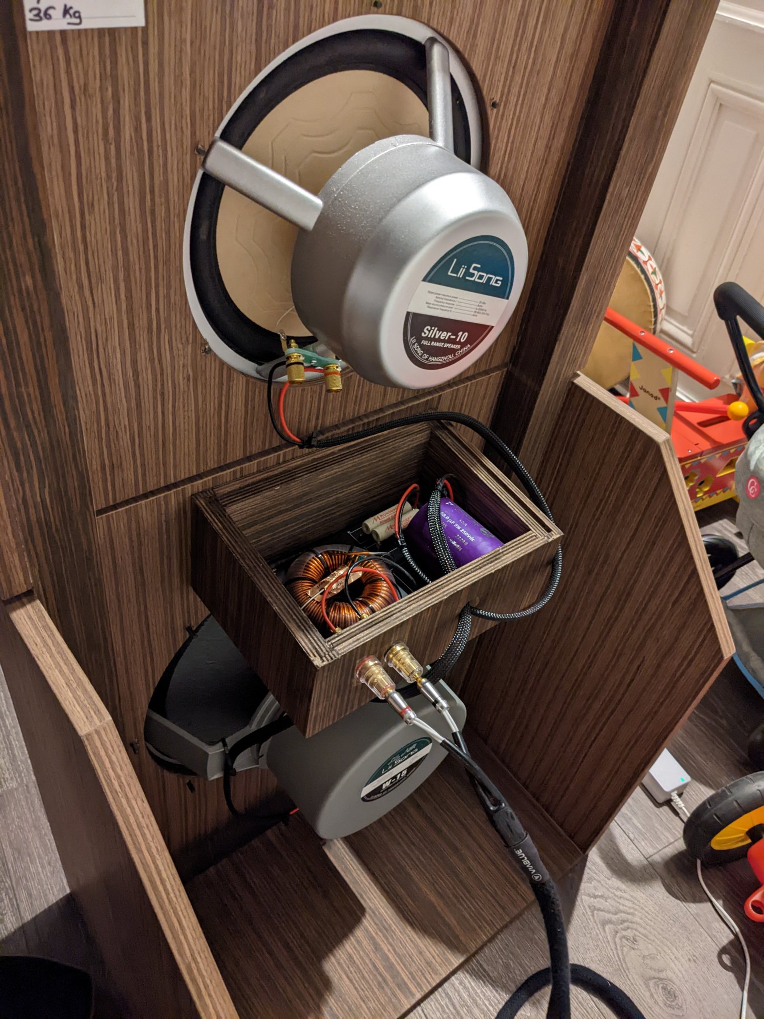

Thought I’d share the center channel I’m working on to match my live-edge open baffle mains and subwoofers.
At BAF I saw the speaker camp SLOB and decided to do my own take on a slot-loaded open baffle.
I still need to sand and finish it, but I didn’t want to wait to hear it. I’m happy with the sound.

Those slots are interesting, but look incredibly small. Do you have any measurements for the woofers themselves? in open air, in baffle, with xover?Thought I’d share the center channel I’m working on to match my live-edge open baffle mains and subwoofers.

really nice ! isn't the woofer slot load too small ? maybe 1/3 of sdThought I’d share the center channel I’m working on to match my live-edge open baffle mains and subwoofers.

Yes, I was worried the slots were too small but it sounds ok. Maybe I’ll try to widen them but I’ not sure of the best way to do that. I don’t have a good measurement setup at the moment… I tried taking measurements of my other speakers with an uncalibrated AT2020, but the measurements looked suspect (they said bass was down something like 40dB at 30hz when I could clearly hear it during sweeps). I should just get a umic.really nice ! isn't the woofer slot load too small ? maybe 1/3 of sd
I’m curious, theoretically, what is the problem with slots that are too small? Why is 1/3sd the best choice vs other ratios?
maybe all start with Pa article https://www.firstwatt.com/pdf/art_slob.pdf there is a lot of chat on forum...Yes, I was worried the slots were too small but it sounds ok. Maybe I’ll try to widen them but I’ not sure of the best way to do that. I don’t have a good measurement setup at the moment… I tried taking measurements of my other speakers with an uncalibrated AT2020, but the measurements looked suspect (they said bass was down something like 40dB at 30hz when I could clearly hear it during sweeps). I should just get a umic.

It would be interesting to hear these. I wonder if their performance has something to do with the "velocity squared" that Nelson described,
"The motional energy imparted to the moving air is proportional to the mass of the air times the velocity squared. The “squared” part means that if you triple the velocity you impart nine times as much energy, or about 9 dB worth. This raises the efficiency of the speaker quite abit, and it improves the transient response as the apparent mass of the air moved is higher inrelation to the cone mass of the drivers."
"The way this is accomplished is by “squeezing” the air through an opening narrower than the
surface of the moving diaphragm of the driver. In the diagram above, the air pushed by the
cones has to exit out the front of the loudspeaker through a slot opening whose surface area
is only about one third that of the cone drivers, and so it goes out about three times faster
than the velocity of the cones."
