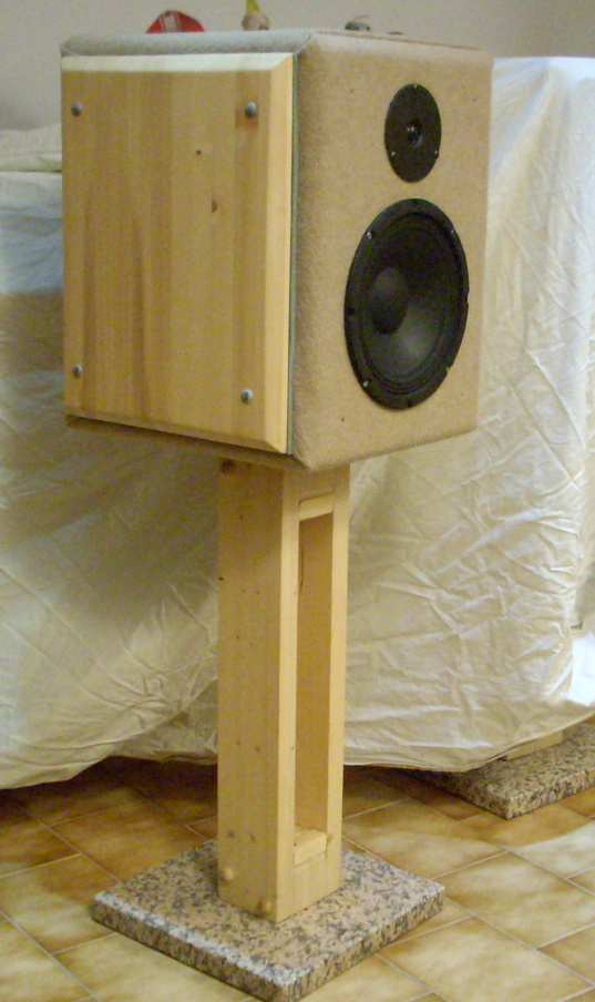

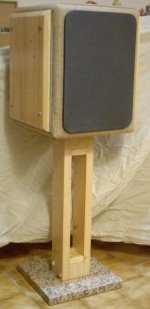

Two way
This is my first 2way speaker based on an old paper made
by Patrick j.Snyder paper no.1307
Is a work around a low cost 20cm diameter pa woofer
and a tweeter vifa
The cross over is based on ALLEN.B guide (many thanks
and a tweeter vifa
It seems to be a vented box. So maybe this thread would suit better: http://www.diyaudio.com/forums/multi-way/23208-system-pictures-description.html
He means: Is this an Open Baffle speaker?
Since it is the Ultimate OB Gallery.
I know what he means. I'm also wondering why it was posted here.
Sorry i have posted my bass reflex on wrong thread![]()

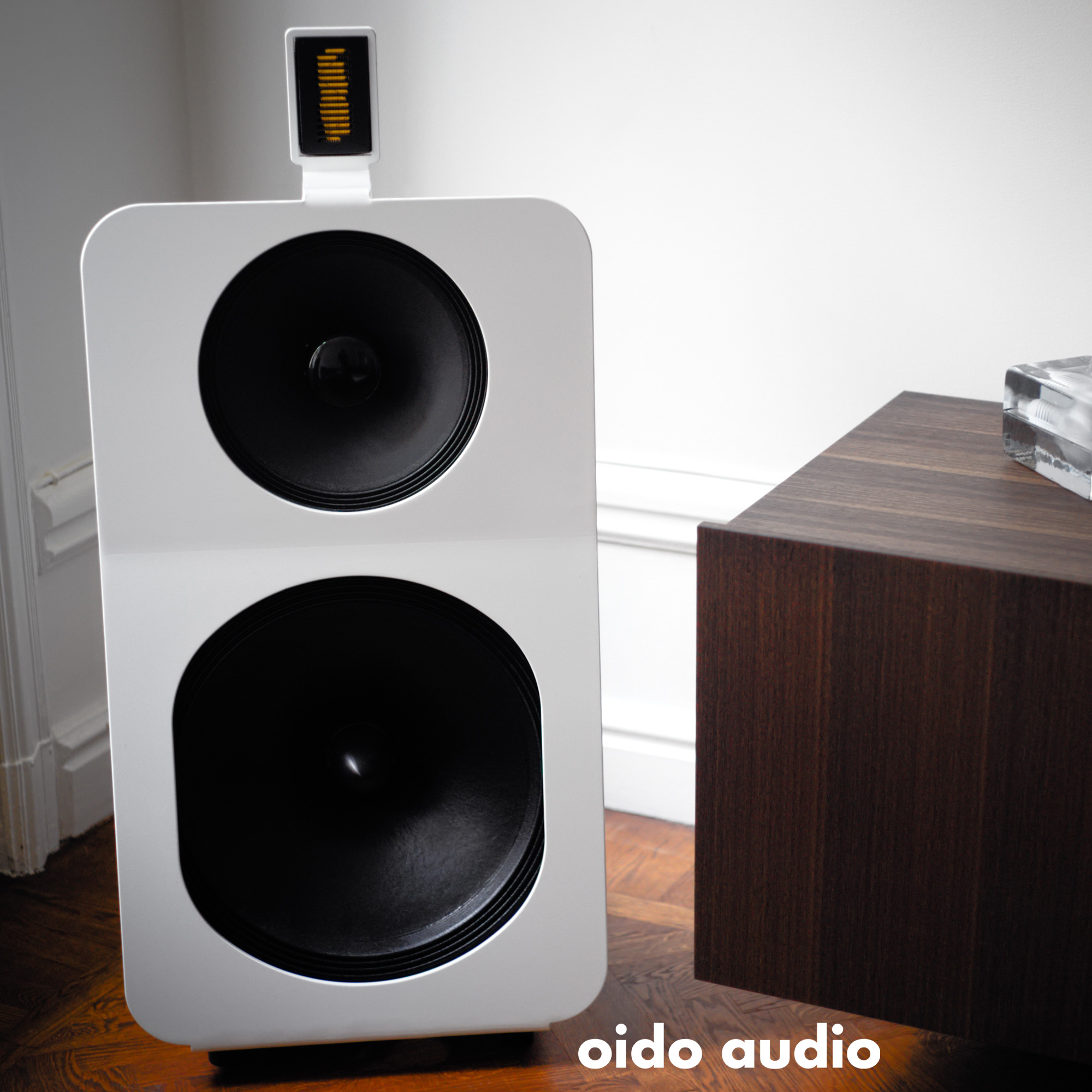

Hi! I thought I would share a couple of pics and a bit of info about a new open baffle speaker model that was launched recently by my very fresh company oido audio:
The drivers are AE dipole 18 bass, EMS LB12EX field coil full range and Mundorf AMT dipole tweeter.
I guess the major selling point with these speakers, besides the general advantages with open baffle, is the small (in open baffle terms) size of the baffle combined with large surface area drivers. This gives you a very "sudden impact" of sound from transients in the whole sound spectrum, which I think is a great thing, from a speaker that is not huge.
The full range driver is used as a wide range, between 150 and 10 000 Hz, resulting in a very natural, relaxed and stable reproduction of the human voice and acoustical instruments, while sparing it the duty of bass and ultimate treble extension.
Wow, very nice!!!
Any info on pricing?
20k-ish. USD
...big chunk of money
Not so familiar with the ATM. Does this yellow thing inside need to be yellow? White color would match the speakers much better.
Congratulations, I think that is the best looking speaker I have ever seen. Proud of being Swedish!
Thank you very much Pepe! Although looks are not everything, especially in our field, I have tried really hard to simplify and refine the overall design.
You are absolutely right! I must admit I never thought of it, but that would definitely look better.
