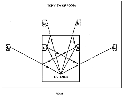

I want to clear up a misunderstanding - Beveridge placement does not rely on the reflections from room boundaries as a primary source of sound for the listener
here goes the scheme of it (reposting picture already posted few posts before by Markus):
the contralateral side wall reflections, front wall and back wall - all can be quite easily delayed by as much as 6 ms in a moderately sized room, and even beyond 10 ms in a bit bigger
use line source or a flooder and You get rid also of the floor and ceiling reflections (in case of a flooder the ceiling reflection can be delayed as much as 9-10 ms, depending on room and ear height)
Hello Graaf
Looking at that diagram I couldn't help but look at those speakers as rears in an HT set-up. A spacious and diffuse soundfield with poor localization.
Rob🙂
well, then it seems that You clearly can't read/understand that diagram
try to google for Beveridge "best imaging" and so on to find out about "spacious and diffuse soundfield with poor localization" 🙄
