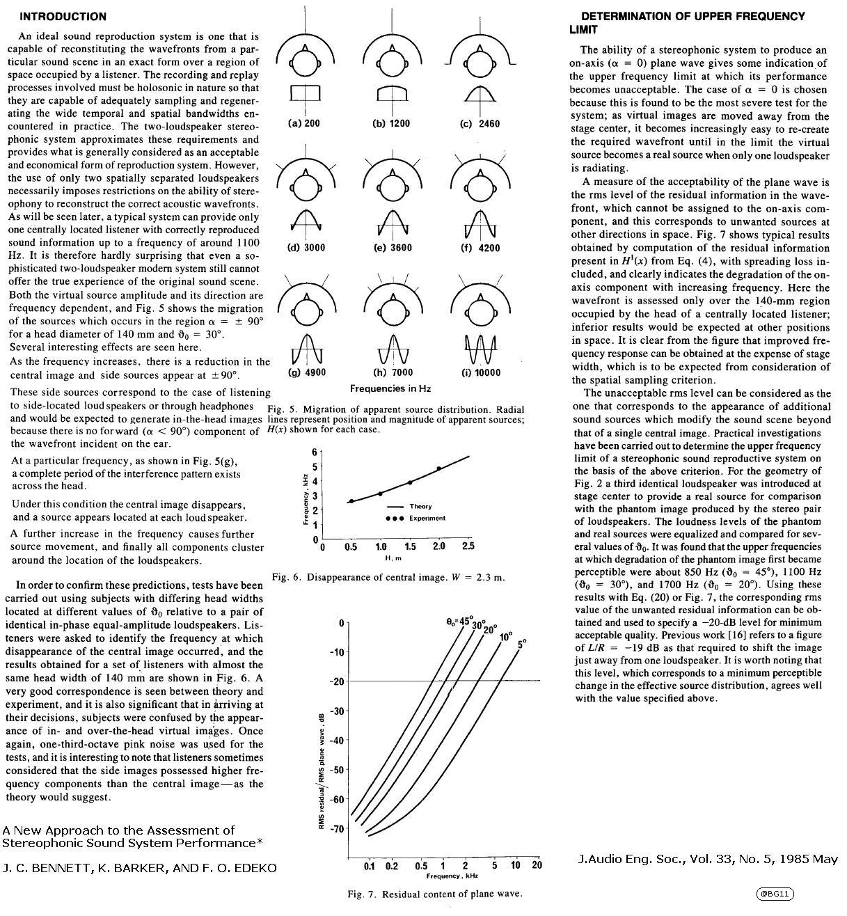

My understanding is that above about 6kHZ we hear treble in a diffuse way no matter how directional a tweeter tries to be. The imaging criteria graph suggests that in the range of 2kHZ - 6kHZ, anything that delivers to the listener an amplitude response that is consistent over that range of frequency, would do the most for stereo effect. Since most cymbals have highest acoustic output on the up down axis, there may be some psycho-acoustic effect with that. Perhaps having high treble bounced off the ceiling can be a good thing. Below 6kHZ, I'm not as sure about.

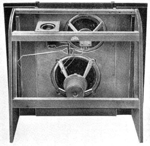

The up firing tweeter has known success in the past.
Yes, Warfedale was, as I understand, a mono speaker ?
It would be interesting to know who invented direct firing treble, and when it bacame a norm

..My understanding is that above about 6kHZ we hear treble in a diffuse way no matter how directional a tweeter tries to be. ...
Hi, Agree, I think this fact is often overlooked when discussing higher frequencies are forming 'phantom spreading' from a set of speakers.
FYI: A cut and paste picture considering this matter:
b
