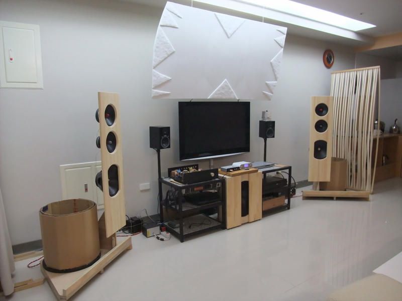

I may give an example from personal experience:
My Dipol 08 line array is a fairly directional speaker, while my fullrange bending wave
'Model 2' is close to omni at HF, which are nearly the two ends of the scale.
When i finished the line array and people came in, some of them intuitively walked
some meters backwards and said something like "nice, can it go even louder ?"
The speaker is well balanced and homogeneous at closer distance too, but i think the
reason for that reaction was the listener trying to get "his" preferred direct/reflected
ratio, which is found at a larger than usual distance with a noteably directional speaker.
I did not observe that kind of reaction with the more omni like speaker. Listeners walk
around checking "uniformity" of reproduction at several places, but usually are
statisfied to get back to the closer listening seat for listening more concentrated.

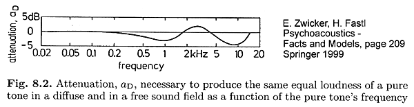

From
Moulton Laboratories :: The loudspeaker as musical instrument
page 9:
"First, all traditional instruments generate complex waveforms with extensive overtone structures. As a
general rule, the frequency range for the fundamental frequencies of musical notes spans four octaves, from
65 to 1040 Hz. (low C to high C), while overtones extend up to five octaves above that range.
Loudspeakers, on the other hand, do not generate overtones as such, except when driven into distortion.
Second, the directivity of acoustical instruments varies widely at both high and low frequencies. There is
no uniformity, and no particular trend. In a collective sense, we can generalize that high frequencies are
radiated laterally and upward, occasionally forward, while low frequency radiation tends to be either
bidirectional or somewhat directional as a function of horn coupling with free space. It needs also to be
noted that the timbral results of such directivity is also affected by the comparatively large size of
performance venues – the strident harshness of a violin in a small practice room, with extremely strong
high frequency early reflections off a low ceiling is in marked contrast to the warmth of the same
instrument in a concert hall, with the attenuated vertical high frequency radiation lending a silky
reverberant patina to the sound.
In contrast, traditional loudspeakers have a comparatively distinctive pattern of directivity, as noted above,
a pattern generally unlike almost all acoustical instruments. While low and mid frequencies are radiated
approximately omnidirectionally, high frequencies are beamed narrowly, so narrowly that for the most part
a listener cannot sit more than 15° off-axis and still perceive the spectrum the designer intended. The
result of this is a particular interaction with rooms that sounds quite unlike other instruments.
It is therefore quite important to note that no other instrument requires such a precise orientation by the
listener as does the loudspeaker, simply in order to take in the spectral range of the loudspeaker. Also, as
noted earlier, the volley of early reflections are spectrally deficient vis-à-vis the on-axis radiation. This has
led to compensations, in many instances, during the act of recording and production. By tradition, many
recordings are overly bright to fill in for this spectral deficiency and to compensate for off-axis listening."

Talk about 'unscientific', and back to the 'unconventional' of the topic, here is what I'm playing.
Based on this: http://www.diyaudio.com/forums/mult...-sound-single-loudspeaker-24.html#post2826324
And assisted by 2 narrow OBs on both sides for clearer lateral infomation by the narrow dispersion. The OBs are operating in the range of 300~10kHz or so. Above that, a pair of flooder tweeters take over (not shown in the pic, they're at the feet of OBs, up-firing).
The central DML panel is still running by the linear matrix 3-ch connection with x=0.5 and a shelfing filter on the unit at center.
Generally, this combination retains solid central image, depth, wide and natural stage, and a very large listening area. Tonal quality and images are very consistent in the room. I'm happy with the result so far.
ps. the little monitors on both sides of TV are not in the main system

Of course deviations vary, depending on that individual concept and deviations are usually restricted
to certain frequency bands (the "beaming tweeter" e.g. is a very common de facto standard at least ..)
In general I believe meanwhile that very much can be drawn from the picture attached, although it has to be enjoyed with a pinch of salt
This is a very valuable hint i feel, because "redistributing" a radiation pattern over frequencies
(for the home and in a home speaker) and possibly making it noteably different to the "mastering tendency"
(maybe a better term than "norm"), will also need to take this into account (and also quite a lot more things ...).
An example: The directional band for "above" or "elevation detection" around 7..8Khz caused by the pinna's
filter characteristics, is to be taken into account if a speaker (the tweeter) has "different than usual"
elevation angle.
It also explains e.g. why beaming tweeters let's say above 5KHz are not a real issue.
To me maybe explaining why it might be "less an issue than it could even be" but that seems a point where
we diverge in our personal estimations ...

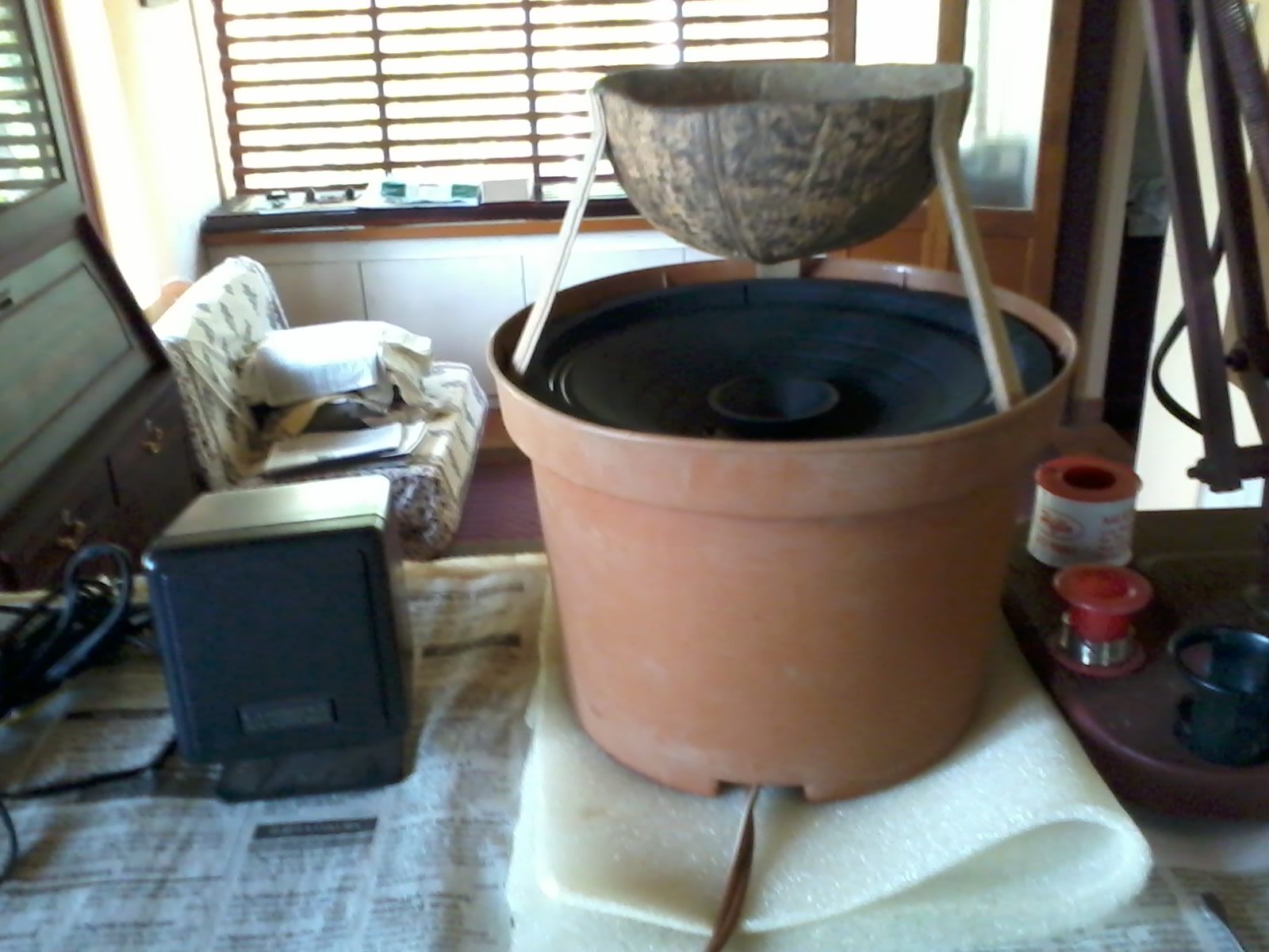

Here is the eco-friendly "nut-pot omni"-- a half hour job as the team was waiting!
You said: << "As there seems to be a tendency for most listeners to prefer "wide" radiating speakers..."
I don't have that impression, at least not in this forum. >>
In answer I would say, the average lay listener doesnot ask for a wide radiating speaker-- he doesnt know what that is. Rather, when he has a chance to hear one, be it an OB dipole or a better omni like your Demokrit, they prefer the sound of that. The truth is that we too prefer that, but we know it is an omni! Perhaps your own sound impressions as a boy offer the key to this reaction. Narrow beamers also image well, but in their narrow spot. The moment your head is free of the vice, the image washes out. Not so in the case of the omnis.

@2Pi:

But this is also in the picture somewhat ! Beyond the ~5KHz our hearing is more sensitive to the diffuse field/reflected sound. If you now build a speaker that keeps the power response up with wide dispersion or a dipole it will sound too bright in a room. So either leave the sound power to match the picture (a somewhat beaming tweeter) or tilt the on axis FR, which gives you a nicer perception of depth IMO.
Yes, and having a close to omni speaker will enforce a noteably
downtilted FR ("on axis" and "energy response" being quite the same)
for the 2 uppermost octaves.
The diffuse field loudness curve will furtherly enforce that tendency,
which is a very valuable hint.
That is an example for equalisation being needed due to using different
than "common" dispersion over frequencies.
