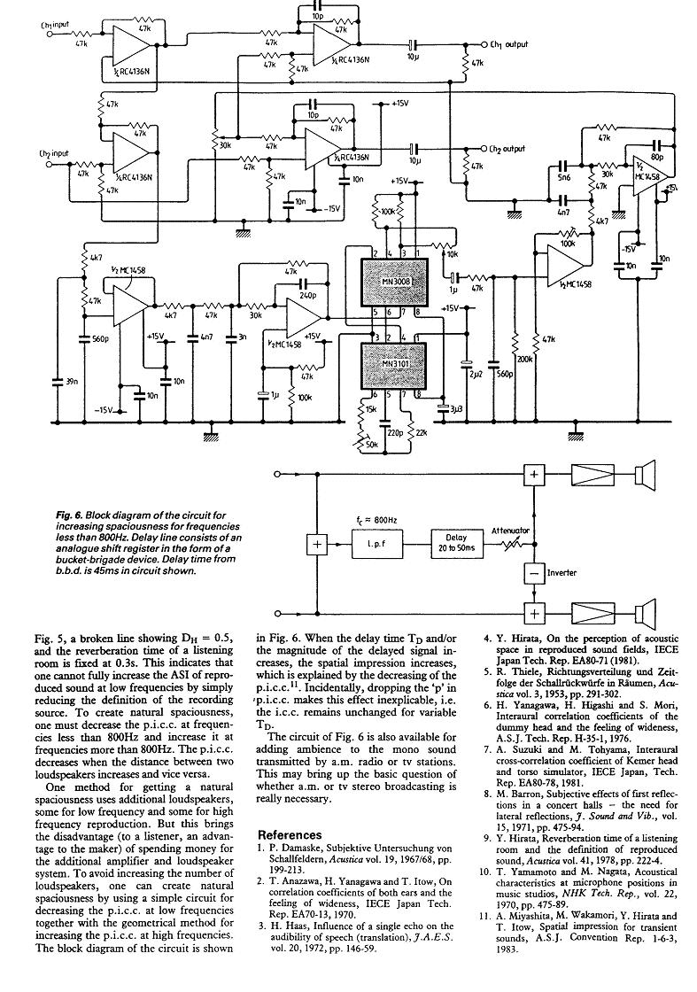

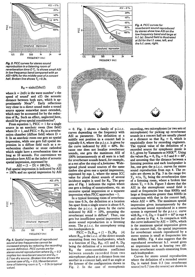

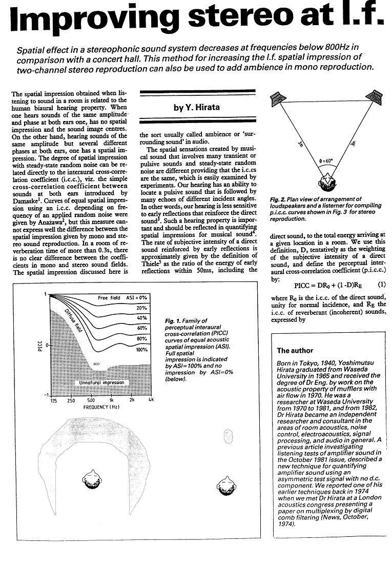

Hi, Adding more food for thoughts..Read the *Hirofumi/Yoshio and Takeshi paper + note the reference #9 that really got my attention in the mid 80:ties and ever since that time I've added similar circuits to my designed speaker systems(mono systems too) as shown in the Hirata publication for De-correlation purposes..
I.e.: One or two short frontal placed Bessel arrays with pink noise shaped FR from ~60-800Hz. in order to improve the reproduction live recorded Double-Bass like heard in Jan Johansson/Georg Riedel records that I'm grown up with (early-mid 60:ties).
http://www.acoust.rise.waseda.ac.jp/publications/happyou/jasje/jasje84-5-1988Nov.pdf
b🙂
