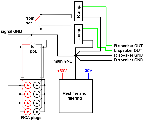

the lower diagram is correct, but the NFB lower leg also returns to the signal ground.davemar73 said:...................I've tried to scribble this in the diagram.
I now prefer to see the signal ground taken from the RCA barrel/ground tag to the main Audio Ground (Star Ground). This seems to be more resistant to inducing hum/buzz than all the other ways I have tried.

pacificblue said:The best (and correct) variant is to connect the shield on both ends. Leaving the shield disconnected at one end is a means to interrupt hum loops.
all four coax to/from the volume pot have the shield connected at just one end.avyrez said:i have this image
i the pot attached correctly to the gnd

My post answered post #105 and its attached schematic, not #108.
Post #108 is one example, where the poster must find the best compromise whether the advantages of shielding the signal wires are bigger than the disadvantages of increasing the capacity between signal wires and ground. Or maybe the increased capacity is also an advantage, because it could accidentally create a convenient RF-filter. There is too little and too imprecise data to decide that from a distance.
Although there is a small possibility that this schematic could lead to hum. If there is a star-point for signal return on the PCB (signal ground, IN- or whatever it is called there), the potentiometer's gound wire and the RCA's ground wire should go there individually and both be connected to that point.
From the feedback circuit's point of view it is also better to connect the speaker return to the PCB's ground. That entails however sufficiently big traces one the PCB for the current involved.
Regards
David
