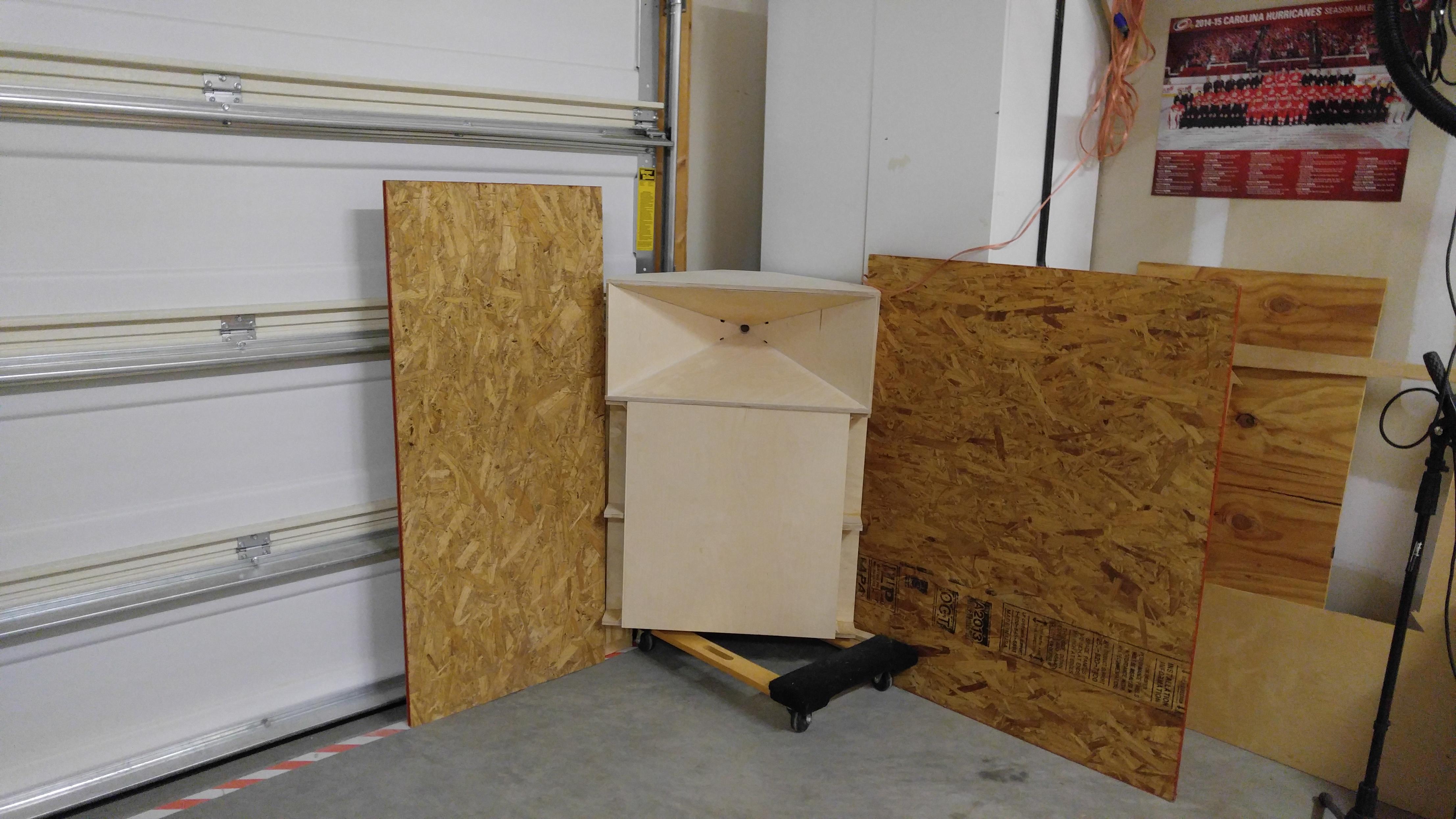

In the next day or so, I will *finally* publish an enclosure design for the speaker.
If you are reading this thread to *build* the speaker, you can skip this post, the plans for the enclosure will be coming up next. But if you're curious why I designed it the way I did, stay tuned...
I know this has taken for-ev-er, but it's been really challenging to come up with a speaker that satisfies the following requirements:
1) The whole reason I am doing this is to replace my Cosynes, and I want the new box to be much smaller
2) I am terrible at building boxes, so I needed a design that's relatively easy to build, and possibly can be built with a $40 jigsaw
3) I considered building a conventional two-way, with a 12" woofer. But by using a ring of 5" midbasses, I can control directivity on both the vertical and horizontal axis, and do it with more precision.
4) I want fairly high power handling, because my target SPL is 110dB (THX levels)
5) I'm a big fan of cornerhorns, and I want an enclosure shape that can be pushed *all* the way into a corner
So here's what I came up with (finally)
On the left is an open baffle based on the geometry proposed by Donald North, and used in his "DNA Sequence" speaker. The geometry is fairly similar to a D'Appolito MTM, but it works on both the horizontal *and* the vertical axis. My proposed loudspeaker is the enclosure on the right.
Here's the "real" DNA speaker.
Like a D'Appolito, the DNA geometry creates a narrow beam, reducing reflections off the ceiling, side walls and floor. From edge to edge, it measures 18.38", so I should be able to control directivity down to about 700Hz. This should go a little bit lower than the original Lambda Unity Horn.
Here's some pics of the original Lambda Unity Horn. It's attractive and relatively compact, it satisfies many of my five requirements. But it doesn't easily go into a corner, and it is much more expensive and difficult to build.
The box design that I am proposing is as small as possible, but no smaller. I literally had to tweak the width of the box in fractions of an inch to come up with this geometry.
One of the reasons that I had to avoid making the box too large is because these midbasses need about five liters of air to work nicely. So if I make the box too large, the power handling would suffer.
Anyways, this box design is the result of well over a month of discarded designs.

Yes, that is a very early picture of my system. There are prettier ones around but that shows the structure better. Notice how the vertical flares on my Synergy horn come out tight to the walls while the woofer cabinet is pulled out from the walls a bit to provide sound exit paths on the sides close to the walls, all in a successful attempt to eliminate boundary interference.
Darn this picture shows how difficult is to fine a free corner in a garage for experimentation. I'm having the same problem in the house in which I'm now living despite a much larger garage.
