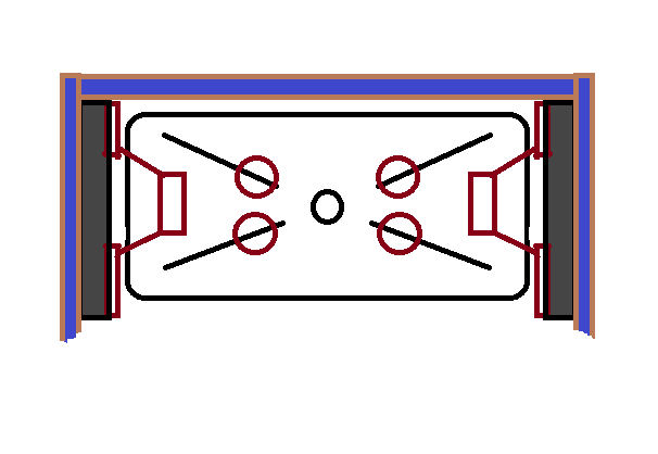

Have the woofers mount sideways inside the box on inner panels facing out, with their fronts fed out through paths like the way 'shelf ports' are done. That will result in more delay to the woofer outputs, but the wavelengths are long for those, so probably not a big deal. An nice thing with this arrangement would be that the cabinet width would be kept small (I like small!). And mounting the woofers would't be too hard, just do it through the waveguides' opening. I usually use just two woofers these days since that requires less cabinet volume, and I use subs for the lowest stuff anyway, but the same arrangement could be done with more woofers.
Just another idea that might be worth looking into.

Or just have the woofers fire out the sides of cabinet, through narrow slots with their centers closer to the baffle side. That would be an easier yet small cabinet.

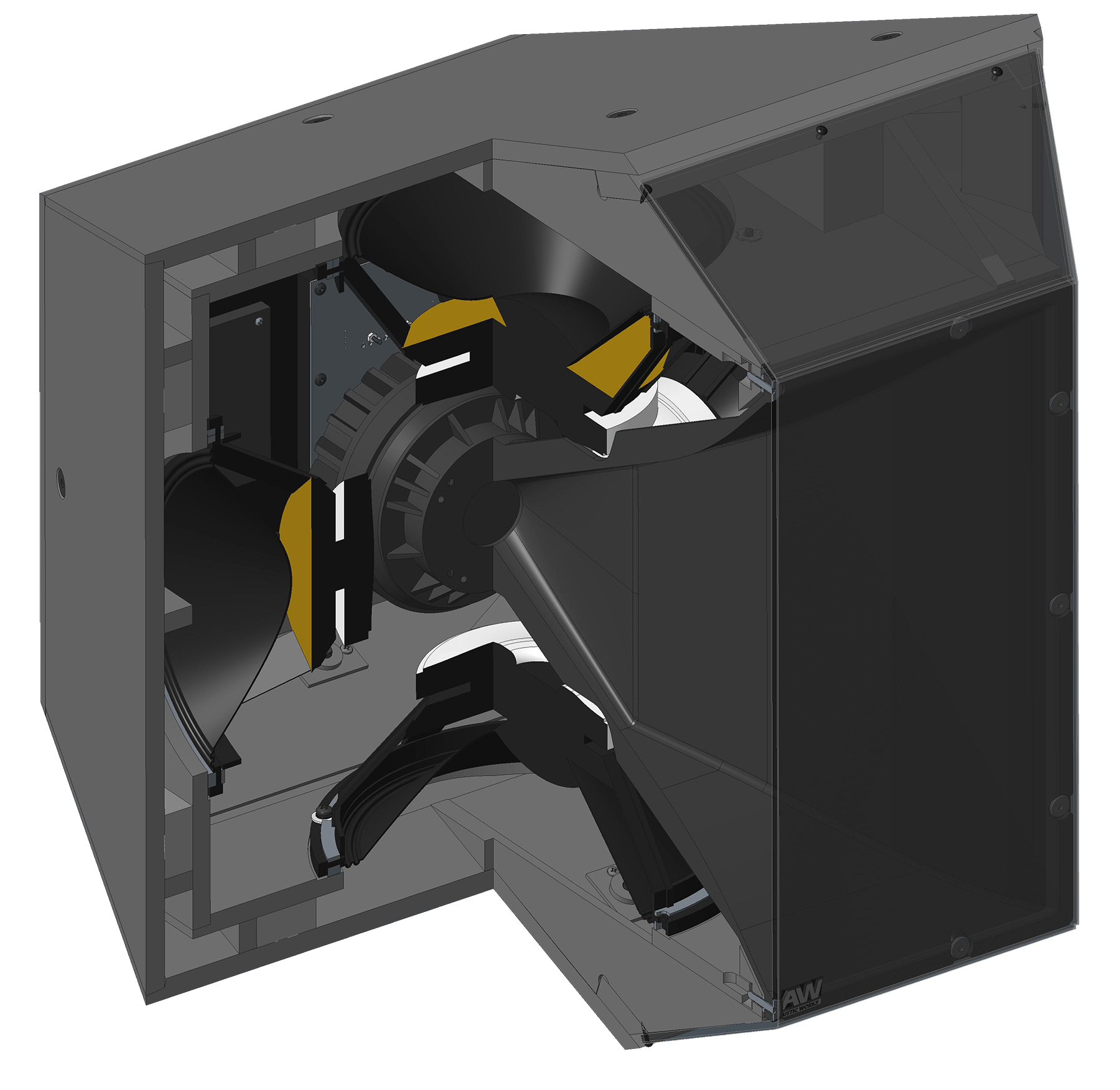

EAW QX series doing exactly that but with 4 woofers. "A centrally located co-axial MF/HF horn and two pairs (four) of phase-aligned neodymium 12-inch low frequency transducers team together to ensure that the entire frontal area contributes to horizontal and vertical pattern control capability.
Because the four low frequency transducers surround the high compression driver symmetrically in the horizontal and vertical planes, response across the full frequency spectrum appears to originate from a single point in space."

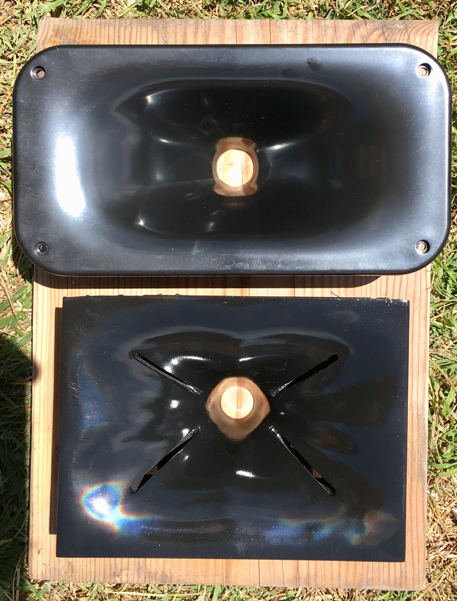

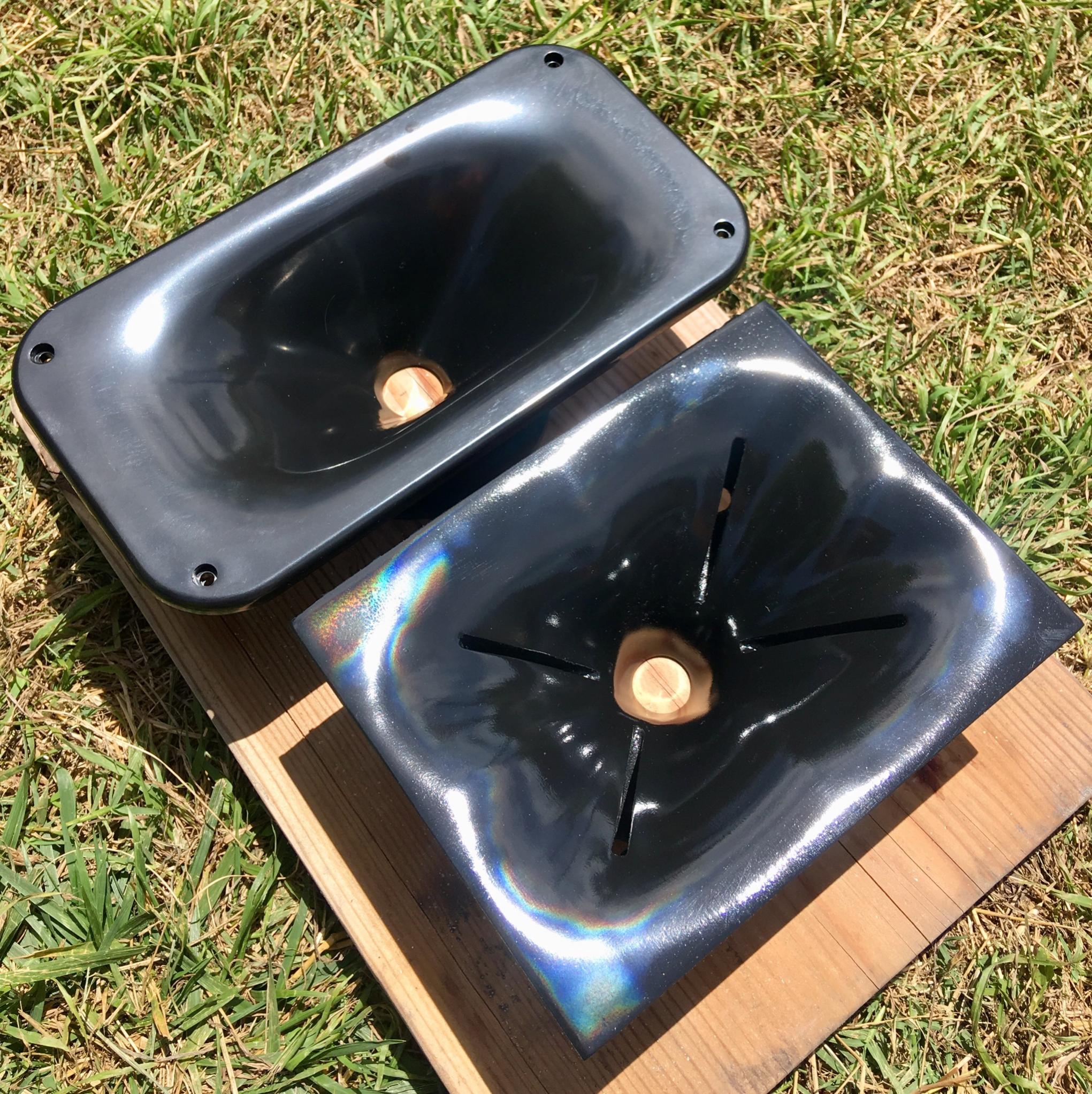

I have a SEOS-10 waveguide on hand so I thought I’d take a photo of John’s “unitized” image control waveguide next to the SEOS-10 for comparison. The SEOS waveguides have an extended taper that isn’t part of the flare, otherwise, these horns are comparable in terms of cutoff, John’s waveguide being a bit taller.
Thank you! It's interesting how similar they are.

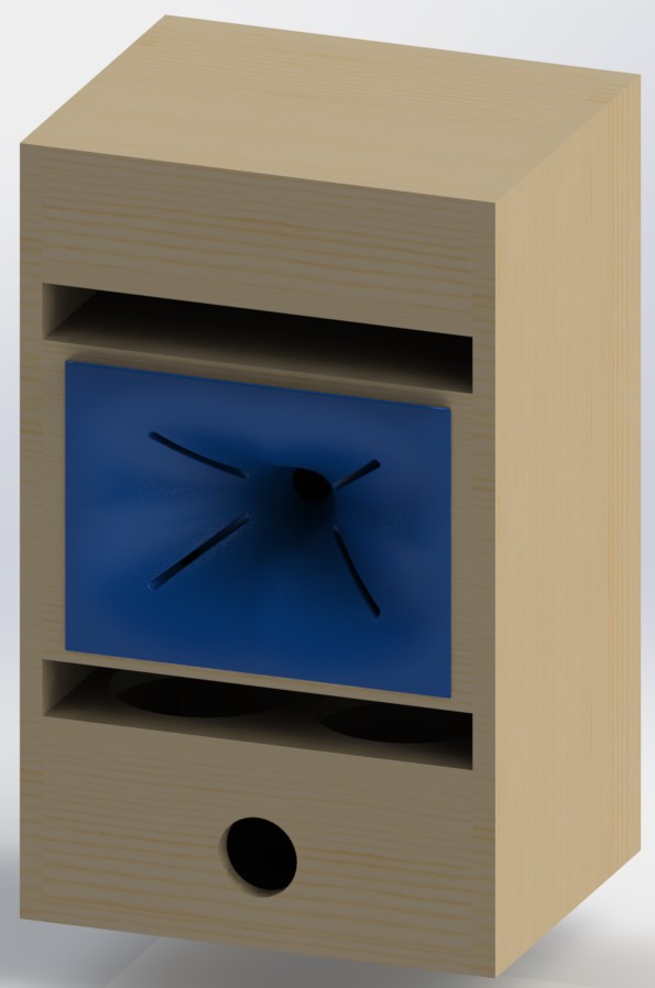

March 8th waveguide with 4xTCP115-4 woofers
I've played around with the crossover and ended up with a fairly simple biquad for the woofers and waveguide that works reasonably well. I'm not getting the lovely phase response I would like, but the setup is sounding very good to me.
I'm considering a proper enclosure for this system now and have come up with what you see below. I've tried to achieve better time alignment by moving the woofers closer to the waveguide via slots, like Bill's Cosyne. It's hard to see, but the woofers firing in to the top slot are mounted on the roof of the slot and the woofers firing in to the bottom slot are mounted on the floor of that slot.
Considering that the woofers will be delivering up to 1,500Hz, is there any issue with firing the woofers through slots? They are 1.25" tall, plenty wide, and two 4" woofers fire in to each slot. It seems that there will be all manner of reflections in the slot cavity and that doesn't seem to be a good thing at "higher" frequencies. Am I missing something?
Brian
Brian
