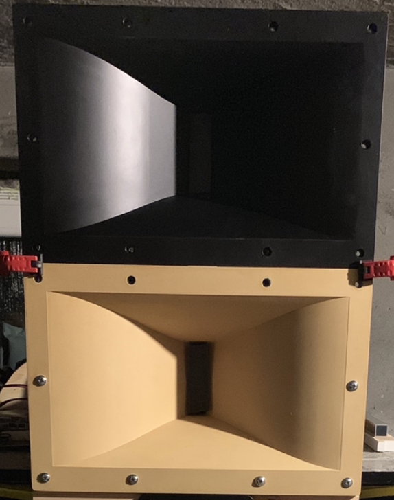

The painted waveguide looks great (the lower left part was messed up a bit, I sanded it and repainted later). I have the midranges at home, still waiting for the tweeters and crossover parts. I also need to find some nice screws to fix the midranges to the waveguide.
