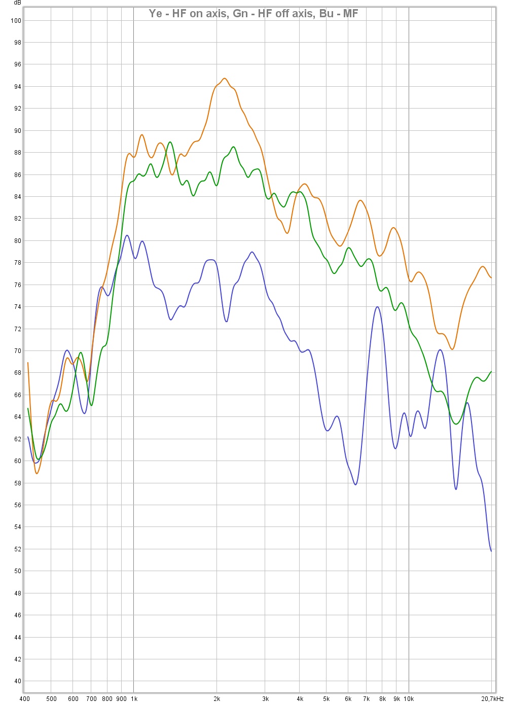

Yes, current crossover is on post 203.
Here is the response of your midranges and tweeter
![E8Bryh4.png](https://imgur.com/E8Bryh4.png)
Here is the response of my mid and tweeter
I think the issue may be that you're not using a baffle whatsoever?
If you look at my speaker and your speaker, the response shapes are fairly similar down to about 1500Hz, and then they diverge.
If you just want to listen immediately, you could cut a hole in a piece of plywood, and then mount the waveguide into the baffle using something that's temporary, such as hot melt glue from a glue gun.
If you want to go with something permanent, it's time to build a box!
Either option is going to improve the response quite a bit; if you measure the waveguide with no baffle, the response will be rough because it will be behaving as a dipole.
Off the top of my head, I believe I used a high pass around 350hz, give or take 100hz. I would need to re-read my own thread, but it's 3:07am and I should probably get some sleep

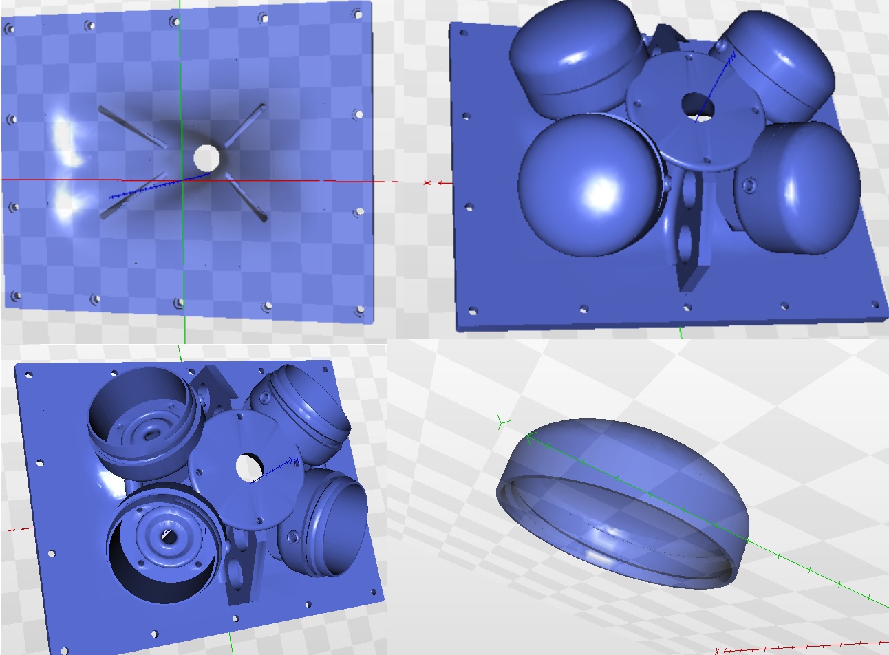

Hi Patrick, I have been following this thread closely for a while. I am interested in building your waveguide speaker. I am interested in using the TC6s so hacked your waveguide in Tinkercad to accommodate the TC6s and re-oriented it to print on it face. My plan is to develop a loudspeaker using your waveguide (and tc6 + sb19) with midbass firing through slots on either sides of it.
I'm posting the STLs of my hackjob on your file. I can modify the sealed chamber cap optimise the internal volume
I'm wondering if you will be kind enough to post the FRD & ZMA files of the Gentos, TC6s & SB19 so I can play around with the crossover, when you have some free time.

I measured the T/S of my TC6s, and my Gentos, and took some pics. And was going to make a big post about it, but I've been buried at work. (Literally at work right now.)
In a nutshell, what I found is that the TC6 will fit on the waveguide, just barely. You might have to use a file to take about a millimeter off the basket, or file down the mounting places on the waveguide itself.
The trickier part is that it looks like the Tymphany TC6 may need a back chamber.
Whether you opt to build one really depends on whether you're trying to get the efficiency up.
Basically the Gento has a very high FS and a very high QTS; it behaves almost as if it has a sealed back but it doesn't. The TC6 has a lower FS and a lower QTS.
If you put the TC6 in a small enclosure the FS will go up and the QTS will go up. You would have to measure the TC6 with a DATS to determine the optimum chamber size. Or you could simulate it for free in Hornresp.
Then again, you could use the TC6 and skip the back chamber entirely, but this would mean that the efficiency would go down around 1-3dB.

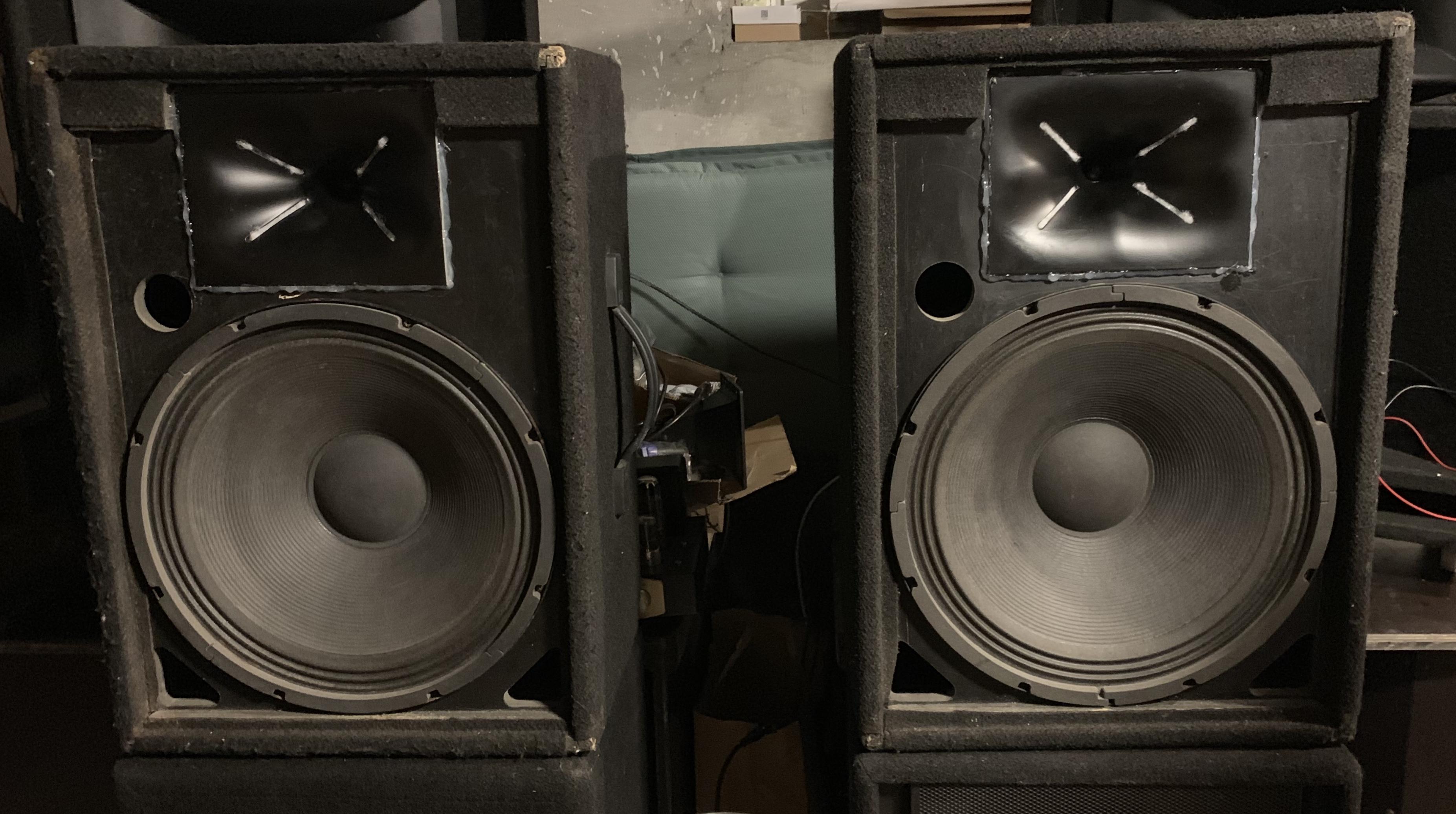

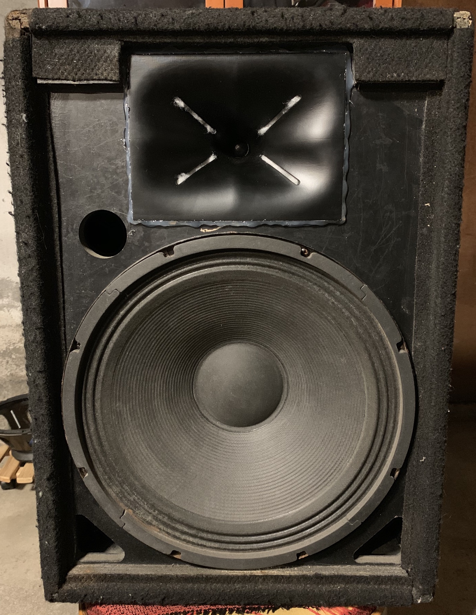

From a quick listening test it seems that the 15" woofer is quite a good match to the UICW. Tomorrow, I will install the other one and do some more serious tests and measurements later this week.
if the polars match at a sane frequency then the UICW is very small for how low a frequency the pattern is controlled as for conventional waveguides the wave guide is usually the same size or larger than the woofer.
The second box is finished. I hope there will be at least a rough match. I just used a 650 Hz crossover and listened for a while. Even if it will not be optimal, it seems to work well and these were just two boxes with woofers I had at hand.

ah yes this is exactly what I do with my speakers that are 3 way with a multiple entry horn (ph-4220) like pelanj. In my case I cross over at 500 Hz to the 15" but at that frequency I would assume from the mouth dimensions of the horn that I have lost pattern control.
With the 15" as close as I can get to the horn (I had to add an additional mounting flange) the measured delay is 0.19 wavelengths at 500Hz (horn to woofer on axis with horn) so within a 1/4 wavelength, they should sum coherently. Additionally I correct this delay in DSP, I can't tell a difference between the delay on or off.
