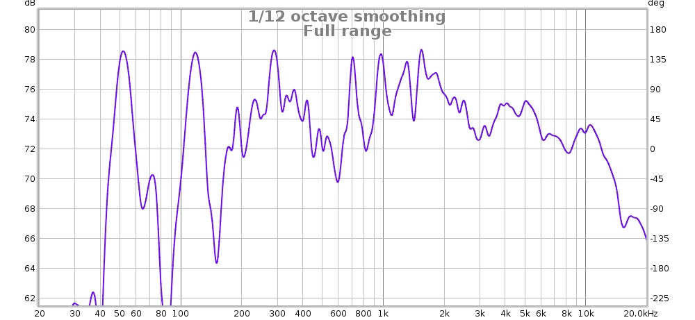

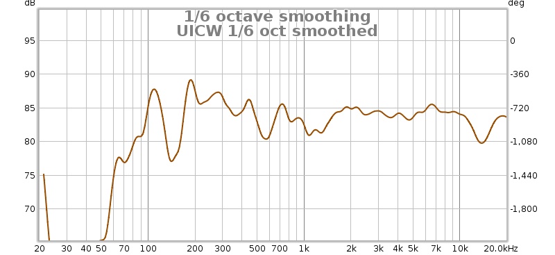

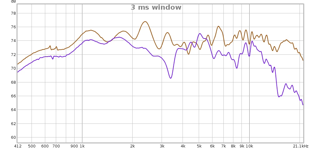

Here are my quick in room on axis measurements. The first one is 1/6 smoothed, the second one is 4 ms gated. I used the REW EQ function to determine the EQ - and if set to 2 dB tolerance, only one filter was needed. I have no after EQ measurements yet. The FR is heavily influenced by the room and objects around, but the trends are OK I think.

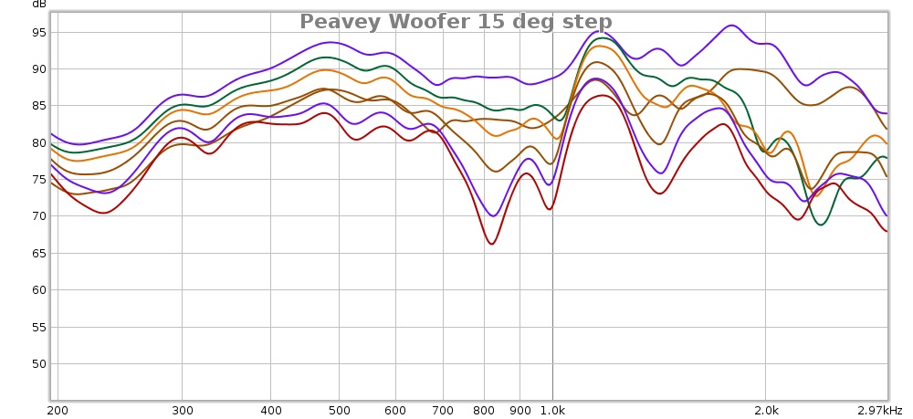

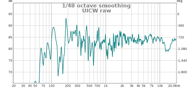

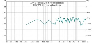

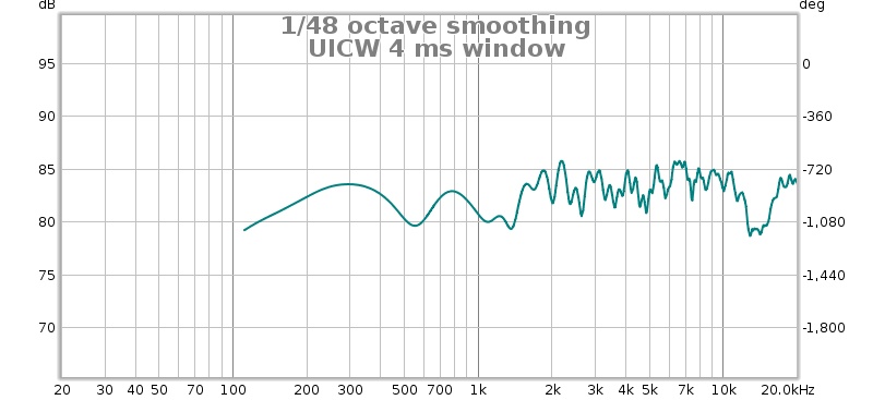

Here are some measurements including EQ and the woofer. There is a 4 ms gated (before the first reflection arrives), 1/6 oct. smoothed and raw responses. From 300 Hz +- 3 dB, not too bad. The rest is heavy room influence. The crossover to the woofer is active 4th order L-R at 500 Hz

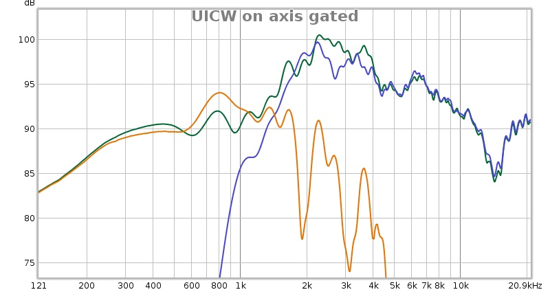

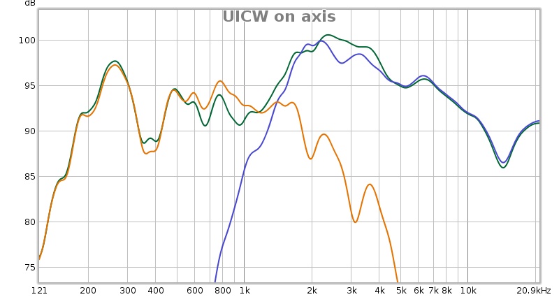

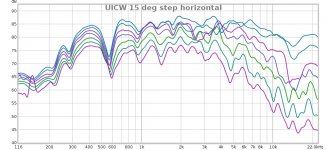

Here's the response of my UICW
Here's the response of your UICW
Here's a close up of the throat of my UICW
Here's some things that will improve the response:
First, get some clay or mortite, and make a gasket that goes between the tweeter faceplate and the waveguide throat. It has to be absolutely airtight. I used a toothpick to smooth things out.
The gasket makes a *crazy* amount of difference. When you get it right, there won't be a dip above 10khz. The dip in your measurement indicates a gap or a leak.
BTW, one of the reasons I started pursuing DIY phase plugs was because of this issue. Dome tweeters work nice but they have to be *perfectly* aligned. Even a couple of millimeters of gap makes a difference.
The second issue I see, is why the midbasses are so much lower than the tweeter. A few ideas I can think of:
1) In an early xover, I only listed one mid instead of four. That was a mistake. There are four midranges, and they're wired in series-parallel.
2) The other possiblity is maybe the tweeter xover isn't right? I would check and double check the connections. Even with no xover whatsoever, the midrange and tweeter response should looks close to the red and blue line here:
If you look at my measurement, there's a very modest amount of EQ. My EQ settings are in the screenshot in the top pic. It's the black box with the orange trace. The EQ is basically there to do two things:
1) it extends the high frequencies of the dome tweeter
2) it "cuts" the peak in the midrange response
It would probably be possible to go 100% passive, but I like hybrid crossovers. MiniDSP is $80 so I like using it in most of my projects.
The dip is definitely a leak, thanks!

I am starting to think that my series/parallel wiring must be seriously wrong - it looks like one pair is inverted? I have triple checked the wiring, but there definitely must be some very stupid and obvious mistake. Since both units measure identically, it should not be a faulty midrange. Damned, I need to cut the hot melt glue
Nevertheless, with the EQ, they still sound good. I had the crossover made according to the posted diagram from a reputable guy, so I doubt he messed up. Visually they looked ok, but I did not check them deeply - but I see the same issues in my previous measurements, so I think it is not the crossover.
I posted no XO measurements in this thread before: "Unitized" Image Control Waveguide
I tested the midranges with a 9V battery and all are wired in phase. When I apply the positive to + on the speaker, all cones move backwards - I think the correct way would be to move forward, right? I do not think this explains why the level is so low. The measured resistance is 5.6 ohms including the inductor, connectors and test leads - I measured with the crossover connected. So it seems they are wired correctly.
Heuréka! The Gento midranges I have have opposite polarity to what I am used to. And the strange behavior was caused by the midrange being out of phase with the tweeter. It does not make any sense to me, it does not explain why the level was lower when measured separately. But now without any EQ, with the passive crossover the midranges have the correct level, the FR is more or less flat with falling HF as expected. I will modify the DSP settings tomorrow. I also measured in a slightly different place, but that should not have such a big influence on the midranges.

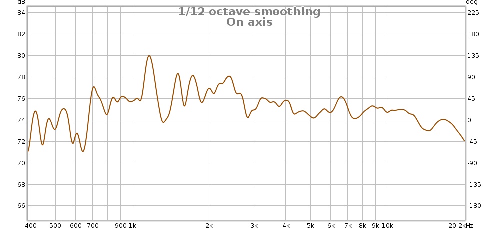

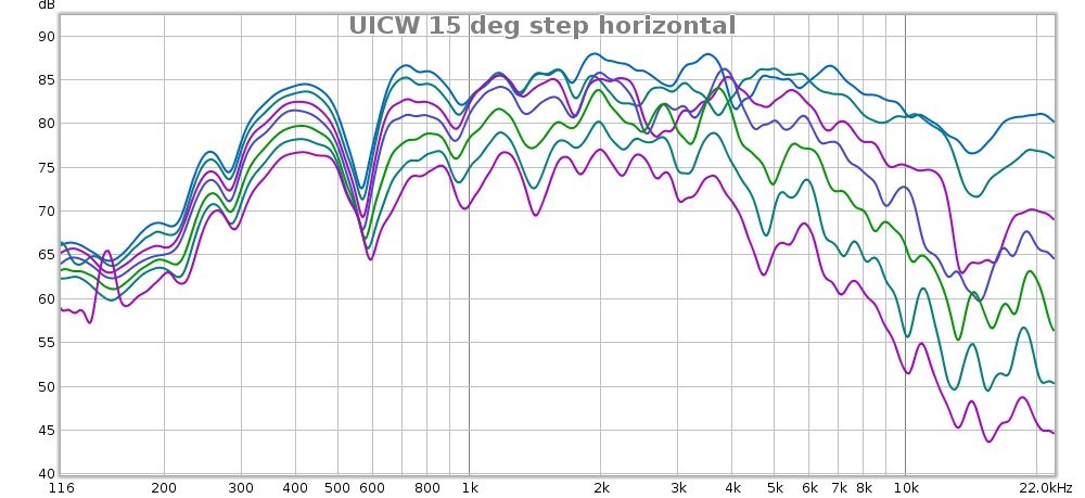

Here are my UICW outdoor measurement at 1 meter in 15 degree steps. It was a bit windy, but the main problem of these measurements is that the axis of the UICW was ca 80 cm above ground and I think that is why there are the dips. I also attached corresponding woofer measurements. The conclusion is I need to have at least a 2 m high rotating stand

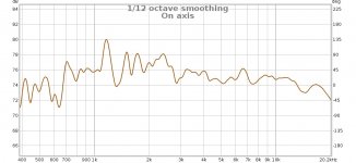

So this project is almost finished on my side Today I tried a bit of EQ similar as P.B.'s settings and here are my in room measurements at ca 1 meter on axis and slightly off axis. The first picture is gated with 3 ms, the others are ungated, just smoothed. There are no delays set yet in the Driverack PA, it would need a few ms to compensate for the bass horn length, but that is just for a good feeling. Also, the throat will get its treatment and then they are done. Not the best looks (the boxes, the WG is nice), but I am happy with the sound so far.
