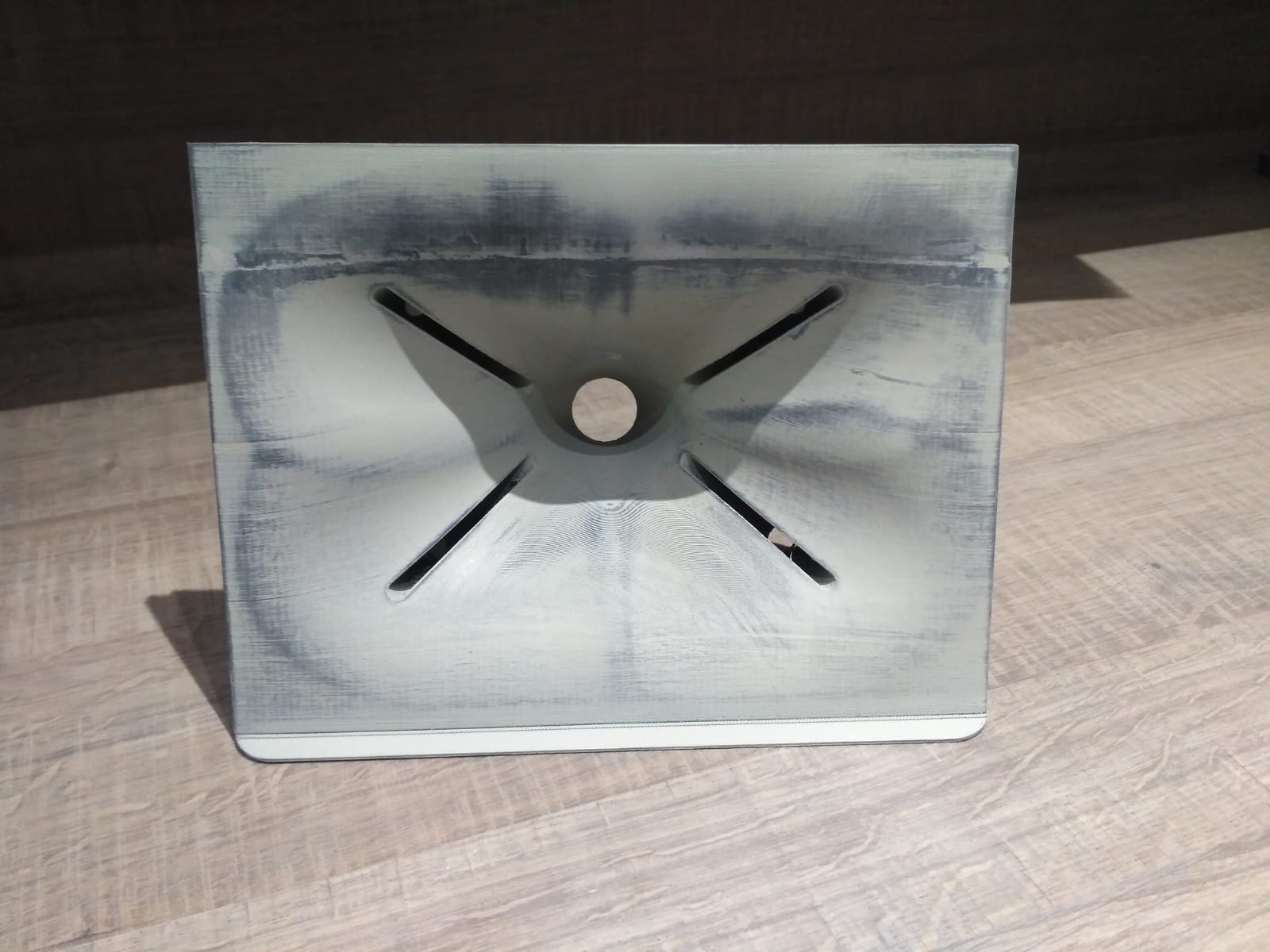

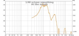

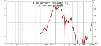

The waveguides are printed, also filled and sanded. Now it is time to buy the drivers![]()
Which filler do you use? For wood or automotive?

I can caution you that my studies of various drivers for a ME horn, revealed that the Gento drivers were of mediocre quality with large variance in data.
Further, all Gento's available to me (16pcs) had opposite polarity, i.e. the diaphragm moved towards the magnet when applied with a positive polarity to the "+" terminal.
Feel free to view the link in my signature and go to the folder "Study of 4 MF drivers"

I felt the same way.
I was at Bill Waslo's house in Portland when he said he'd opted for the Gentos and I tried to convince him to use Aurasound.
My own measurements indicates that the Gentos didn't measure anything like their published specs, and the Aurasounds were superior.
Bill argued that their deficiencies are out-of-band. For instance, the Aurasounds have lower distortion. But since the Gentos are firing through a bandpass chamber, the midrange distortion is filtered out.
In hindsight, I think Bill is right. The Gentos are far from the best driver for a full-range speaker, because they're quite cheap and there are competing drivers with lower distortion.
What the Gentos have going for them is:
1) inexpensive
2) high efficiency
3) their distortion is mitigated by the bandpass chamber in the Unity horn
Although their published specs aren't similar to what I've measured, I've found that they're consistent from unit-to-unit. I've purchased over a hundred now.
I hope it's clear, the Gentos aren't the greatest full range driver, but if you're using them over a limited bandwidth and you're on a limited budget, they're awesome IMHO.
I'm typing this post, listening to those speakers that Bill made, at an SPL level of around 100dB, as I type this. This project literally exists because I've been trying to figure out how to shrink his speaker down to a reasonable size
