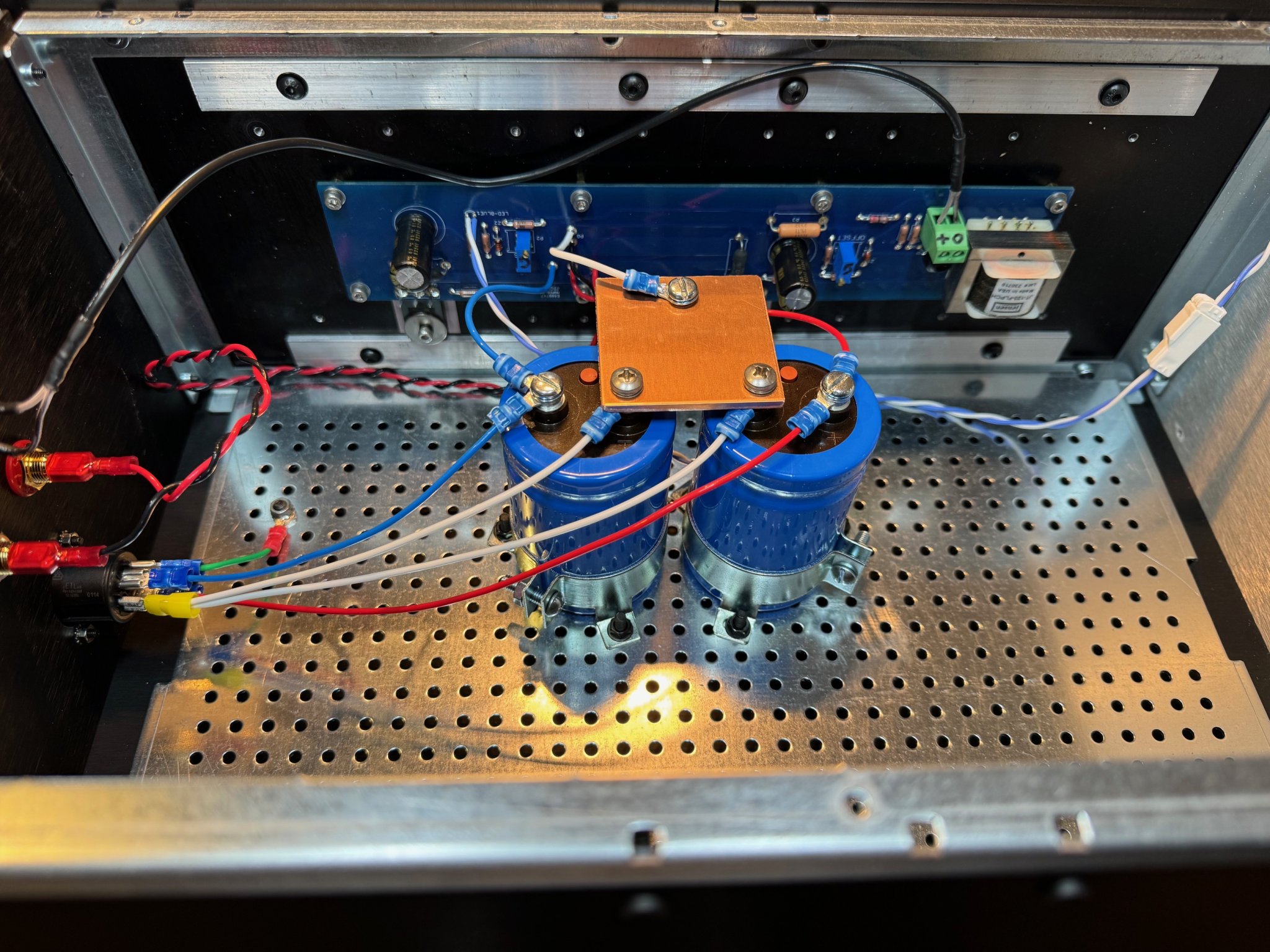

On another note I have had some buzzing even from the best of transformers the past couple of years. So I bought a Toroidy DC blocker for testing, which arrived today. A big difference, even with that huge PSU depicted a few posts back. And no, snubbers not installed - yet. But I guess those tranniecores were saturated (not in a sexual way). Gonna do some more listening and measurements of the wall outlets different times of day. But I am not parting with that blocker now!
Would be cool to make a complete PSU board with room for it all, including a DC blocking circuit. Need to learn KiCAD, soon. Too many thoughts, no fruition.
What are the differences? Tighter and more articulated bass, and a better soundstage. Cleaner, sharper but in a good way. And better tonality. This with a AJ MZM amp.

A question for the grandpas: Since outboard chassis easily has room for it, why not consider an inductor for noise filtering at the primary side? Papa mention this in his old PSU article. And if so, what kind of inductor should one be looking for?
I could try to answer this . When current flows through an inductor it creates a magnetic field . Inductors store energy in a magnetic field .
But then that magnetic field turns around , an opposes any changes in the current .
So if a large choke were connected on the hot , before the primary side of the transformer , the choke would oppose any sudden changes in current
needed by the transformer.
