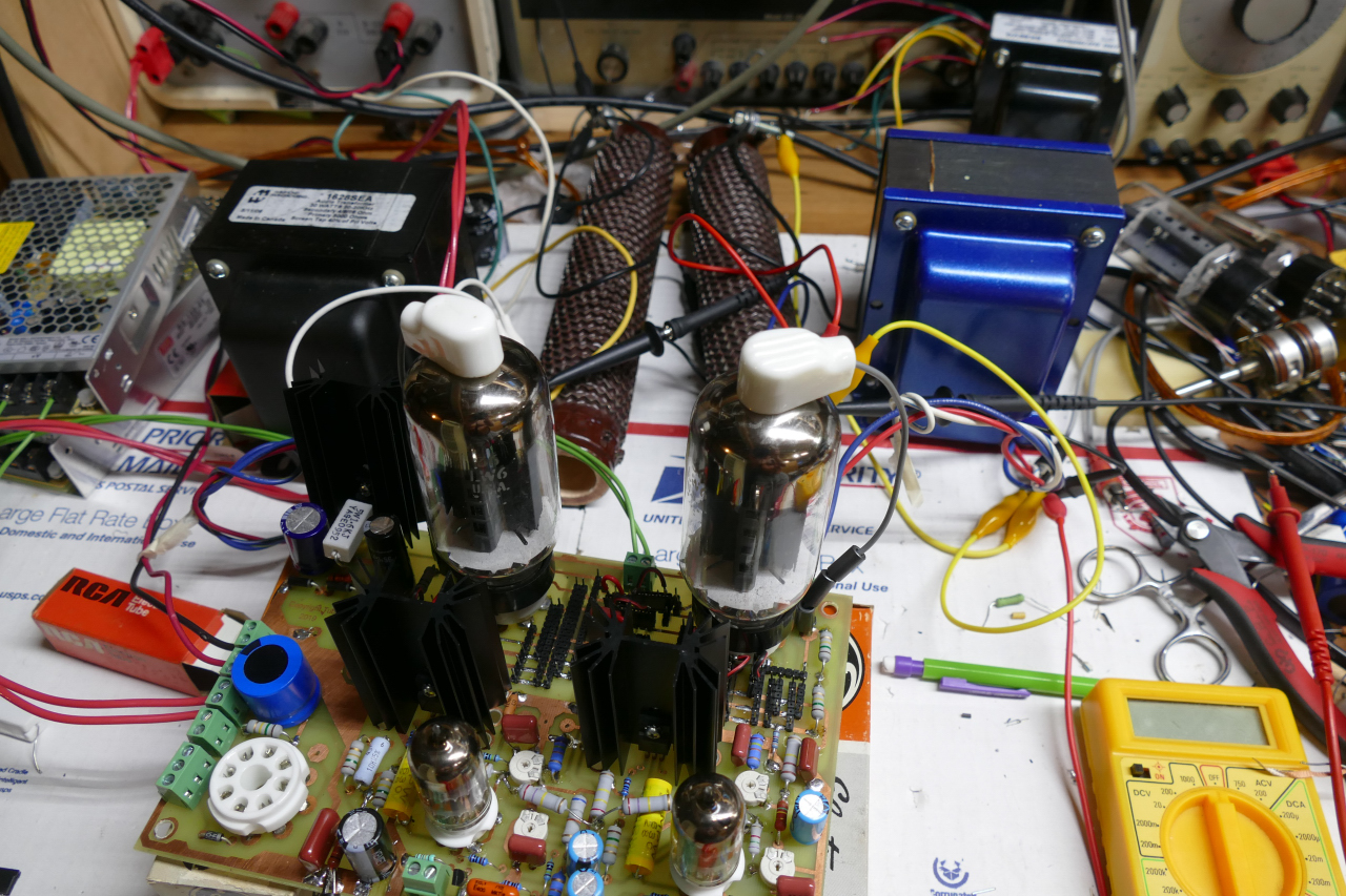

I discovered today that the SMPS that I have been using for the tube heaters is set to 28 volts. The tubes want 25.0 volts, so I readjusted it. This made some of the previous numbers a bit off, mostly in the balance between tube and mosfet power sharing, the max power numbers are still close, but some parts tweaking will be needed since the amp does not quite clip symmetrically any longer. The bottom starts to clip about a watt before the top. I had BIGGER things in mind, so........
I just had to do it.......
I removed the 500 volt filter cap, swapped out a 4.7K 1 watt resistor in the B+ line for a 10 K 2 watt since there is still a 500 volt cap down stream and hooked up the BIG power supply....the one that blows small parts into dust and makes sweep tubes explode.
I then cranked up the voltage and the audio oscillator at the same time. WHY?
Maximum tube dissipation happens at idle in a class A amp, lots of DC power going into the tube, zero audio power coming out. If I kept the drive level just below the point of clipping as I walked the DC voltage up, theoretically I could avoid melting a small tube when I shoved 68 watts into it.

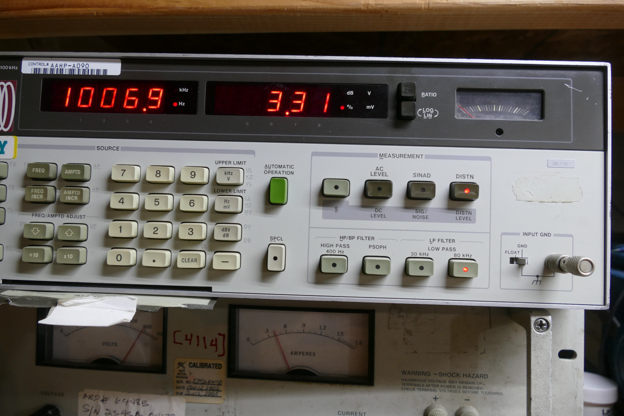

68 watts into the tube gives me 30 watts out at 2% THD.....good enough.
That took 620 volts of B+ voltage, 23 of which were lost in the OPT. 522 volts were across the tube and 75 across the mosfet. Idle current was 130 mA. Power at 5% THD was 34 watts. That's 80.6 total watts input (520 volts @ 130 mA) for 34 watts out, 42.2% efficiency, not bad for a SE amp. My 45 amp runs about 20%, the 300B TSE-II about 30% and the power hungry 845 around 33%.
Good enough? I turned the power supply up a bit more, 640 volts brought 35 watts at 3% THD and 37 watts @ 5%. Now I need 90 watts in to get 37 watts out. Still 41%, but I'm going in the wrong direction.....All of this was done with the 50 cent 25DN6's, I need bigger tubes!

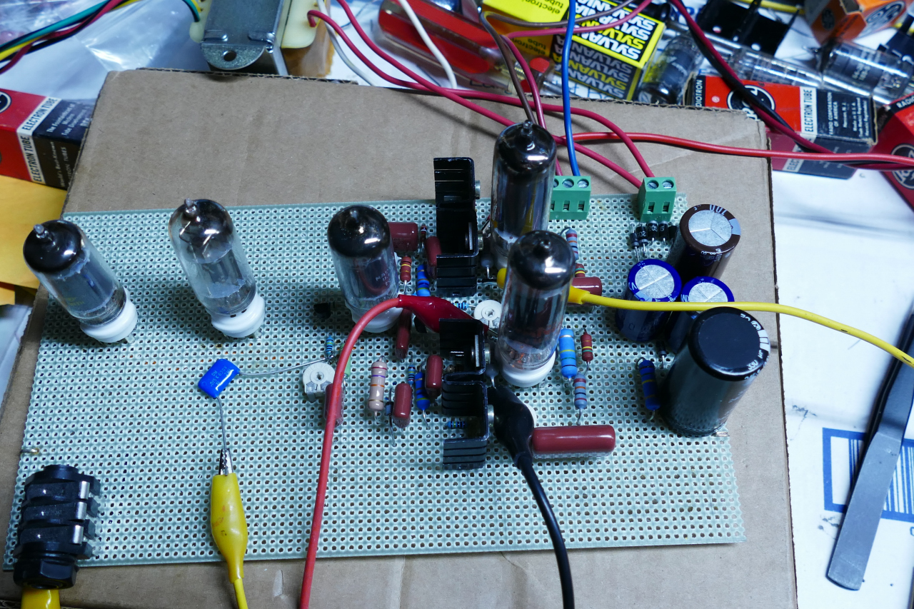

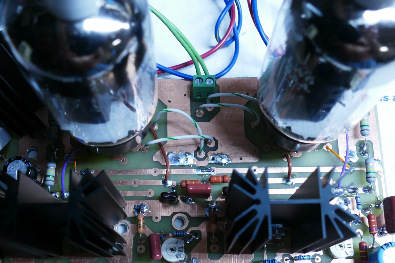

Early this morning I reconfigured the board for big tubes. And plugged in some 36LW6's and another big sweeper. I was surprised to find less power output. About 2 hours of tweaking left me with a dead board.
There seemed to be a brick wall in power output even at 650 volts and up to 160 mA. The original parts values from the simulation are still in the triodzation network. They were derived with a model for a 6DQ5 which is very much like the 25DN6's l started with. Once life is restored to the board I plan to try some 6DQ5's.
Unfortunately I don't have an LTspice model for any of the big sweepers so I may have to tune those in with so several pots.

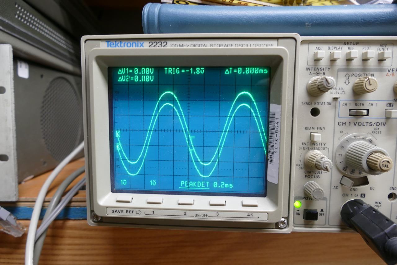

Late last night I fixed the dead board. One of those white ceramic 5 watt resistors that never go bad.....went bad. The mosfet that it feeds, however was still alive.
I poked around in the board with a scope probe and figured out where the brick wall of power is coming from. My feedback path (AKA triodization loop) is running out of headroom and clipping.....so some resistor value tweaks are needed. No big deal, except......

I now have the board operational again with the mid size tubes and am taking a short break from the clip leads and box of resistors experiments.

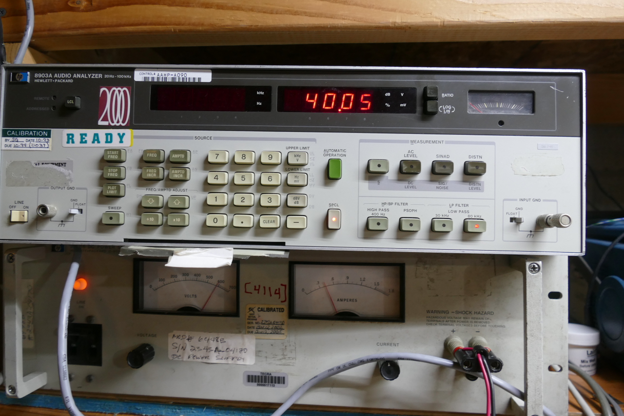

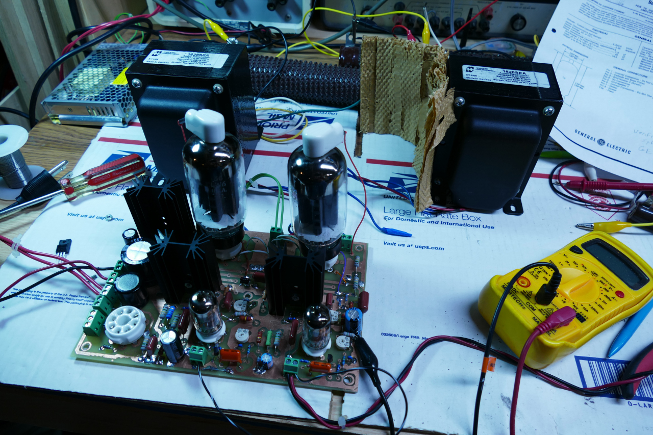

Yes, that's what I have. Tonight I successfully squeezed 40 watts through them at just over 3% THD. I stuck in a pair of the biggest sweep tubes I have, the 36LW6's that I used last night. This time I decided to beat ohms law with current, not voltage. I had to bend or break every spec in the book, but I was going to see 40 watts of SE power flow out of this thing, with both channels running, or blow it up trying......
I connected my 8 ohm load to the 16 ohm tap. This puts a 2500 ohm load on the tube. Mr Ohm says I need to put 316 volts RMS (447 V peak) of audio across a lossless OPT and it will draw 126 mA RMS (178mA peak) of current through the tube. This means that the idle current through the tube MUST be at least 178 mA to avoid touching cutoff. 178 mA of idle current will drop 30 volts of B+ in the OPT. The tube will see 70 to 100 volts across it on the current peaks of nearly twice 178 mA. This means I need about 550 - 575 volts of B+ to get 40 watts.

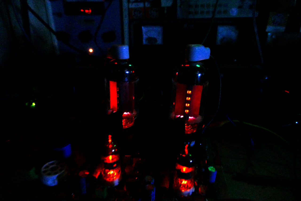

So I set the big power supply to 600 volts, set each tube to idle at 175 mA and cranked it up. I hit 43 watts at 5% THD, and 2.7% in one channel and 3.3% in the other at 40 watts.
there was about 500 volts across each tube at idle. The current was 175 mA that's 87.5 watts per tube, and you know what they were doing. The picture has had it's contrast and brightness enhanced. They were really not glowing that brightly, but one is obviously not even, and the other one is evenly glowing, is missing it's key, and has some permanent glue stain fingerprints, but most of the skin has burned off!
I reduced the voltage and current until there were no traces of glow in a dark room. That took 500 volts at 150 mA leaving about 60 - 65 watts burned in the tube and 32 watts of audio output. .
The Hammond OPT has a max current spec of 120 mA. I ran it at 175 mA so saturation was seen a lot. At 20 Hz I couldn't go past 4 watts, and at 40 Hz I could get 10. Even at the lower 150 mA current saturation was still a problem.
So if someone really wanted a 40 watt SE amp it would probably take a proper OPT, and TWO big sweep tubes per channel.
At my next opportunity I will revisit the 5K route with 30 watts as the target power level, and try the Edcor OPT.

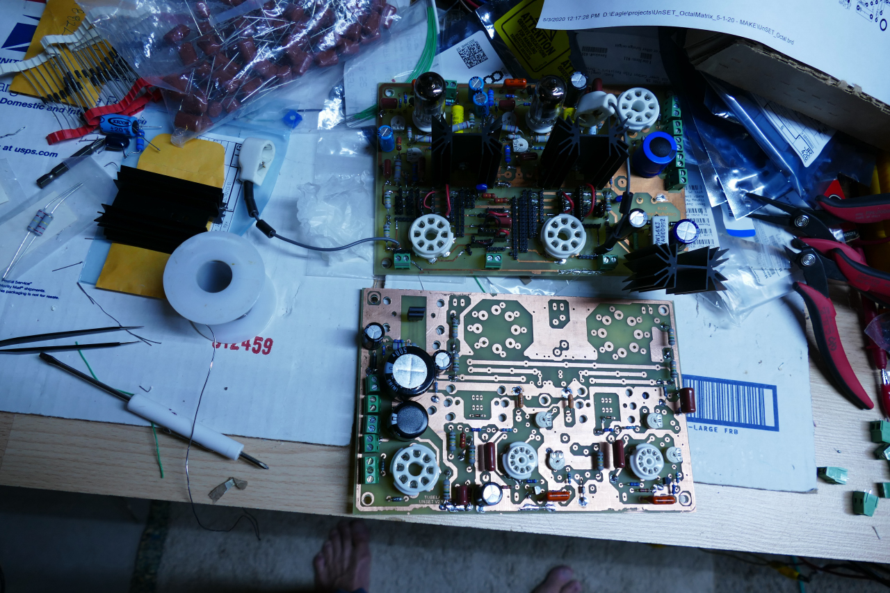

I have decided that this little test board is going to get stuck into an amplifier ASAP. I want it to see some continuous use and have a lot of listening time with it since it is a rather radical departure form the norm. The original TSE went through a lot of changes in the two years before Tubelab was born. It was my first SE amp design, so maybe this one won't take so long to prove itself. So which OPT's will I use? Bench testing is fine, but it doesn't tell me which one I will like, so I will probably make a slab of wood amp like the first SSE, or drill the top plate for three different OPT's if I make a chassis.

As I was experimenting with UNSET last year I made a list of all the problems, and a plan to fix them. I hacked up the only working UNSET test board to try my "fixes," documented the results, bounced back and forth between the simulator world and the real breadboard until they aligned.
The UNSET is an amplifier design that uses CED topology for its driver and output stages.
I was also working on the problems I faced with the little push pull version seen in post #20. The CED does a lot of things very well, but it makes a poor LTP. The push pull amp uses a pair of CED's for the LTP driver, and it just never worked right. I wound up with one of my Universal Driver boards wired into the push pull output stage and saw some real good results.
I decided to take a little diversionary detour to test some things that looked good in LT spice. That resulted in a little perf board test amp with a mosfet split load PI that squeezes 20 watts from a pair of lowly 50C5 radio tubes, without over stressing them. I let it run overnight at 20 watts and it was still running fine the next morning. The unbuilt section to the left of the three wired up tubes will be a guitar preamp. This whole test board should morph into a 20 watt guitar amp, with a little more of my attention.
Lessons learned from the diversionary experiments are being rolled back into the UNSET and Push Pull designs. Resulting in a new UNSET test board, seen here being populated along side the original UNSET board, and two days later, fully operational with the fattest sweep tubes on the planet, the 36LW6.
Note the revised jumper scheme for the output tubes. Anything that comes in an octal socket can be connected up, though obviously not all octals will work. A small daughter board for compactrons can be made too.
I realized that even a 5U4 is insufficient for these big tubes. I am using a bench supply with them and running 480 volts of B+ at 275 mA total power supply current for 20 WPC. This kind of power will probably need silicon diodes, but amps below 10 to 15 (maybe) WPC might get by with a tube rectifier if desired.
I have found some things that need changing, so at least one more test board and a lot of testing will be needed before the UNSET can become a Tubelab board.
I'm about halfway through some serious testing. The data will be posted as I compile it all, but so far things look good.
