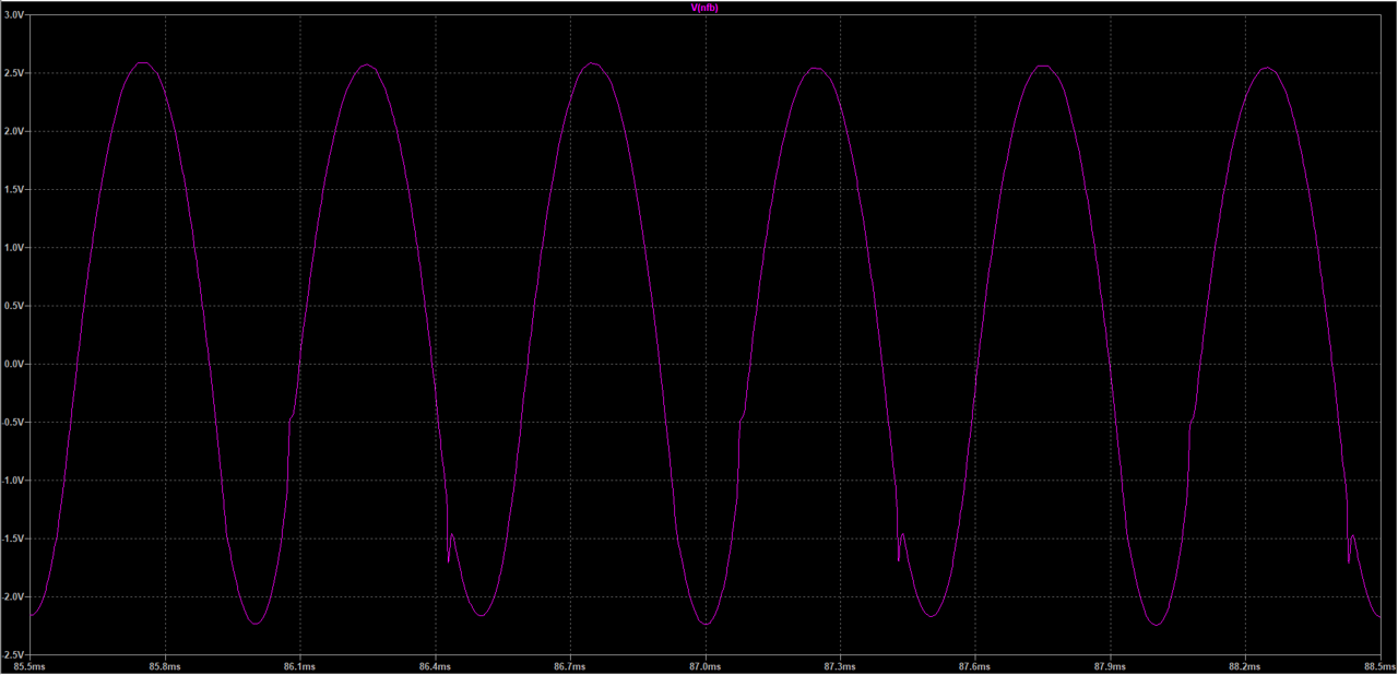

Hi George, or anyone else willing to look at my simulation.
I tried simulating your posted circuit and get horrific distortion (5713.491356%) at 1.6Vrms out.
The .sub and .inc files won't attach so here are the lists:
Maybe the distortion to the output waveform might suggest something. Apart form the obvious glitches the positive excursion is greater than the negative excursion.
I tried disconnecting the feedback to the screen of U1 while duplicating it's biasing but that didn't help.

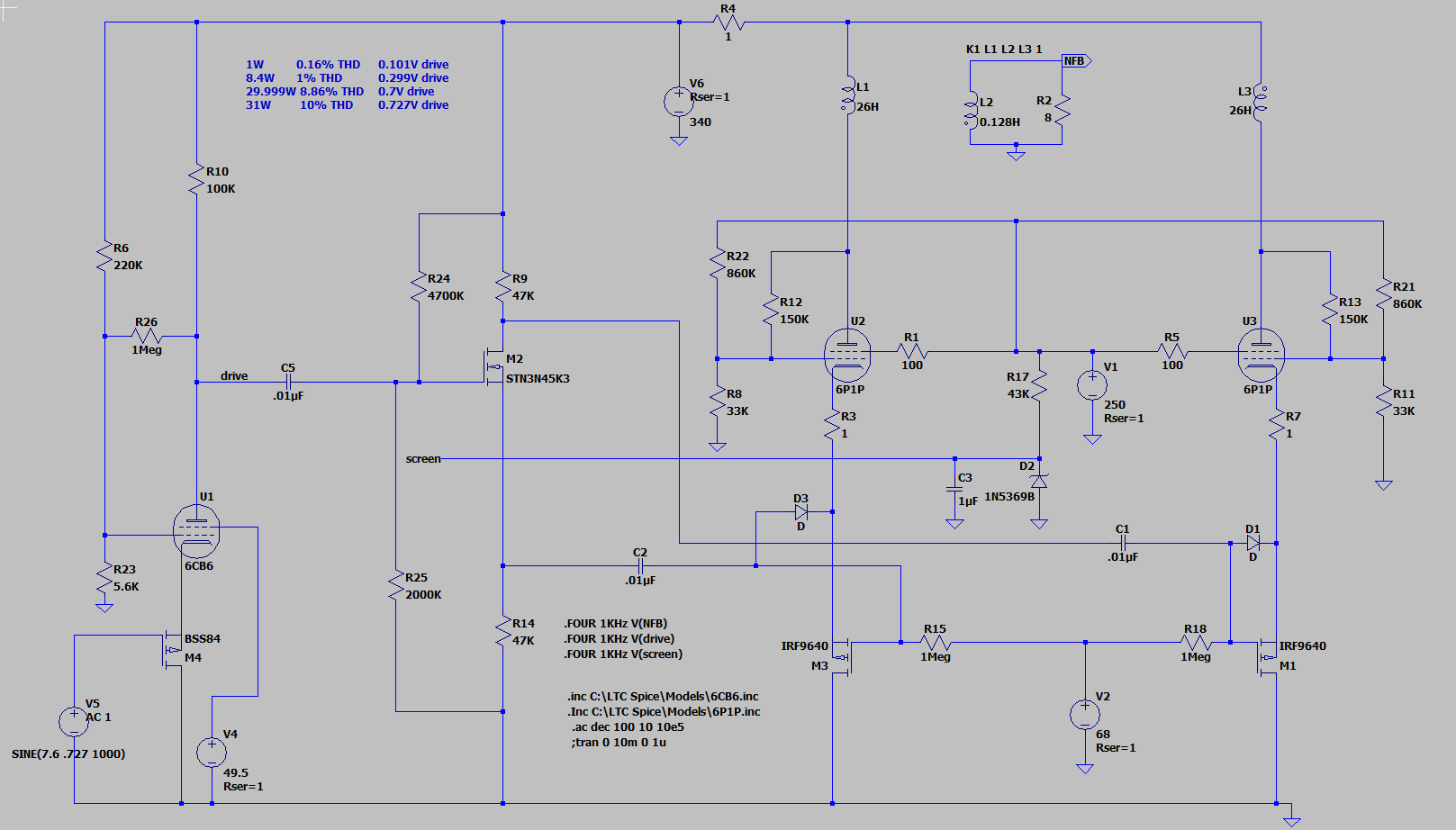

I managed to modify and tweak the circuit for the 6P1P-EV.
>30W at 10% THD!
The tubes are running at 85% max dissipation (12W).
IT will probably take me a while to test this, but I really look forward to it.
I had a number of issues with LTSpice reporting step size errors and had to isolate the screen supply to the input tube.
I also switched to the 6CB6 as the input tube as I have a nice supply of them.
Since the grid is tied to ground, is this a grounded grid topology with a FET buffer driving the cathode?
The P-FET has no voltage gain since the source is attached to the cathode of the tube and it acts as a source follower providing a low impedance drive.
In the circuit you are simulating the grid is not grounded. Negative feedback via a resistor directly from the plate of the tube makes the pentode look a lot like a triode. This was discovered by Schade back around 1940, but always involved at least one capacitor in the path.
Now that you have your sim running put a probe on the cathode and control grid of an output tube. All will be moving in phase, but at different levels. The only element that's not moving is G2. So the drive is directly applied between G2 and the cathode while the drive minus the local negative feedback is applied between G1 and the cathode.
Using this arrangement has several advantages.
No negative voltage supply is needed.
The total output stage dissipation is split between the tube and the mosfet. The ratio of this split is dependent on the idle voltage on G1.
At idle the tube sees a voltage on its cathode as in cathode bias, but this voltage is not wasted in a resistor as when driven to full conduction the cathode voltage is near zero putting all the B+ to work driving the OPT.
The "triodness" of a given pentode can be adjusted by changing the amount of feedback from the plate. This can be done easily with a large cap and a variable resistance from G1 to ground, also offering a low frequency rolloff. For those who prefer not to stick a big cap here, one can switch different plate to grid resistors, while also switching a resistor from G1 to B+ to result in the same voltage on G1. I have a small tube version working with a 6 position switch to go from triode like curves, to full pentode.
This concept can be used with true sweep tubes that need G2 around 150 volts. It can also be used with the common audio tubes with G2 at a higher voltage. The G2 supply is the only thing that needs to be changed.
The same concept can be used to reduce the effective Mu of a triode. I have made it work in simulation with those high Mu regulator beam triodes, but the first test in a real circuit blew up in an oscillatory fashion as those tubes are prone to do. Mu=300 Gm=65000 very hard to tame!
Disadvantage, all signals are in phase! care must be used in layout, and decoupling is likely needed on power supply lines even in a two stage amp.

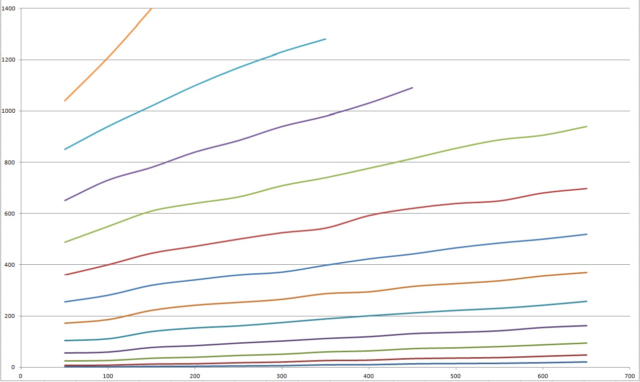

I did have one 6HJ5 shatter, and another explode. Granted that these were being tested with the big HP turned up to 600 volts. A dumb math error led me to attempt to pass a 1/2 Amp pulse through the tube / mosfet combination at which point it all blew up, shattering the bottom of the tube.
How DUMM was that? Not as DUMM as trying it again expecting a different result. This time the tube exploded scattering glass all over the bench and floor. So, 600 volts times 1/2 amp is how many watts????? Even a dumm blonde should have realized this before pushing the button, but NOOOO, I had to do it twice!
I guess it didn't seem too far fetched since I actually tested a 6LW6 to higher power levels than this. Note the green line in this plot goes to 650 volts at 930 mA. That tube is still alive and well two years later.
The initial short circuit current on those power supplies is very large since there is 1000uf of capacitance across the output inside the supply, capable of delivering over 200 joules of energy to any unsuspecting part. I'm still not sure which blew first, the tube or mosfet since there was not much left of either. I'm setting up to curve trace some more big tubes. This time I will put my two big 8 ohm 500 watt resistors in series with the test subject to limit the explosions to minor levels.
