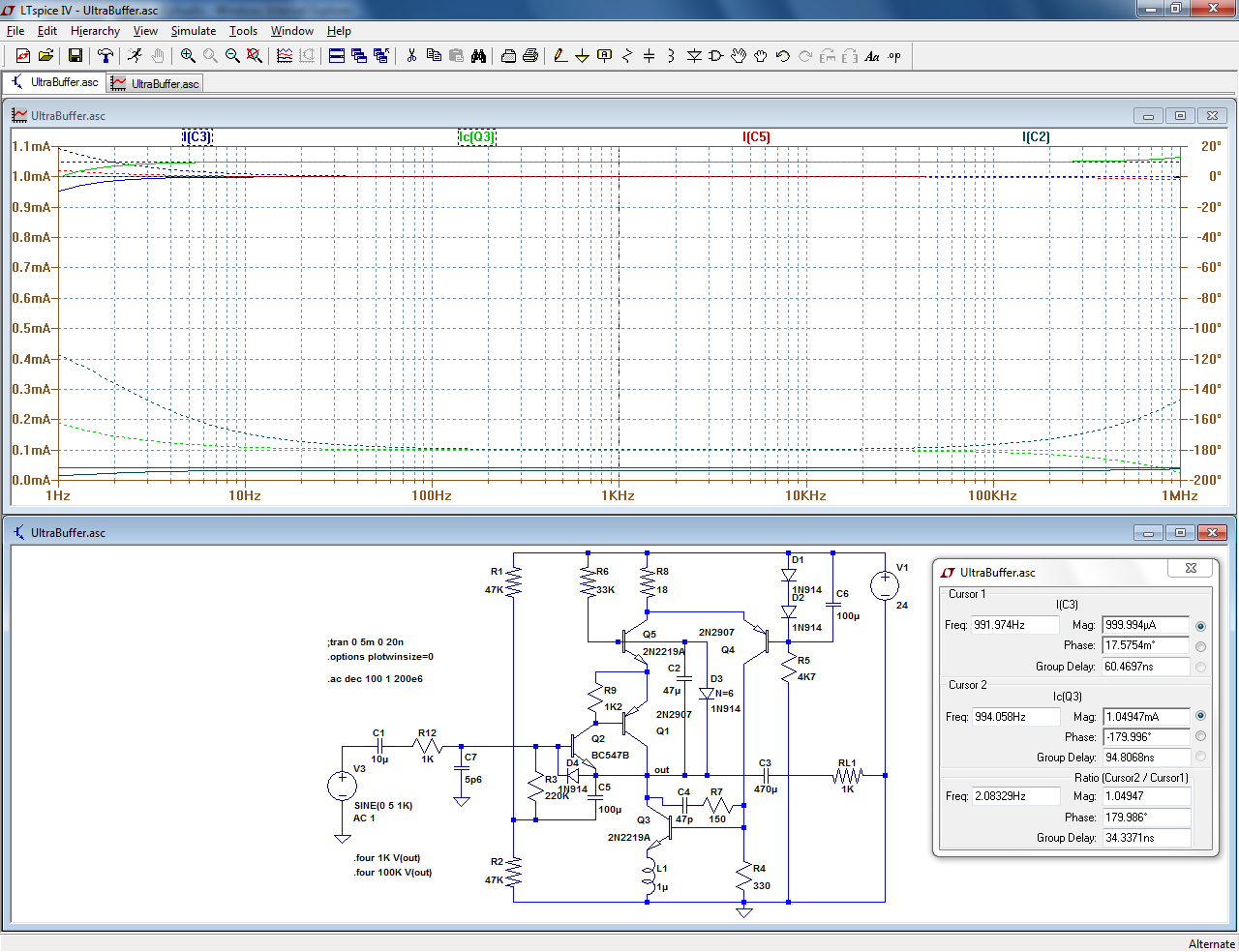

Here is the same analyzis using LT spice.I was working on a buffer which operated close to the way this one does. It is very difficult to see what is happening using ltspice. I will show you using circuitmaker since it will show plainly the ac currents involved.
First using the schema attached we look at the ac current flowing out of the collector of Q3, 743.9uA. Next we look at the ac current flowing into the load, 707.1uA. As you can see there is more ac current flowing out of the collector of Q3, 36.8uA. Now as you will see this extra current is being driven into the collector of Q5, 14.8uA, and through capacitor C4, 21.57uA. If you look at the ac currents through the load, Q5, C4, the total equals the ac collector current of Q3. So it is driving itself.
I have used the AC analysis, because it didplays the phase too. At low frequencies, it is unimportant since it is always 0° or 180°, but at higher frequencies, working out intermediate phase values in transient mode is difficult.

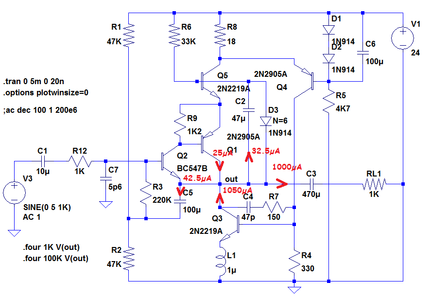

To apply the Kirchoff's current law properly, you need to have the signs right, ie look at the current arrow on the component (depends how it is drawn) and the phase (0° or 180°) on the waveform viewer.
The following pic is the schematic annotated with these values for 1KHz.
The sum of the currents provided by the two active elements Q1 and Q3 is 1075µ. It is equal to the sum of the currents absorbed by the main passive elements, load, bootstrap, etc.
Q3 provides the brunt of the current, which is normal: that is the purpose of this circuit. The 1050/25 ratio is the loop gain of the circuit, Q1 is just the steering device.
If negative resistance was apparent at the collector of Q3, it would result in a negative current into Q1, which would cause instabilities and is obviously not the case here, particularly at 1KHz where no problem is observed.
With this sim, even at higher frequencies no instabilities occur, unlike the physical circuit.

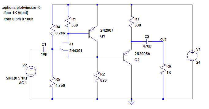

Could you post a schematic, I 'll simulate it, but I have doubts: jFETs have a high distortion compared to BJT's, and here I need ppb level up to 100KHz, which seems difficult to achieve with FETs.My other suggestion - high IDSS NJFET input device, NPN or N-MOSFET cascode, then PNP phase-inverter and Q3 configured as a PNP emitter-follower, that topology I have shipped hundreds of units with nary a problem, so I know that would work. Doesn't need much in the way of compensation, either (only C7 as 15pF~33pF).
Greetings Elvee: A PNP can be combined with the input N-JFET to make a CFP, which should push the distortion farther down.
However, ppb will be difficult, not only regarding the schematic but also the physical build (but I know that you are well aware of that).
Is this what you have in mind?
Hi Elvee: Regarding a JFET CFP, yes, something like that may do (although I have neither simulated nor built your device choices).
May I assume that the sole purpose of the latest schematic that you posted is to show some kind of JFET CFP being used as the input device for a buffer? The complete buffer that I have in mind is very different from the latest schematic (and much closer to your first schematic).

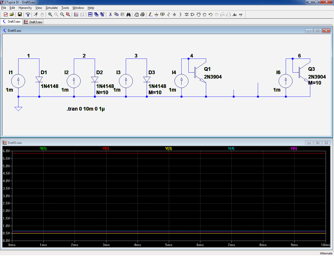

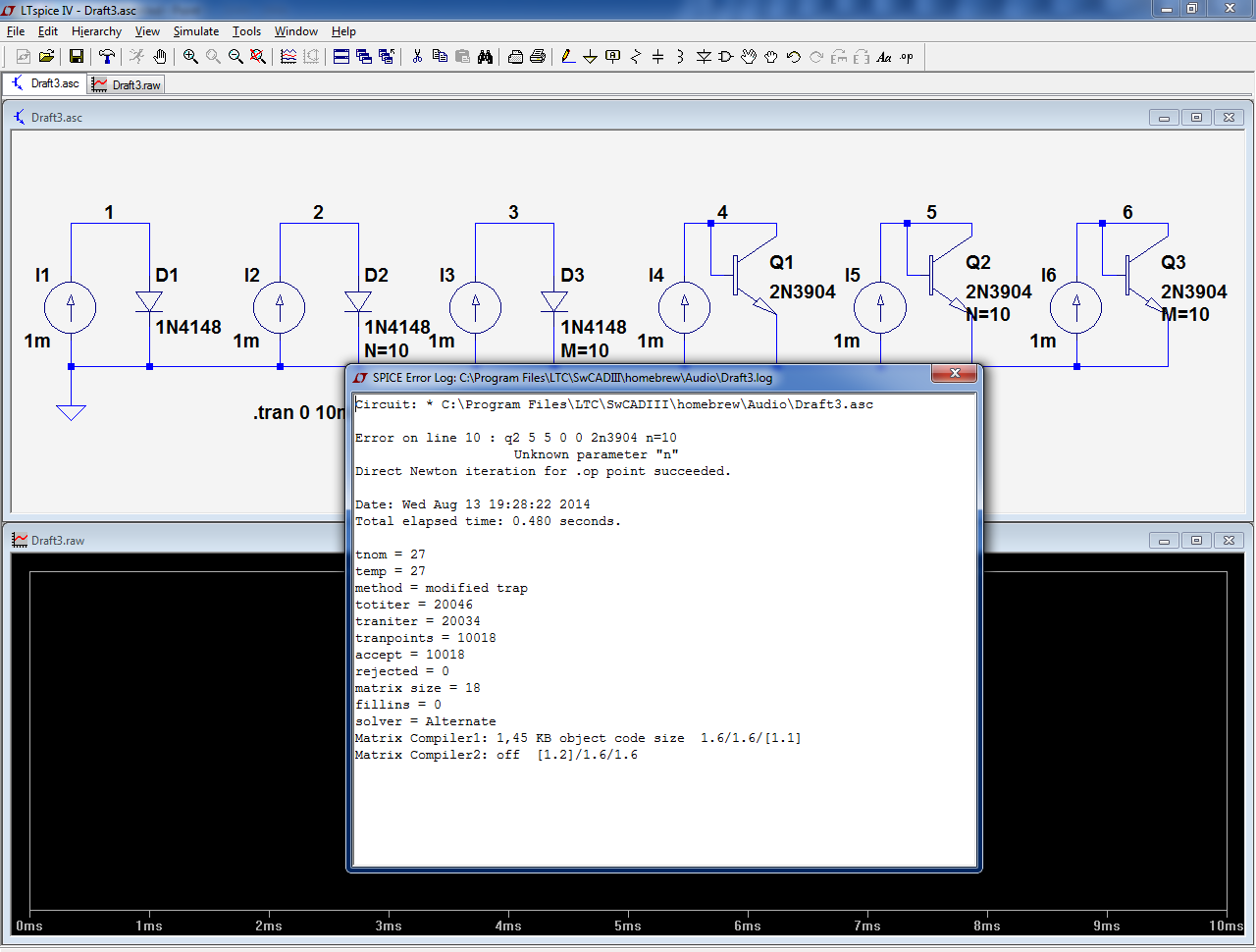

When creating ASCII net lists (typing into a text editor) for SPICE simulators, M=43 means 43 copies of this element in parallel, whether the element is a BJT, FET, diode, resistor, capacitor, inductor, or subcircuit instantiation. ("M" abbreviates "multiplicity".) I'm surprised to read that you are quite certain you're getting N=6 diode elements in series. Is the "N" parameter (series) exactly the converse of the "M" parameter (parallel)?
What do you think happens when you attach N=43 to a three terminal element like a MOSFET? If you get 43 MOSFETs in series, where do the 43 different gate nodes connect? And how does it work for a 7-terminal sub circuit instantiation?
What do you think?What do you think happens when you attach N=43 to a three terminal element like a MOSFET?

This buffer is a building block of a high resolution audio measurement system, and it will have to process a range of frequencies centered around ~100KHz with sub-ppm linearity, ideally sub-ppb, hence the "complexity" (which is quite relative and moderate considering the performances)It's a BUFFER for goodness sake. Why the 'faux arte' complexity?
It is a microchoke from Epcos. Its // capacitance is a few pF's, and the SRF must be around 100MHz.What is the quality of L1? Resonances maybe?
Yes, it changed nothingDid you try parallel resistor?
If it helps, just by playing around with your circuit trying to make it oscillate in LTspice using possible stray capacitance and wiring inductance values, a 20pF or higher capacitance between Q5 collector and the output combined with 100nH between the top of R8 and D1 in the +ve supply line induces VHF oscillation.
Playing around again but this time to try and stop the oscillation with as low a value cap as possible, the most effective place was 15pF between Q2 base and Q5 emitter.
