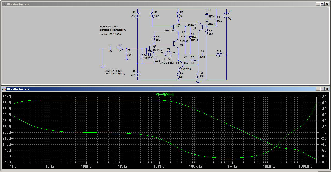

This buffer is a building block of a high resolution audio measurement system, and it will have to process a range of frequencies centered around ~100KHz with sub-ppm linearity, ideally sub-ppb, hence the "complexity" (which is quite relative and moderate considering the performances)

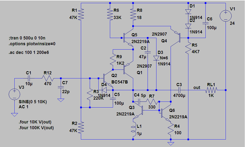

It is worth triying, I'll make a test tomorrowIf it helps, just by playing around with your circuit trying to make it oscillate in LTspice using possible stray capacitance and wiring inductance values, a 20pF or higher capacitance between Q5 collector and the output combined with 100nH between the top of R8 and D1 in the +ve supply line induces VHF oscillation.
Playing around again but this time to try and stop the oscillation with as low a value cap as possible, the most effective place was 15pF between Q2 base and Q5 emitter.
I'll try it too, but I think it will stop oscillations: the final effect is comparable to the feedforward cap I tried earlierPerhaps simplifying the circuit to get some data would be helpful.
SWAG-the bias loop Q4-Q3 thru the main amp xistors (Q2-Q1) up through Q5 could be unstable.
What if, just as an experiment to test that theory, you broke that loop? Simplest way that preserves the most parasitics, might be to
1. temporarily short out D1 and D2
2. place a 500 Ohm resistor from the out node to ground to get pull down current.
If it stabilizes things, it might give you a hint as to where to go next.

OK, I have found the time to make some tests
But this negative opened up new possibilities; in fact only one is left: the cascode stage. I disabled Q5, and bingo, oscillations were gone!
Since this type of cascoding has nothing unusual and works properly most of the time, it is probably the combination cascode + CFP which has such a weird effect, so weird that the sim didn't catch it.
With this knowledge, I concentrated my efforts on Q5, but the problem seems exceptionally persistent: I tried base and emitter stoppers, and even with a combination resistor + ferrite bead, it wouldn't go away. If anything, the remedies seem to make things worst.
I'll have to think about it overnight, try to figure out what's going on. Very strange.

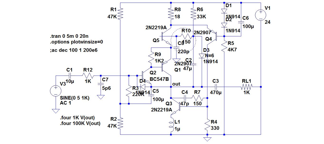

This one had no effect, nothing positive anyway.Playing around again but this time to try and stop the oscillation with as low a value cap as possible, the most effective place was 15pF between Q2 base and Q5 emitter.
Quite surprisingly, this one had no effect either. This was completely unexpected, as I imagined the current stasis loop played a big role in the instabilities.What if, just as an experiment to test that theory, you broke that loop? Simplest way that preserves the most parasitics, might be to
Here's another experiment that might further the divide and conquer strategy.
With the stasis loop disabled as described in my earlier email, you report that the oscillation remains. You also report that eliminating the cascode transistor
Q5 stops the oscillation.
Perhaps you've done essentially this already with the base and emitter stoppers...but, what happens if you remove C2 while the cascode transistor is still in place?

Perhaps, but the original circuit looked stable too. Meddling with the current loop without modifying the cascode will only have minor effects, if anyThis one "looks" stable in simulation..
This will essentially leave the 6 diode's dynamic resistance as base stopper.Perhaps you've done essentially this already with the base and emitter stoppers...but, what happens if you remove C2 while the cascode transistor is still in place?
I suppose that at some level, it will manage to kill the oscillations, but at the cost of the HF performance, which is important in my case
6.8Ω + 270nH ferrite beadHow much emitter degeneration did you add to Q5 ?
That's true...it will affect the high freqs, but if it succeeds (or fails) in stopping the oscillation, it may give insight into a better way to find an answer that you can live with.
Voltwide had a good observation. I repeated his test and found:
1. disabling the cascode helped phase margin a little, but it was still kind of iffy.
2. Adding 100 pF from collector to base of Q1 gets pretty good phase margin.
Of course, if the sim and reality agree...that remains to be seen!
