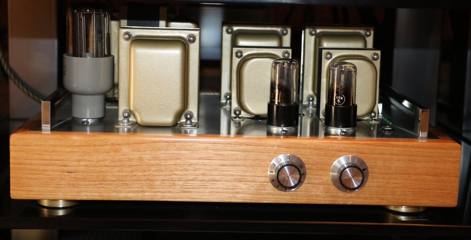

I am using a tube preamp that has a 12AU7 tube for the gain and it is one I built. I like a tube pre with SS amps with my horn speakers. With conventional speakers I do not think it would matter that much if a good SS pre was used.

Interesting, do you know the output impedance? ( of your pre) If higher than normal, like many tube preamps, does it "soften the highs" as a few were talking about on the F-6 thread? (not the build thread)
Full Range, do you know the output impedance of you Nakamichi Preamp? Did you notice "softened highs" being a problem. I ask as I was planing on useing BA-3 FE which is over 1K...I did note you said something about having to turn down tweeter on your crossover...
Just found it...appears to be 1K.

My output impedance varies with the pot but normally it is around 10K which is high but I do not think the highs are soft but I do not hear above 11K hz anyway being 66 years old. The highs I hear sound great.

Nice preamp. I look forward to hearing your impressions with the tube preamp and horns.

You will all remember on the last occasion my review was the F6 connected to the Nakamichi pre amp
This time the F6 is connected to my one of a kind custom valve pre amp with a twist? - you see its also a DAC with an OEM TDA 1541 chip
Made by Earle Weston in Australia - sb343971 - Home
In a nutshell it is a Tube pre-amplifier running a directly coupled 6SN7 driving an output transformer with a OEM TDA1541 DAC board on one of the 4 selectable inputs.
The pre-amplifier acting as a gain stage and buffer for the DAC.
It runs three RCA inputs, then the digital section with momentary toggle switch and LED's that allow you cycle through USB, Optical, SPDIF and I2S inputs.
Specs on the tube section are
Distortion at full volume > 0.06%.
Frequency response +/- 0.25db 20hz to 50khz.
Signal to noise ratio >90db.
Hum at zero volume 0.15 millivolt.
Output impedance 80 ohms.
