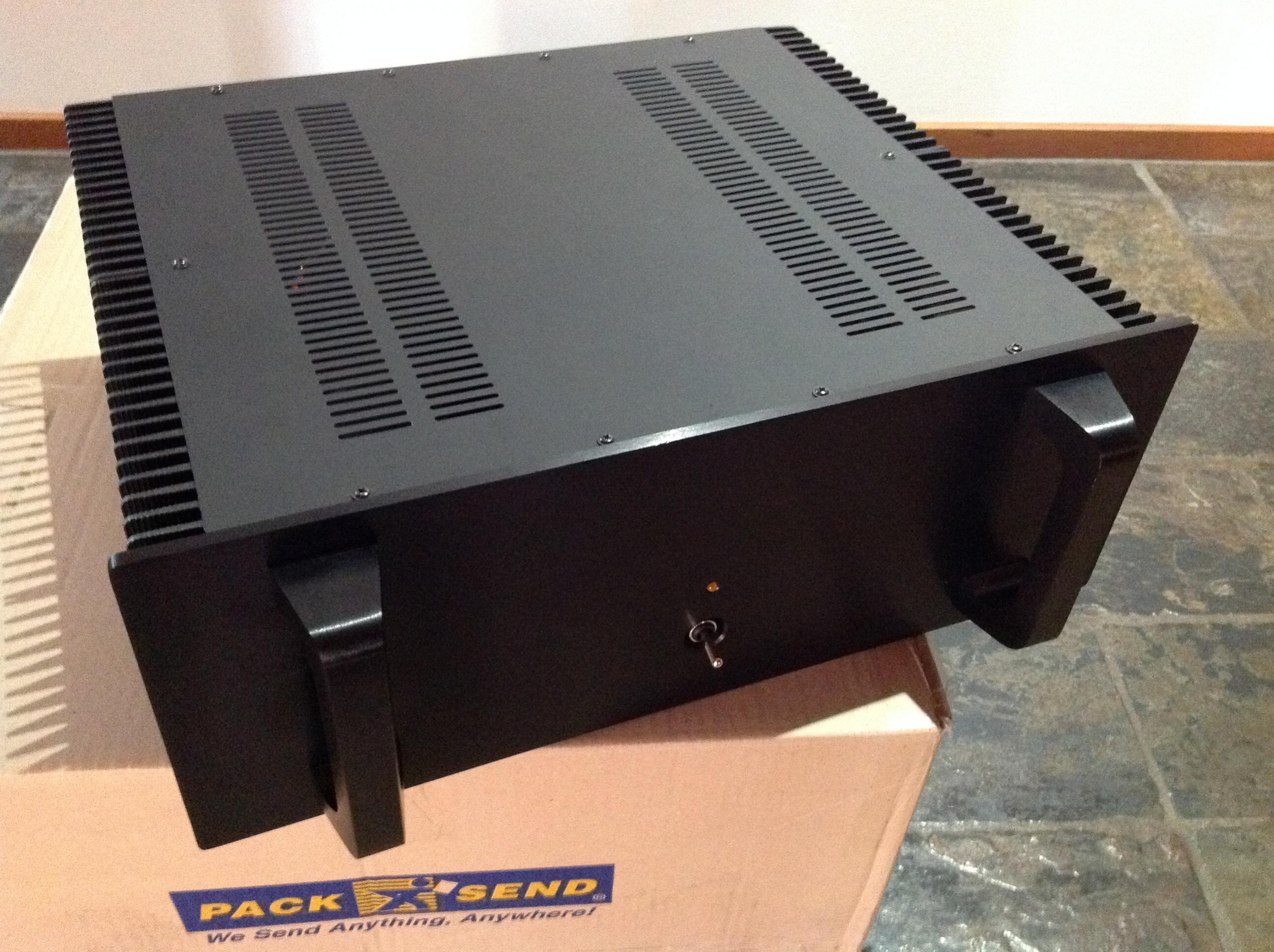

Upgrade F5 to F6
I thought you may like it. There is absolutely nothing wrong with the sound using a good SS pre but to me the F6 sounds much better with a good tube pre or for that matter any SS amp. I would love to hear the Luminaria preamp with the SIT's to compare. This is with horn speakers, I do not know if there would be as much difference with conventional speakers.

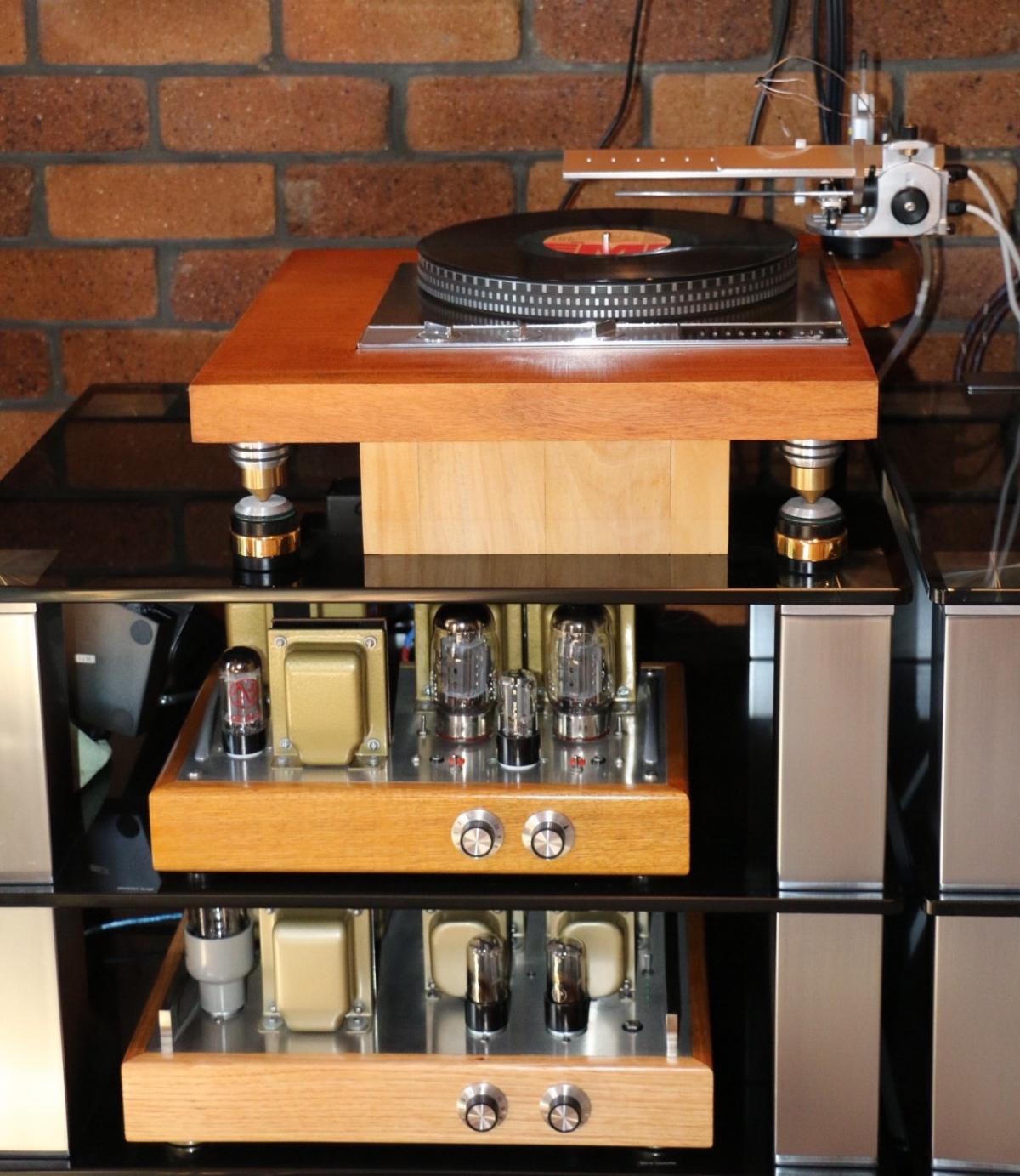

On this latest review we are testing the F6 on Vinyl playback
The F6 amp is connected to
Nakamichi CA5 preamp
Turntable is connected to the CA5 phono stage and is a
Garrard 401 with Terminator air bearing tone arm
Stanton EEE cartridge fitted with a Jico, Shibata cut stylus and DIY plinth
Now you have all those details, I can start on the review

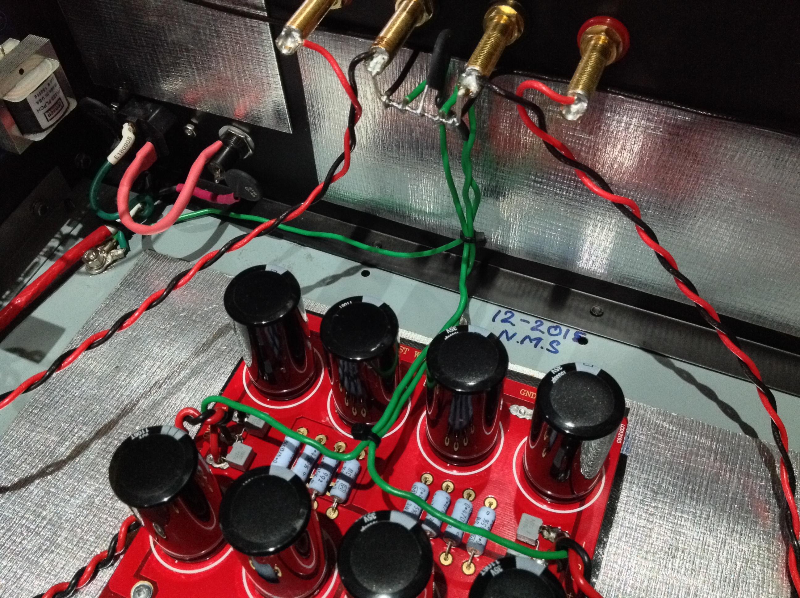

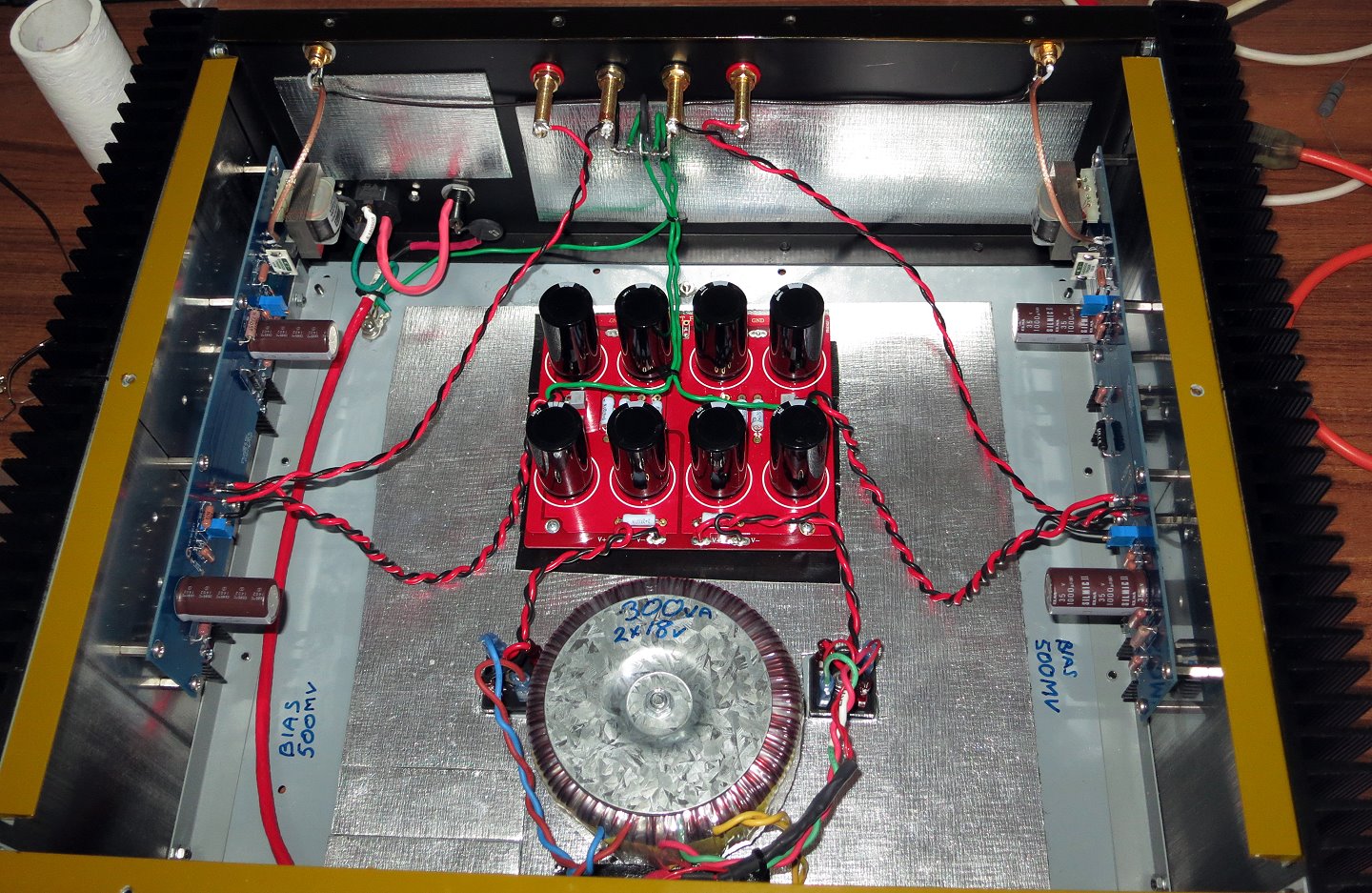

Thought it was about time for an update
Just before Christmas I noticed the slightest of hums in the bass section
The only reason I actually noticed this hum was because I was sitting directly in front of the speaker while choosing a record to play ( as you do ) because it can take some time to decide 😉
Anyway after the holidays, my associate put the amp on his Rigol tester and found a small anomaly
So we decided to rewire the power lines and the earth points in the previous configuration that was on the F5
This fixed the hum issue completely
Please see photos of new redirected wiring
P.S. Still enjoying the F6 immensely
FR

Yes the wiring and other I items were locally sourced from Speaker Bug in Brisbane - SpeakerBug
They are the Australian distributors of Jantzen capacitors and that's where I got my parts to build my crossovers
The PCB components for the F6 build were sourced from all over the world
FR
nearly not enough
for proper air circulation , you need both intake and outtake holes
though - those are your caps , xformers and other parts , not mine
you can cook them whichever way you want
:clown:
For you I will add some large holes with my metal hole drill bit @ approx 28/30mm on the base plate
Probably fit two on each side easily but will measure for three each side if comfortable
FR
