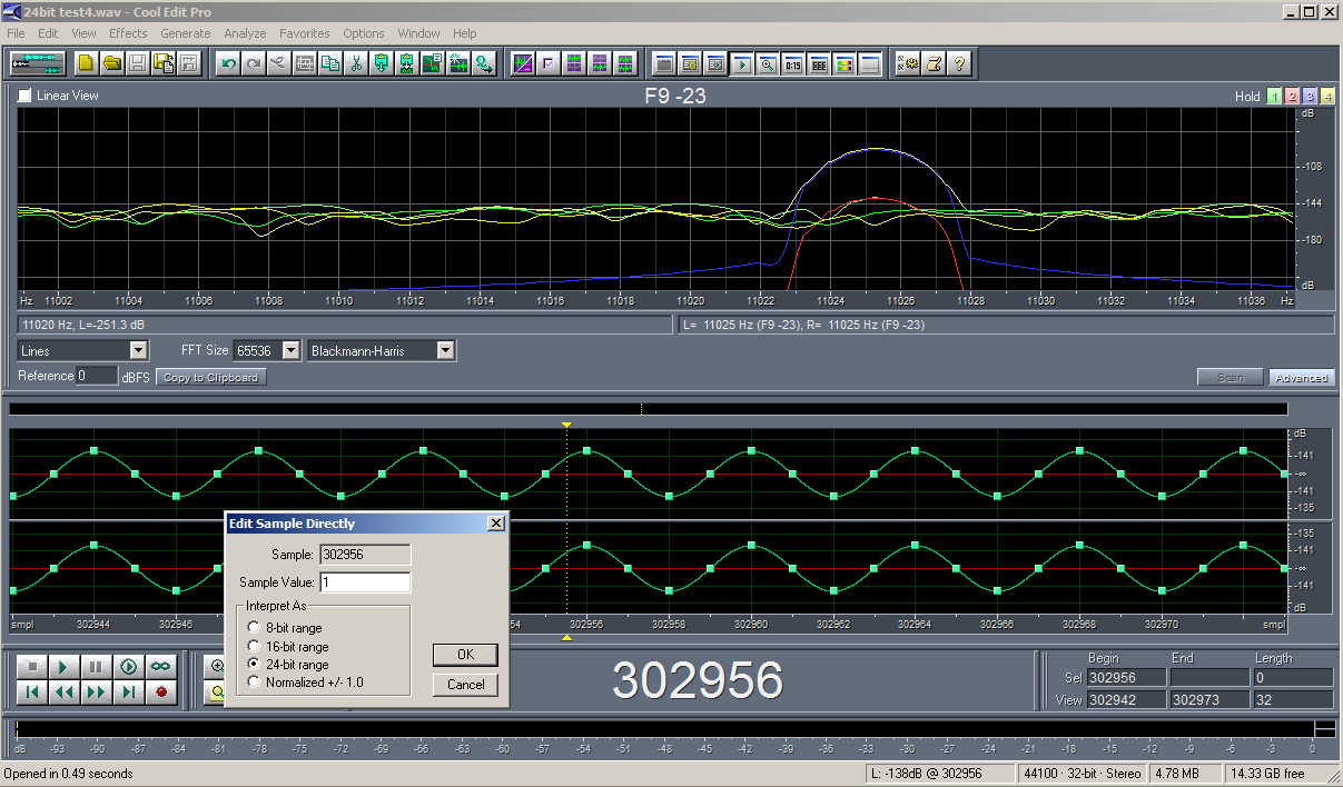

Verifying low bits may be accomplished many ways. In Cool Edit creating such test waveforms is straight forward:
![24bit v 16bit.png 24bit v 16bit.png](https://www.diyaudio.com/community/data/attachments/476/476917-71dda893c806119a37fe5d29ff0d09ee.jpg)
In above picture waveform is shown by alternating low bit for 24bit depth +/- 1, interspersed with 0 values to get 11025Hz sine wave with sample rate 44.1kHz. Waveform is looped back with JRiver playing output in one zone, and writing input to disk in another zone. Soundcard is E-MU 0404 USB with output max, and input gain at min. Process is repeated with low bit toggled for 16bit to generate 11025Hz sine.
Spectrum in above picture shows traces for test tracks and results. Clearly E-MU works as 24bit soundcard.

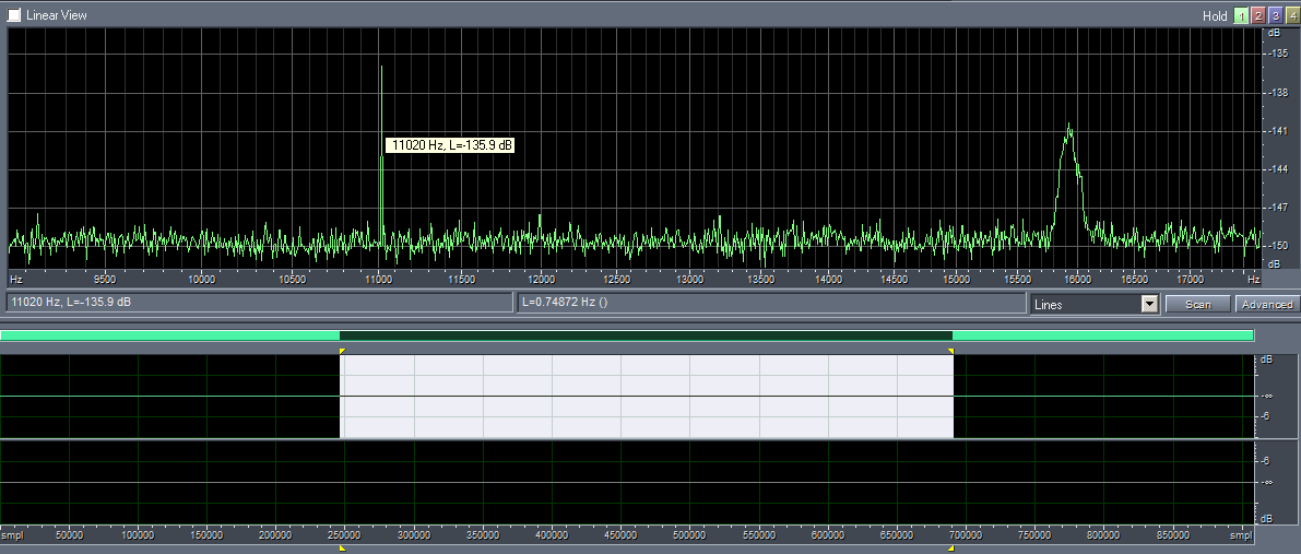

Spectrum of 24bit result with spectral averaging:
![24bit spectral average.png 24bit spectral average.png](https://www.diyaudio.com/community/data/attachments/476/476925-a7e8719320ff39ca2486039129bf1278.jpg)
System is Windows 7 professional.

That's were I started, my EMU 0204 worked fine under WinXP as did my Edirol UA5 10yr. ago.
I guess I could try JRiver demo and see, two instances of CoolEdit does not work for me under Win7, record instance is rail to rail garbage.
EDIT I'm slightly confused by your plots, usually there is no problem playing 24 bit data. Your first plot looks like the data you are sending to the DAC. Audacity for sure and Goldwave (it seems) do not record 24 bit data with any sound card (WASAPI a possible exception).
EDIT-EDIT Sorry I didn't see all the top traces in first plot.

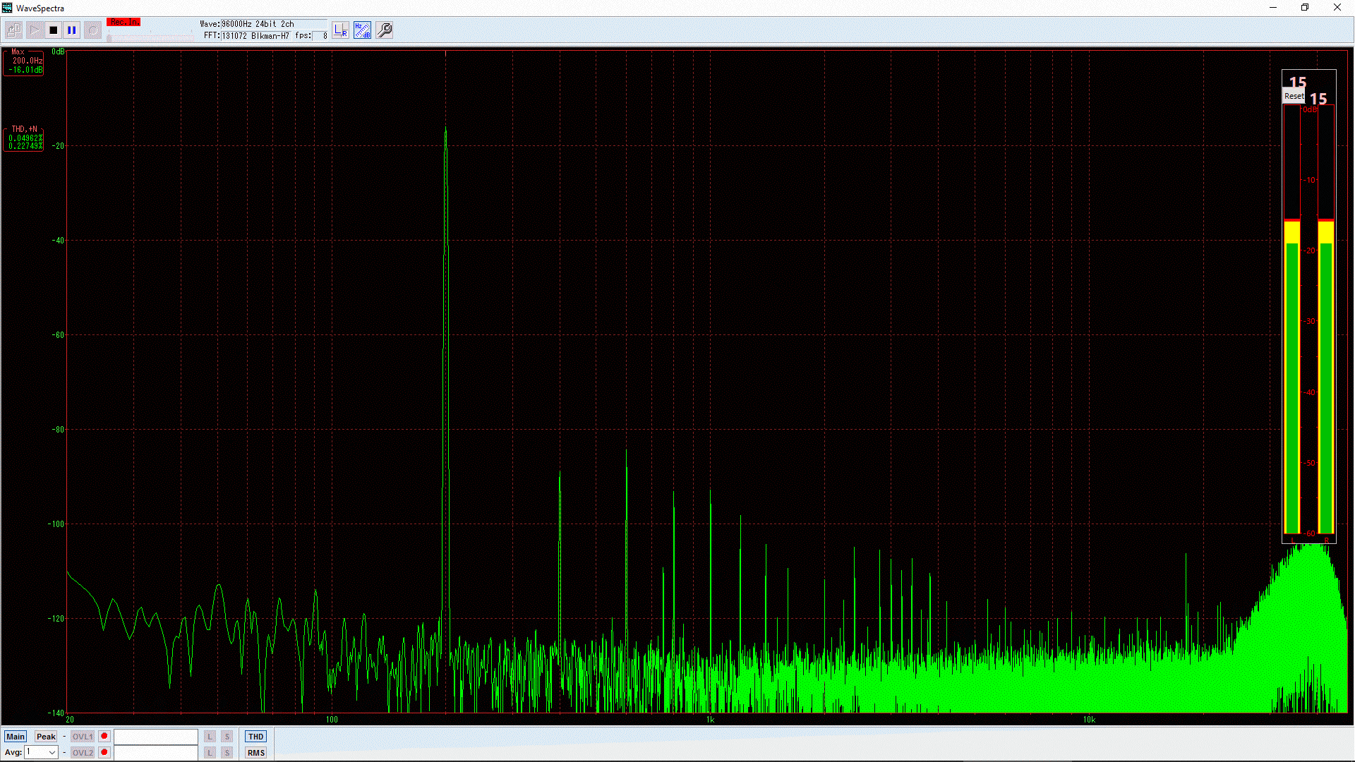

Since my day job requires regular audio monitoring and A/B comparisons a high quality IEM and DAC are part of the work kit. I also game online and recently picked up a USB Creative Sound Blaster E5 hoping to hit both with one device.
Consider these results as provisional because they seem too good to be true but the spectrum capture below was taken with a 6" unshielded jumper directly from headphone output to line input. The SB software has 'direct out' enabled.. The latter reads like an ASIO function and bypasses the internal effects DSP. The spectrum is a mess when direct isn't enabled, even with the DSP presumably bypassed. That spectrum also included.
Tech notes: interfaces are set to 24/96, software is Wavespectra, weighting Harris-Blackman 7 term, input level -20 dBfs, output -15 dBfs which is in the range of best performance.

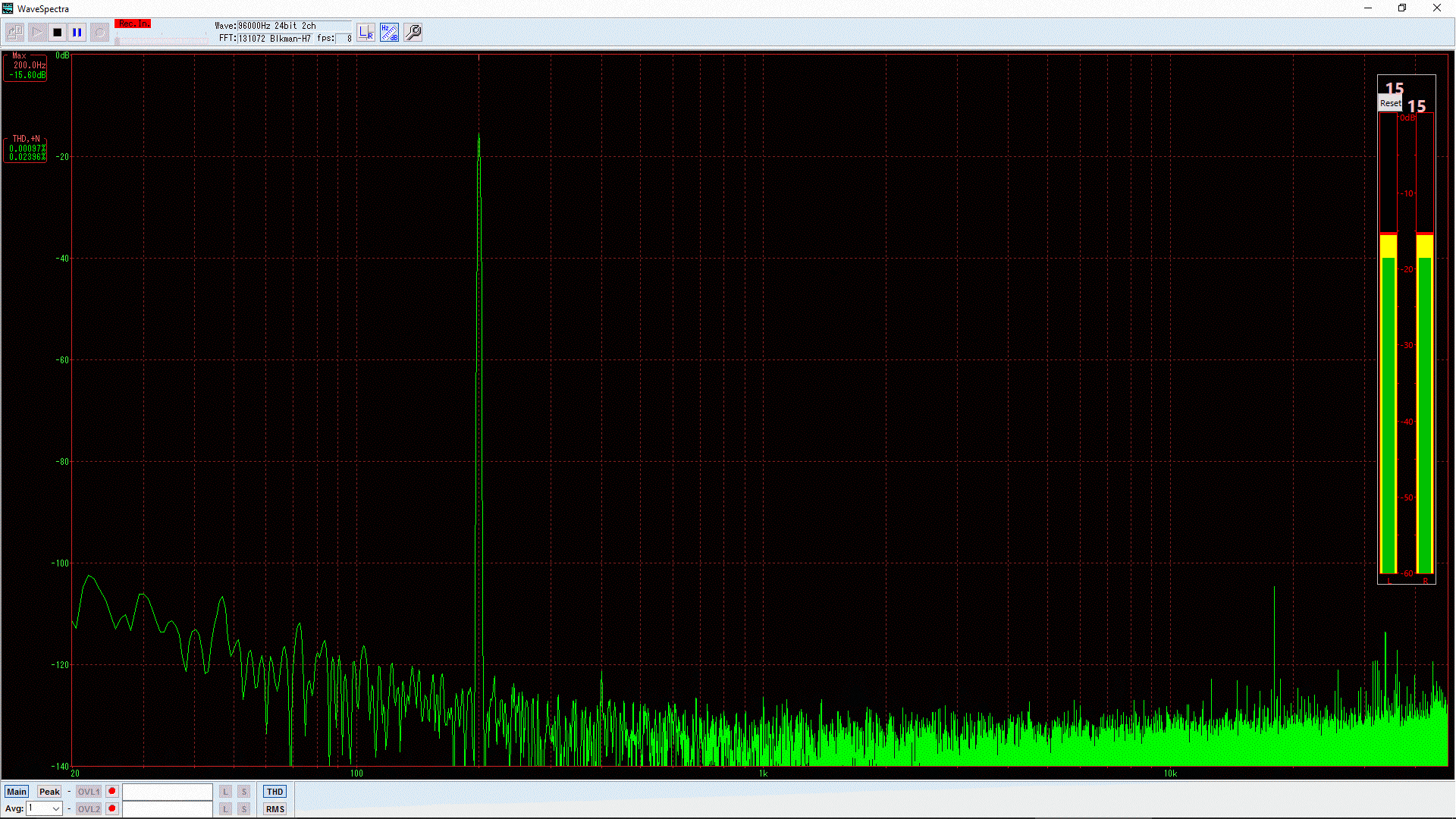

We run a 24-bit audio-over-IP network at work. My desktop interface to the network is a software emulated sound card. The spectra displayed by Wavespectra of a software generated sine wave - so no AD, DA or essentially any audio hardware in the loop - is a near perfect spike to the noise floor, -130 to -140 by memory. I'm pretty comfortable with its results.
