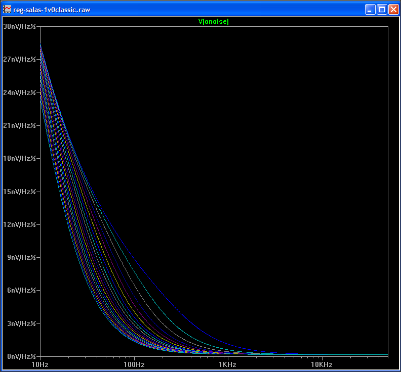

The Leds Vref bypass capacitor is directly affecting noise filtering. Depends on how sensitive the application is to that. A line buffer obviously is much more indifferent than a 1500 times gain MC phono stage, a clock is susceptible to very low frequency noise etc. Here is a stepped noise simulation for 5uF to 100uF (more capacitance as you go to the left most curve). The output one don't touch it, it is calculated as it is for stability.

but from simulation I see that noise level Is already very low
can we perceive difference 5 uF and 100 uF

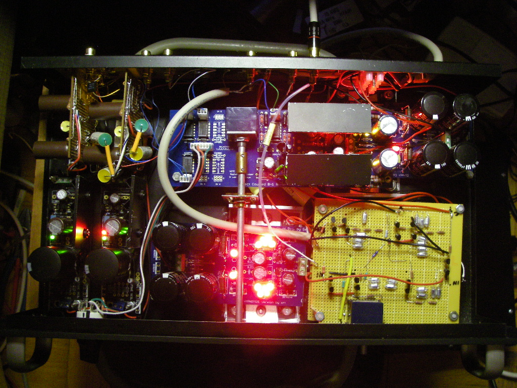

I finished my year long project: Salas simple phono pre amp, Mesmerize DCB1, and 24db/octave 2 way crossover powered by 2 Hypnotize regulators all in the same box.
The link below will take you to the design and my implementation.
The box just kept getting smaller and smaller as this project continued.
http://www.diyaudio.com/forums/pass-labs/156094-b1-active-crossover-26.html#post3185663
Thank you Salas for your designs and all your help and the helpful posts of each builder.
I am very happy with how it sounds.

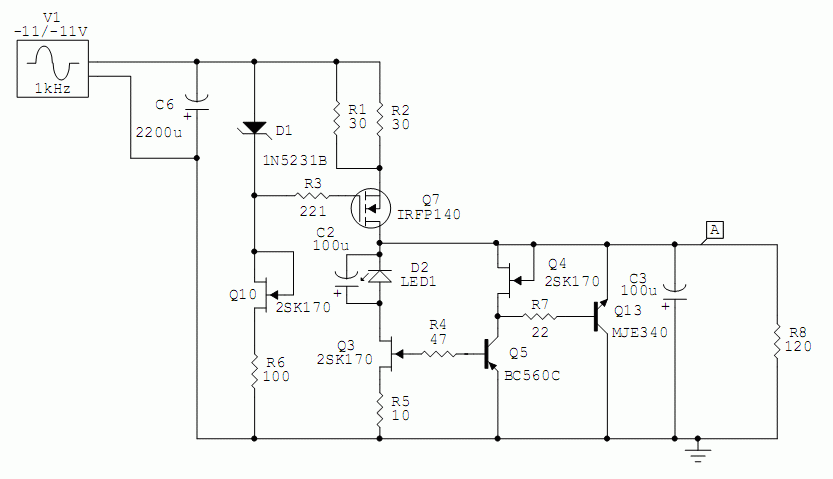

If I use separate external full wave rectification and separate transformers to supply +28VD and -8VDC to the regulators' inputs, can I get 24VDC and -3.3VDC regulated outputs? I have the Mezmerize version by crt.
24VDC should of course be no problem, but will I have to make the negative output lower in voltage? Like -5VDC regulated, and then bring the voltage down with an additional CRC filter, or can I get -3.3V directly?
You may try -3.3V directly by substituting an NPN pin compatible BJT in the place of the output Mosfet. That will be rather safe for stability after changing the gate resistor to an order of magnitude lower for base stopper and using one of the better beta transistors. I would make sure all is quiet by looking at that rail with the scope. The Vref area should be calculated at 0.6Vbe+IxR in its JFEt tail resistor plus a red led and a diode or so. See post 1. Whatever brings 3.3V total across in other words. From your available Vin to Vout stated its a bit tight though, don't know if your mains would stay there always. The reg can regulate LDO style, its just the CCS it will not be at its best without a good margin of input to output voltage.
Better use 3 red LED instead of a Zener in the CCS. Less noisy.
