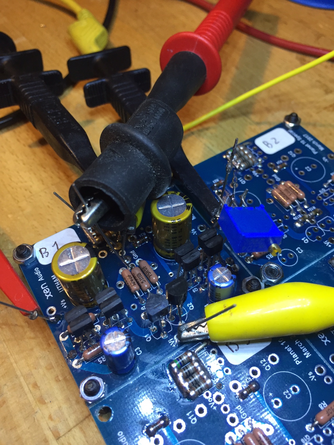

Finally I assembled two channels and I am trimming the first one. I have the configuration with All FET NGF, single power supply. Here are my questions:
1) What voltage should I use ? Can I go straight to 24 V ?
2) How close to zero R11 should be +- 5mV is enough or should I be more obsessive ?
I did not solder the output devices yet. Some porn later on.
Thanks,
Davide
D
I used +/-24V with current limit during test.
But it will work well enough still at say +/-15V to allow you to check things as a first start.
Eventually you need to run it at operating voltage to trim DC offsets, etc.
For trimming R11, I would aim at < +/-10mV minimum, 5mV preferred.
After that you need to trim the power devices using the two biasing resistors.
Patrick
So,
First channel is running. I still have to adjust the output devices. The offset set around 5mV without correction with a 190mA bias. The Jfet are 10 mA. One thing I noticed is that it took quite some time to settle. It started at +130mV, then went to -40mV and, in 40 minutes, went down to 5mV. Did other builders observed this ? The heatsink temperature settled at 34C. It was a bit cold in the room.
Davide
I don't have so much offset at the start.
But then I have only about 140mA bias.
So probably you need better coupling to the heatsink (I use Kerafol).
But a SHPP will protect your headphone against the 130mV.
Anything below 50mV is no issue IMHO.
I assume you use over-the-ear phones.
Patrick

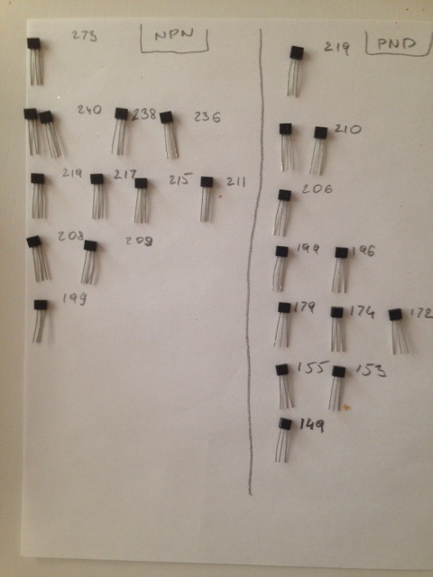

I might be late to the party here.
In fact I have ordered some SLHPA from Patrick just before the lockdown. Unfortunately most of my components for the SLHPA are at my work. I do not know when I will be able to get there so I took over UTHAiM from passive420. He was kind enough to sent the boards and the parts to my home address (not to the office!).
I have measured today the BJTs for the current mirrors.
I would appreciate if somebody could look at the numbers and advise whether I need a bigger pool. My understanding is that I could get away with less precisely matched pairs in a quad in the cascode positions.
But please let me know if you think the values are all over the place...
PS I have done pairs matching before, getting quads seems to be more difficult...
