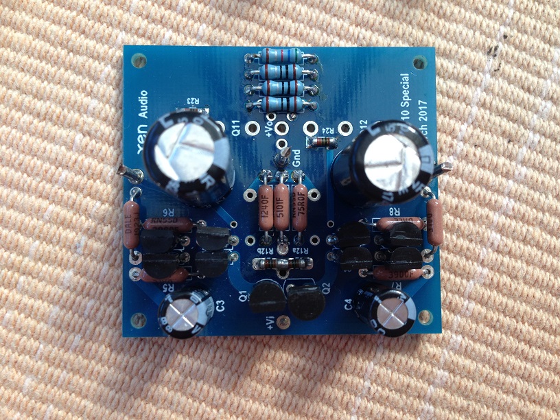

Hi Patrick,
These are ZTX851 and ZTX951.
I would not bet that these hFEs precise in the absolute sense. Every DMM I have shows different values. Actually two are pretty close one is a bit off. What I made sure of is that I compare values coming from the same multimeter.
Since you asked about the devices I will take the liberty of asking whether I could get away with less powerful ztx something like ztx450/550? ZTX851/951 strike me as very powerful in this application. I still would prefer to go for e-line packages as they fit better on the boards.
I would prefer not to use NFB.
BC327-40/BC337-40 sorted.
I started with 30 of each. Got a few decent quads but N too far from P. I figured out that it was N which was way too far from the mean so I got 100 more of Ns. These N's were pretty boring to measure. All close to the same value with a few outliers.
The added value of this project for me is that I read a lot about current mirrors and why 3/4 transistor version is better than a simple mirror.
I guess it is EUVL's way of doing things: you need a current mirror: ah! there you go: you need a matched quad.
I am very slow but it is shaping up.
I read that the version with FET current mirrors should be run with +-24V.
Given that I am using BJT mirrors shall I lower the voltages by say 3V?
In principle everything should be within acceptable conditions with BJTs but I better ask.

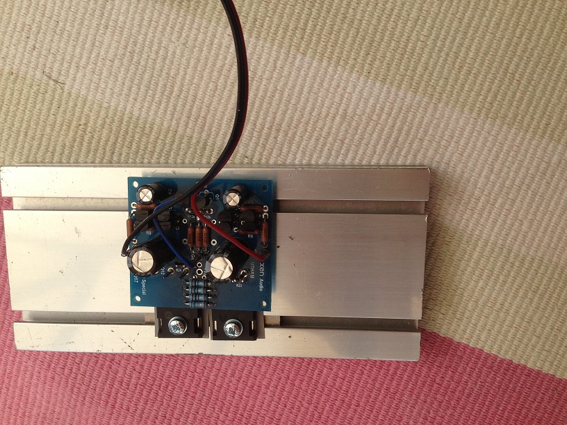

Today I installed the output laterals.
I spent loooong hours trimming the output stage. I am happy with final result: both channels within +/-10mV.
People building this amp here are way more knowledgeable then I am.
So below part is for the benefit of those who are more challenged by this design.
I will repeat something which Partick has mentioned here many times: make sure you understand the circuit and what you are doing.
I thought I did my homework, but not well enough it seems. I was confused about the values of IV converter R21 and R22 in the BOM (124 and 75Ohm). Or to precise I was not brave enough to question these values as initial values for trimming, I was more willing to question my own Vgs measurements.
Well the doc says CLEARLY how to calculate those given Vgs and Ijfet. I could not justify the values in the BOM (and I use different FETs) but still went ahead to try it on a live amp!
After fiddling around I understood, that this is never going to work and went back to my calculations! The result is above. The problem was that I had to trim my own output stage, with my own FETs not Patrick's even if he is a guru.
This is not to criticise Patrick's great design, nor the doc. The doc is in fact excellent! The problem is in the chair, as usual.

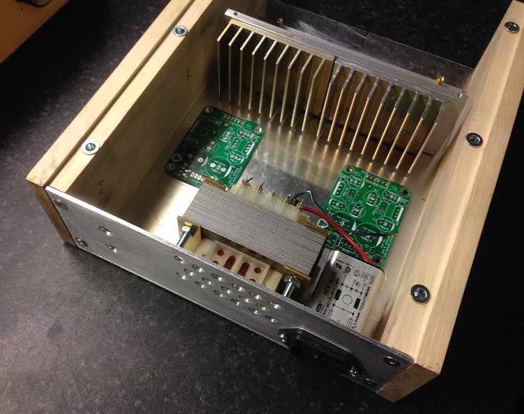

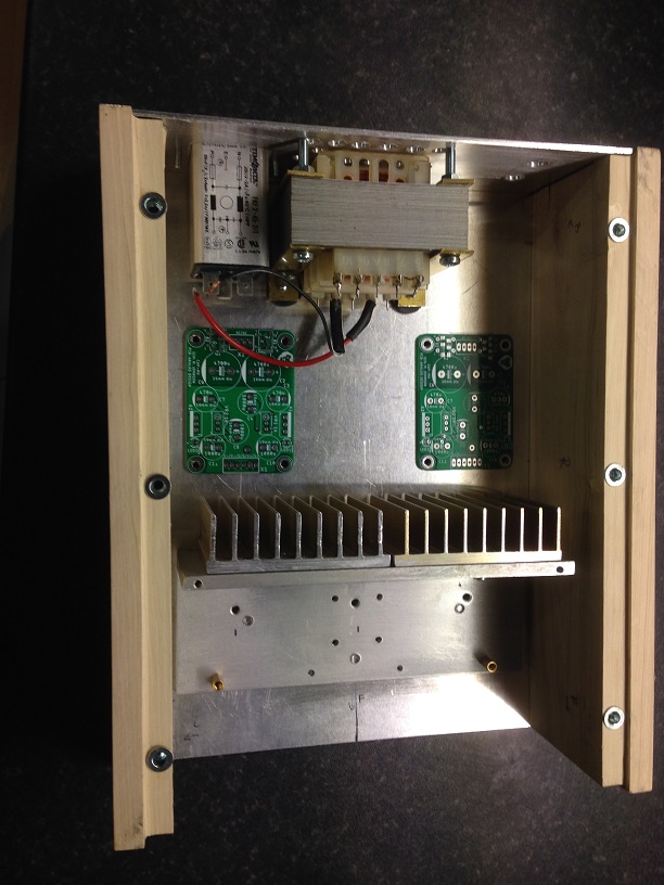

The chassis is taking shape.
I wish I had the skills and tools to produce what some other people are showing here.
Anyway this my poor mans humble rendition. Very similar to my Whammy. The only difference is that the front panel will be made out of wood not aluminium.
Initially I did not plan to use the socket with a RF filter, so now I ended up with PS boards very close to the high voltage terminals. I do not like it. I will have to see what can be done about it.
I need to check the required distance between 240V terminals and other circuity. Maybe a small division wall will suffice. Edit: Checked the requirements re mains voltage. I am fine, it will be just awkward to disconnect the cables from the filter...
As you can see there are many metal outer parts. They all be connected to the filter earth.
