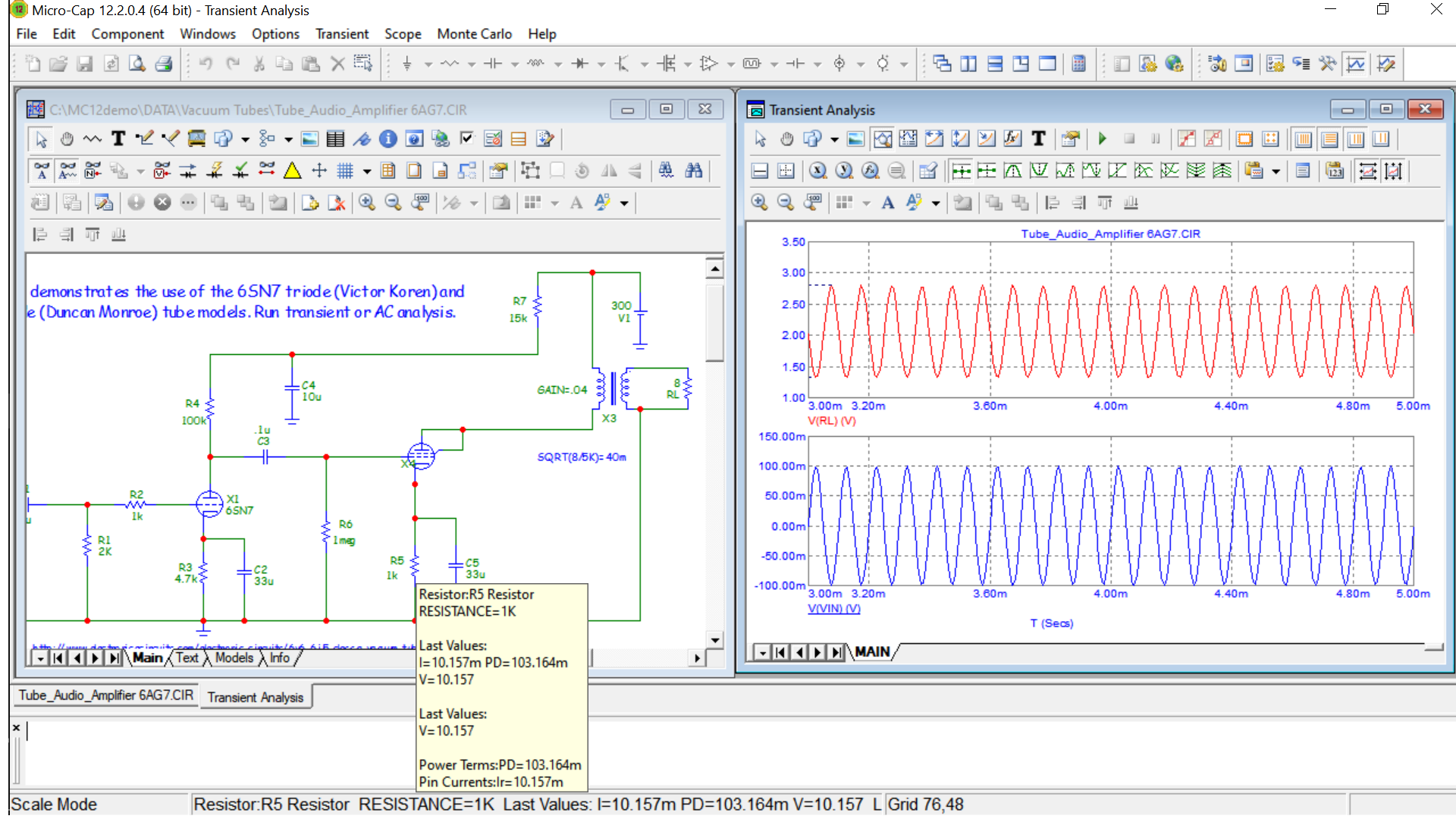

Here is update for 6AG7_GE, briefly tested ok in MicroCap.

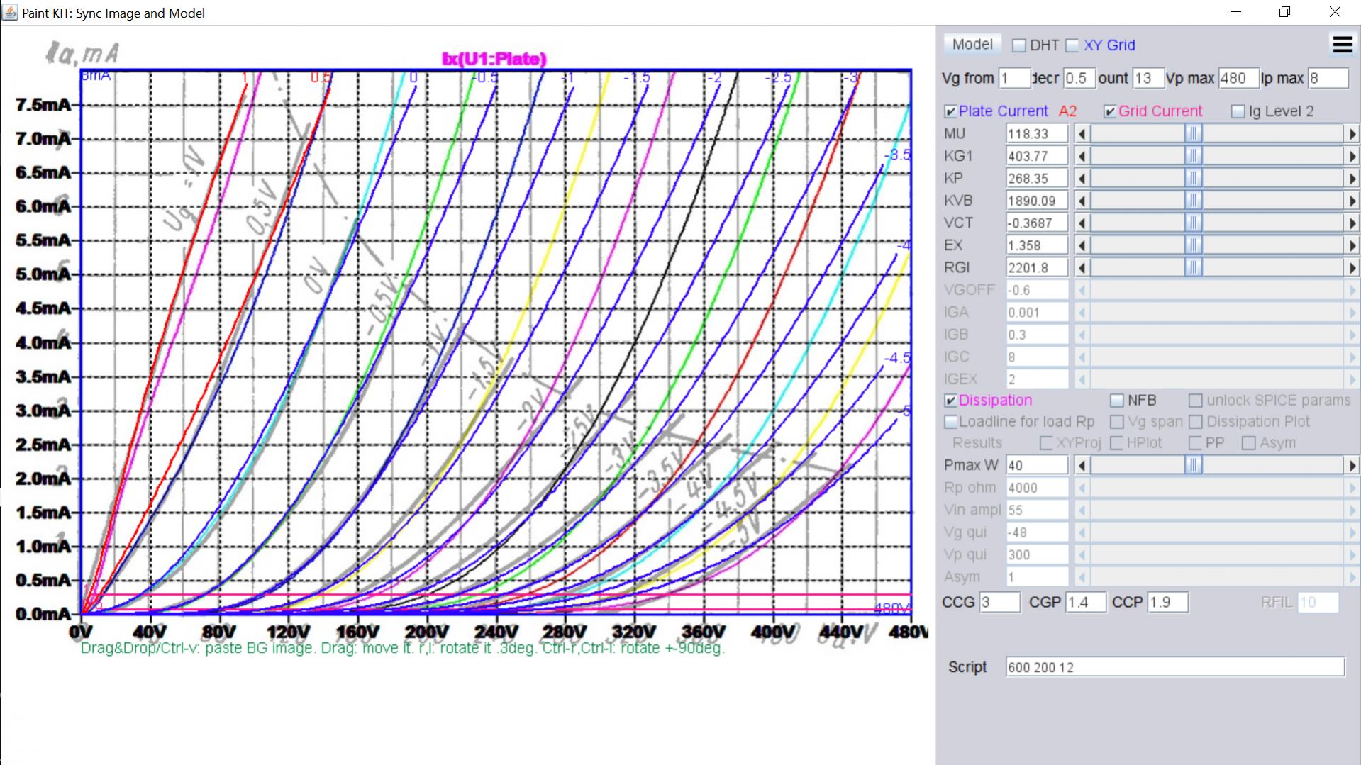

You need Paint Tool Kit to modify it properly so that you can see how it looks like when you altering. If you know how to use it then you still need the original image curve. Once open you can paste the model file I posted and update it and edit the params under "Advance Knee" then tested with MicroCap. You can disable others to see if the error goes away. Sometimes change "Knee" to "Advance Knee" or "Kink" will work but the model will be out of fit so it is not so accurate any more.

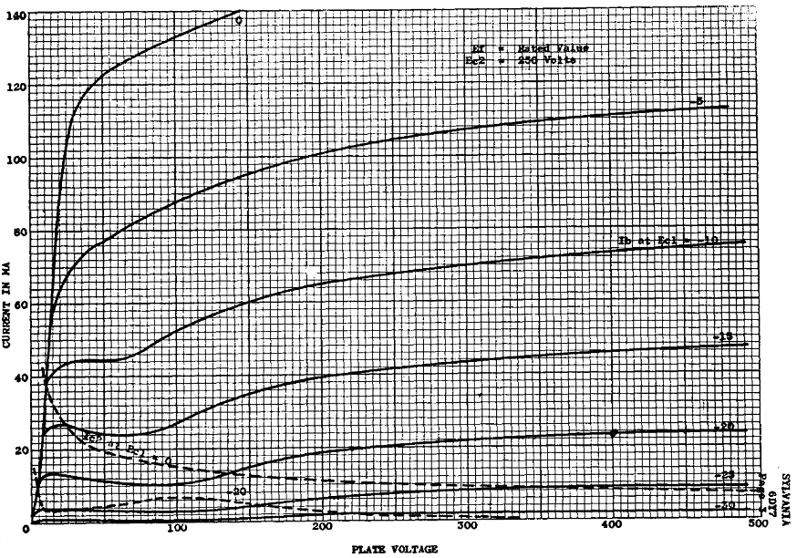

I have all the data curves, here is 6DY7, if you want to go ahead. The other way is try to use Adrian's model see it solves your problem. I have tried but need to clean out so many comment lines that cause errors in MicroCap, unless he can provides a clean copy for testing it would be more affirmative.

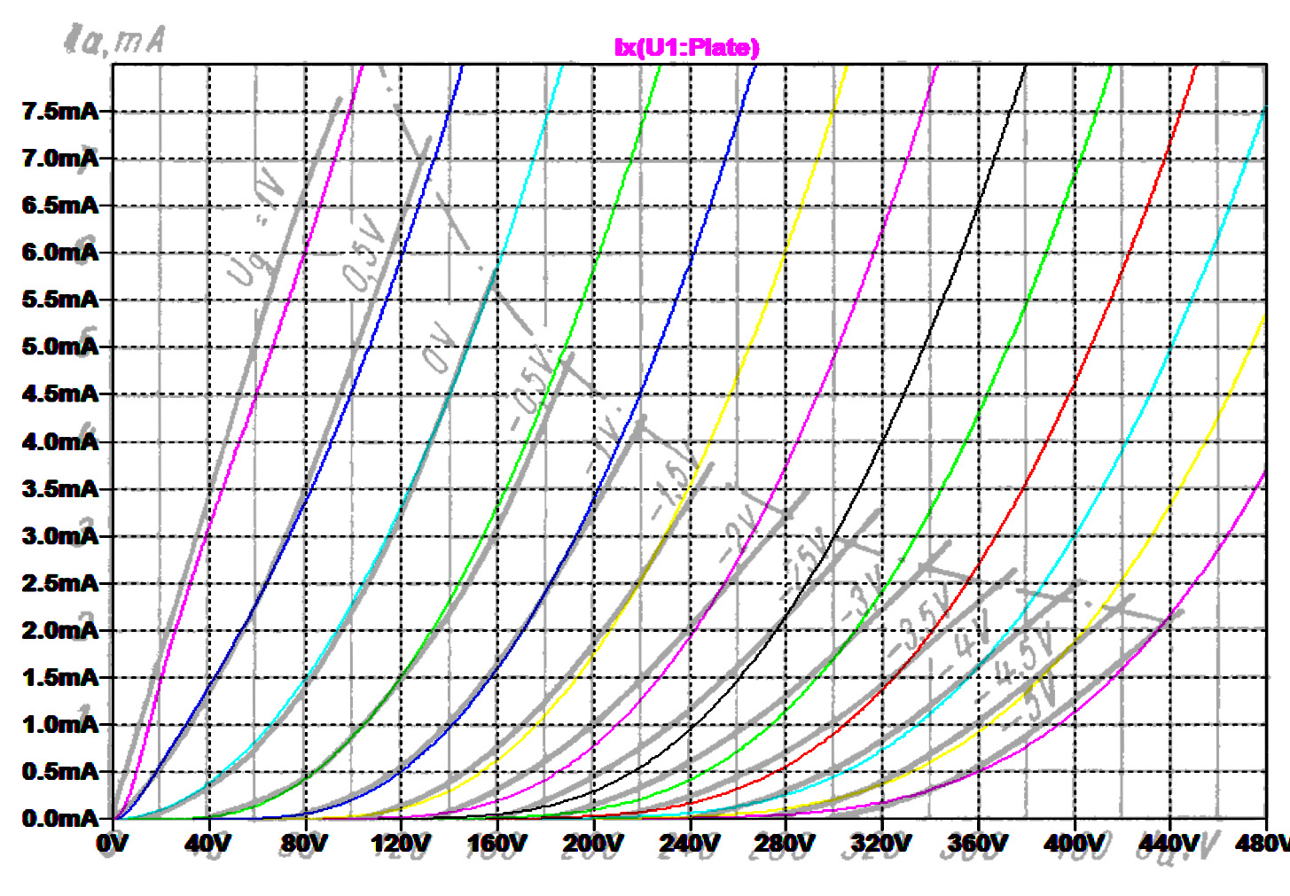

Hi all,
here my approach for the 6AG7 model. I do not have MC on my Mac, so I could not test whether it works in MC. Just let me know.

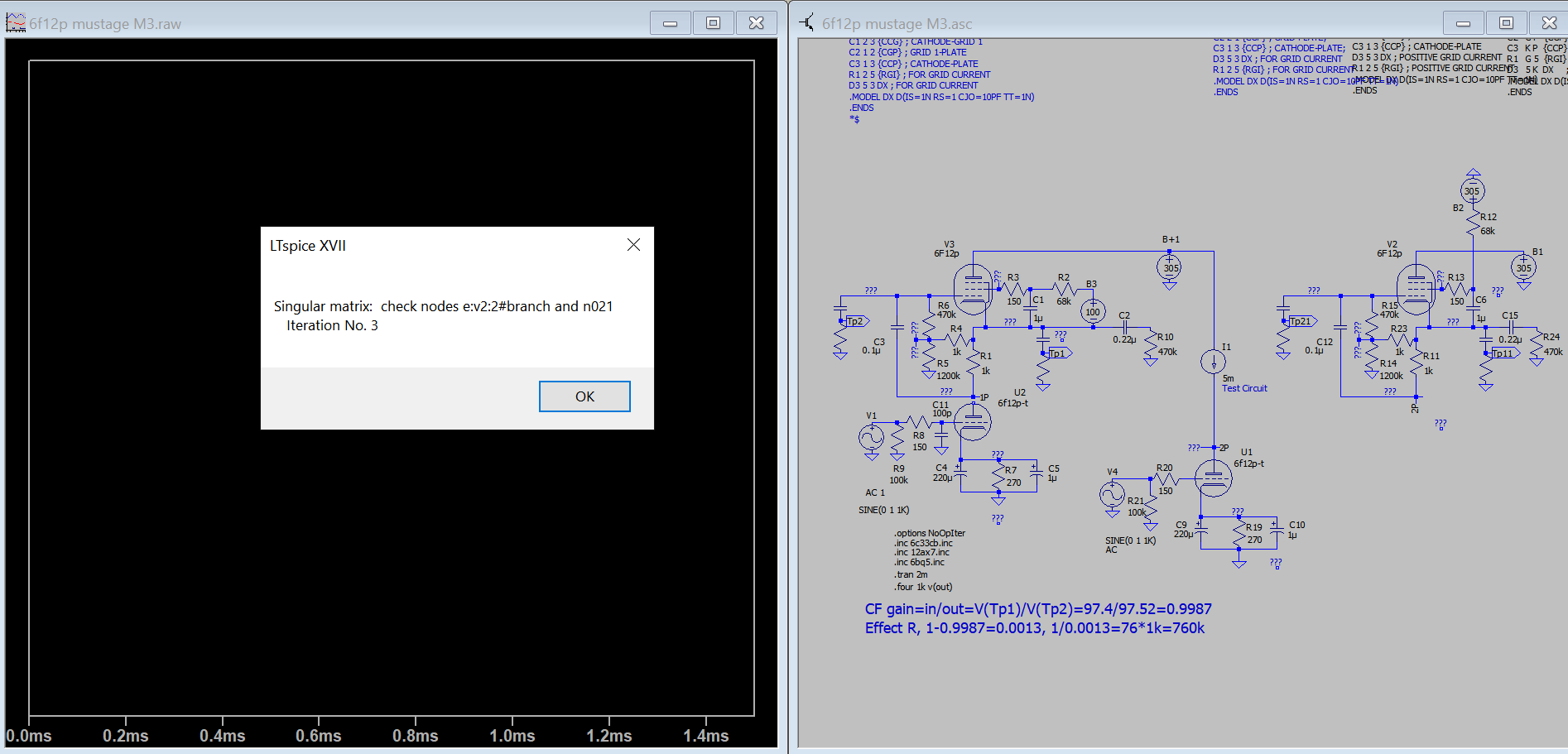

Unfortunately it still gives me errors (Part and node have the same name X1 G2)
Yes, that is a only warning, it will continue to sim. Some are real errors like "Matrix is singular", I can't solve it, and it also appears in LTspice. These models using "Advance Knee" options is a little too much for Spice program to handle as explained in the errors messages of MicroCap.
It continues to sim (really there is no possibility to use the Probe), but it gives busted values anyway...
it seems that all the nodes are the same.
I got the same warning but data appears ok. The following my .Option file:

Hi people, happy holidays to all of you! I tried to make 6N17B-V model using triode paint tools. I know this is far from perfect, but after two hours of clicking and tweaking, I can't make it better. Any help appreciated. 🙂
Code:.SUBCKT 6N17B_V 1 2 3 ; Plate Grid Cathode + PARAMS: CCG=3P CGP=1.4P CCP=1.9P RGI=2000 + MU=87 KG1=1196 KP=277.2 KVB=418.6 VCT=0.0122 EX=1.996 * Vp_MAX=480 Ip_MAX=8 Vg_step=0.5 Vg_start=1 Vg_count=13 * Rp=4000 Vg_ac=55 P_max=0.9 Vg_qui=-48 Vp_qui=300 * X_MIN=307 Y_MIN=240 X_SIZE=1303 Y_SIZE=849 FSZ_X=2578 FSZ_Y=1458 XYGrid=true * showLoadLine=y showIp=y isDHT=n isPP=n isAsymPP=n showDissipLimit=y * showIg1=n gridLevel2=n isInputSnapped=n * XYProjections=n harmonicPlot=n dissipPlot=n *---------------------------------------------------------------------------------- E1 7 0 VALUE={V(1,3)/KP*LOG(1+EXP(KP*(1/MU+(VCT+V(2,3))/SQRT(KVB+V(1,3)*V(1,3)))))} RE1 7 0 1G ; TO AVOID FLOATING NODES G1 1 3 VALUE={(PWR(V(7),EX)+PWRS(V(7),EX))/KG1} RCP 1 3 1G ; TO AVOID FLOATING NODES C1 2 3 {CCG} ; CATHODE-GRID C2 2 1 {CGP} ; GRID=PLATE C3 1 3 {CCP} ; CATHODE-PLATE D3 5 3 DX ; POSITIVE GRID CURRENT R1 2 5 {RGI} ; POSITIVE GRID CURRENT .MODEL DX D(IS=1N RS=1 CJO=10PF TT=1N) .ENDS *$
I increased the Mu to (100+) get better fit. In circuit, the Mu is less (60-88)
Code:
**** 6N17B ******************************************
* Created on 12/29/2020 00:08 using paint_kit.jar 3.1
* [URL="http://www.dmitrynizh.com/tubeparams_image.htm"]www.dmitrynizh.com/tubeparams_image.htm[/URL]
* Plate Curves image file: 6n17b.jpg
* Data source link:
.SUBCKT TRIODE_6N17B 1 2 3 ; Plate Grid Cathode
+ PARAMS: CCG=3P CGP=1.4P CCP=1.9P RGI=2201.8
+ MU=118.33 KG1=403.77 KP=268.35 KVB=1890.09 VCT=-0.3687 EX=1.358
* Rp=4000 Vg_ac=55 P_max=40 Vg_qui=-48 Vp_qui=300
* X_MIN=76 Y_MIN=42 X_SIZE=781 Y_SIZE=513 FSZ_X=1296 FSZ_Y=736 XYGrid=false
* showLoadLine=n showIp=y isDHT=n isPP=n isAsymPP=n showDissipLimit=y
* showIg1=y gridLevel2=n isInputSnapped=n
.ENDS
