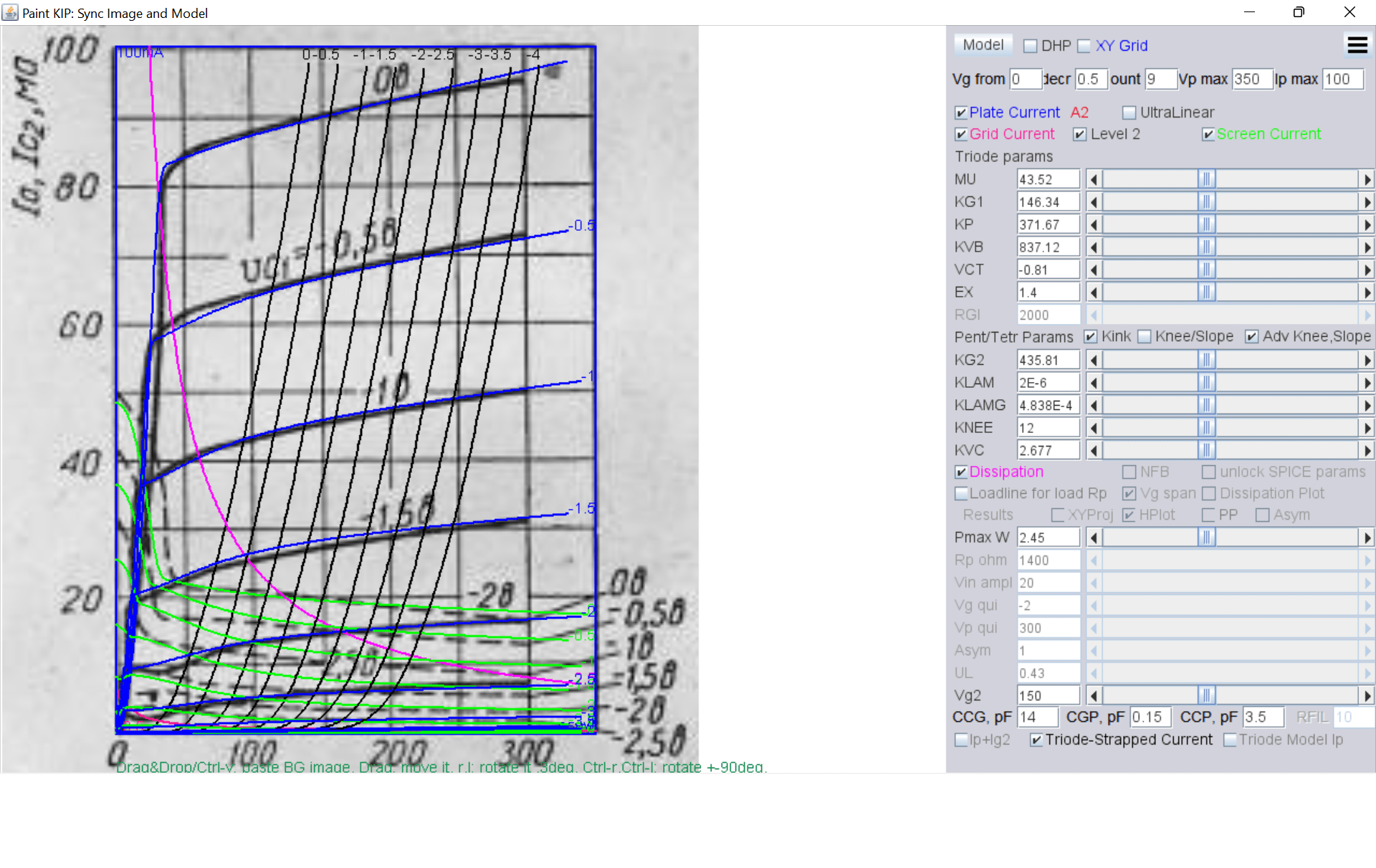

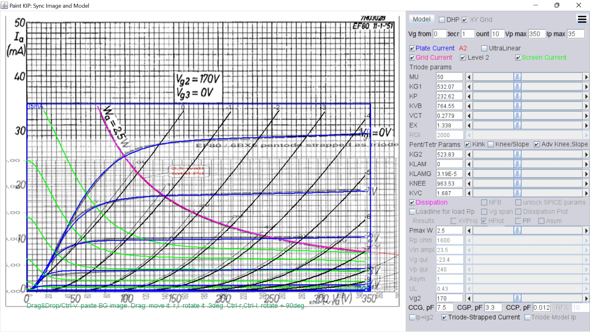

Try this EF80 (Philips) model:
Code:
**** EF80 ******************************************
* Created on 05/28/2022 00:14 using paint_kip.jar
* www.dmitrynizh.com/tubeparams_image.htm
* Plate Curves image file: ef80.png
* Data source link: <plate curves URL>
*-------------------------------------------------------------posted---------------------
.SUBCKT EF80 P G2 G K ; LTSpice tetrode.asy pinout
* .SUBCKT EF80 P G K G2 ; Koren Pentode Pspice pinout
+ PARAMS: MU=51.5 KG1=737.47 KP=186.79 KVB=1085.66 VCT=0.2779 EX=1.558 KG2=724.57 KNEE=963.53 KVC=1.795
+ KLAMG=1.102E-4 KD=118.44 KC=571.64 KR1=0.00625 KR2=0.1745 KVBG=0.008104 KB1=0.908 KB2=0.01702 KB3=0.00625 KB4=3.442 KVBGI=0.04391 KNK=0.05906 KNG=1.122E-4 KNPL=0.3353 KNSL=0.07806 KNPR=621.29 KNSR=5.842E6
+ CCG=7.5P CGP=3.3P CCP=0.012P VGOFF=-0.6 IGA=3E-10 IGB=0.02556 IGC=20 IGEX=1.413
* Vp_MAX=350 Ip_MAX=35 Vg_step=1 Vg_start=0 Vg_count=10
* X_MIN=58 Y_MIN=202 X_SIZE=746 Y_SIZE=406 FSZ_X=1296 FSZ_Y=736 XYGrid=false
* Rp=1600 Vg_ac=23.5 P_max=2.5 Vg_qui=-23.4 Vp_qui=240
* showLoadLine=n showIp=y isDHP=n isPP=n isAsymPP=n isUL=n showDissipLimit=y
* showIg1=y isInputSnapped=n addLocalNFB=n
* XYProjections=n harmonicPlot=y dissipPlot=n
* UL=0.43 EG2=170 gridLevel2=y addKink=y isTanhKnee=n advSigmoid=y
RE1 7 0 1G ; DUMMY SO NODE 7 HAS 2 CONNECTIONS
E1 7 0 VALUE= ; E1 BREAKS UP LONG EQUATION FOR G1.
+{V(G2,K)/KP*LOG(1+EXP((1/MU+(VCT+V(G,K))/SQRT(KVB+V(G2,K)*V(G2,K)))*KP))}
RE2 6 0 1G ; DUMMY SO NODE 6 HAS 2 CONNECTIONS
E2 6 0 VALUE={(PWR(V(7),EX)+PWRS(V(7),EX))} ; Kg1 times KIT current
E4 8 0 VALUE={V(P,K)/KNEE/(KVBGI+V(6)*KVBG)}
E5 81 0 VALUE={PWR(V(8),KB1)}
E6 82 0 VALUE={PWR(V(8),KB2)}
E7 83 0 VALUE={PWR(V(8),KB3)}
E8 9 0 VALUE={PWR(1-EXP(-V(81)*(KC+KR1*V(82))/(KD+KR2*V(83))),KB4)*1.5708}
RE4 8 0 1
RE5 81 0 1
RE6 82 0 1
RE7 83 0 1
RE8 9 0 1
RE21 21 0 1
E21 21 0 VALUE={V(6)/KG1*V(9)} ; Ip with knee but no slope and no kink
RE22 22 0 1 ; E22: kink curr deviation for plate
E22 22 0 VALUE={V(21)*LIMIT(KNK-V(G,K)*KNG,0,0.3)*(-ATAN((V(P,K)-KNPL)/KNSL)+ATAN((V(P,K)-KNPR)/KNSR))}
G1 P K VALUE={V(21)*(1+KLAMG*V(P,K)) + V(22)}
G2 G2 K VALUE={V(6)/KG2*(KVC-V(9))/(1+KLAMG*V(P,K)) - V(22)}
RCP P K 1G ; FOR CONVERGENCE
C1 K G {CCG} ; CATHODE-GRID 1
C2 G P {CGP} ; GRID 1-PLATE
C3 K P {CCP} ; CATHODE-PLATE
RE23 G 0 1G
GG G K VALUE={(IGA+IGB/(IGC+V(P,K)))*(MU/KG1)*
+(PWR(V(G,K)-VGOFF,IGEX)+PWRS(V(G,K)-VGOFF,IGEX))}
.ENDS

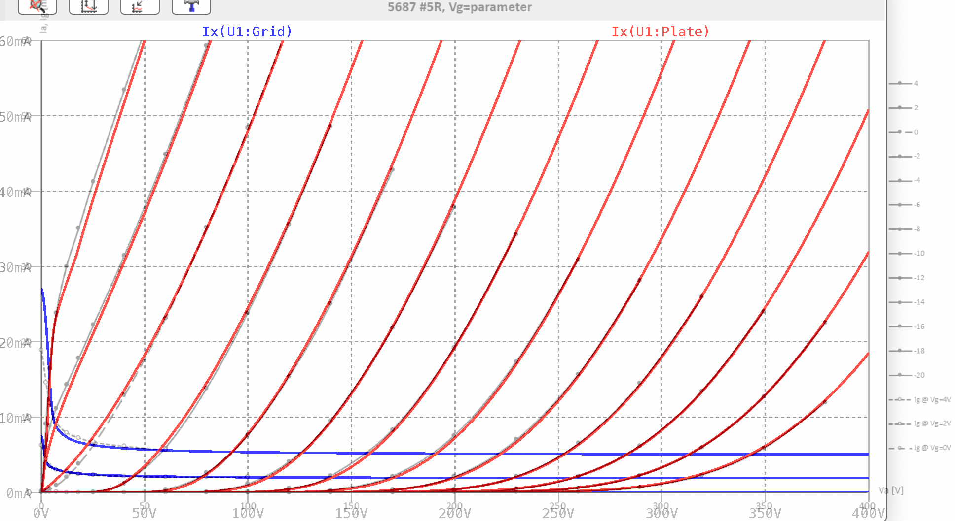

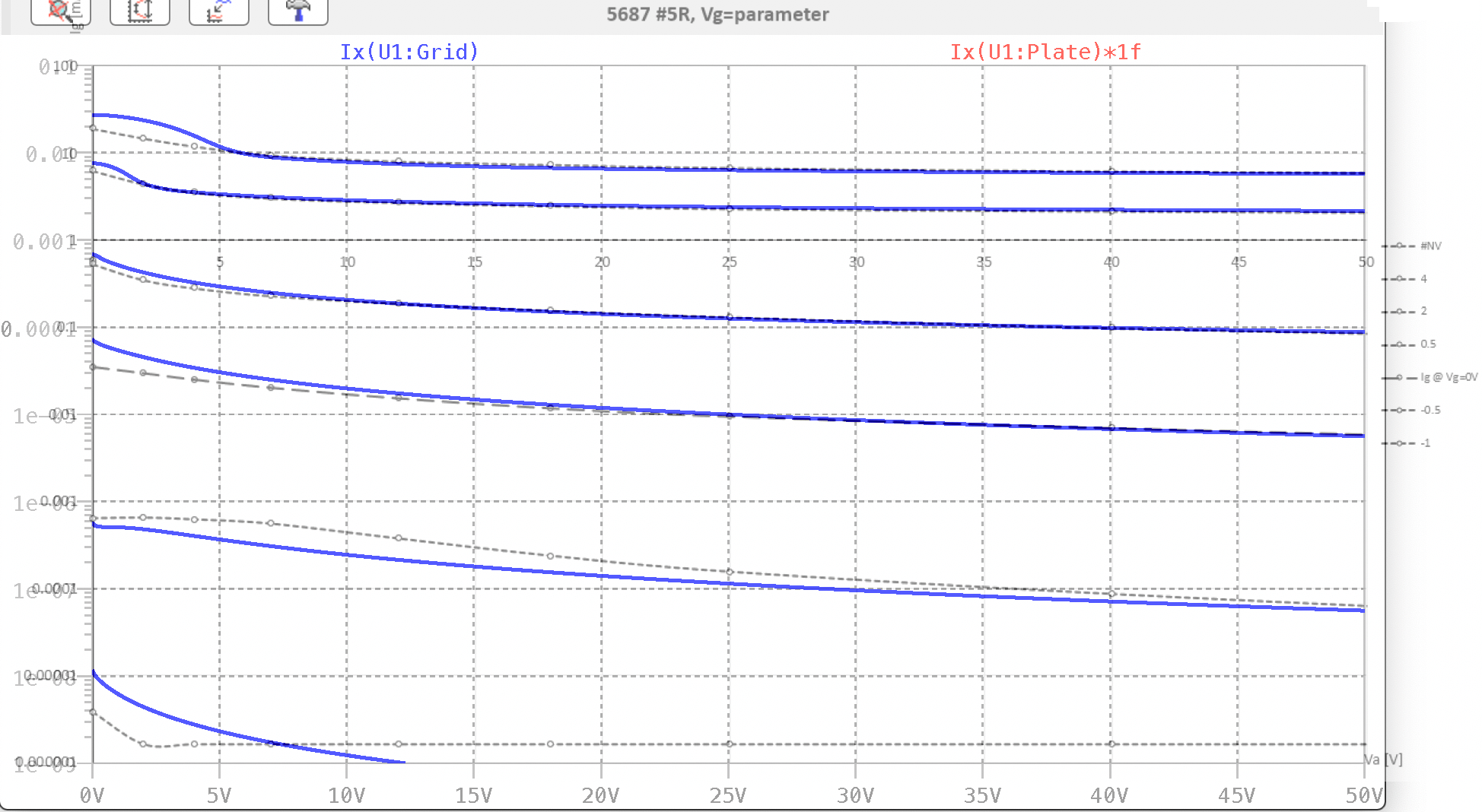

Hi all
Here a small gift for those who like strong twin triodes: A 5687.i5 spice model!
As always, the i5 model is fitted to the most representative triode out of 10, all burnt-in for 100 hours.
In the lot of 5 tubes, there were different brands (Sylavania, PhilipsECG and Tungsol) but all shared the same electrode construction. So, I did not distinguish between different brands for the model.
BR Adrian
BR Adrian
Code:
*5687 LTspice model based on the generic triode model from Adrian Immler, version i5
*A version log is at the end of this file
*100h BurnIn of 5 (Sylavania, PhilipsECG and Tungsol) tubes, sample selection and measurements done in April 2022
*Params fitted to the measured values by Adrian Immler, April 2022
*This model is accurate for Vg up to 4V, when Va is at least 5V.
*The high fit quality is presented at adrianimmler.simplesite.com
*History's best of tube describing art (plus some new ideas) is merged to this new approach.
*@ neg. Vg, Ia accuracy is similar to Koren models, and unrivaled for remote cutoff triodes
*@ small neg. Vg, the "Anlauf" current is considered.
*@ pos. Vg, Ig and Ia accuracy is on an unrivaled level (including neg. Va range!)
*This offers new simulation possibilities like grid resistor bias, backward plate modulated stages,
*Audion radio circuits, low voltage amps, guitar distortion stages or pulsed stages.
* i5 version. All 5687s seen share the same construction (so, no company letters needed)

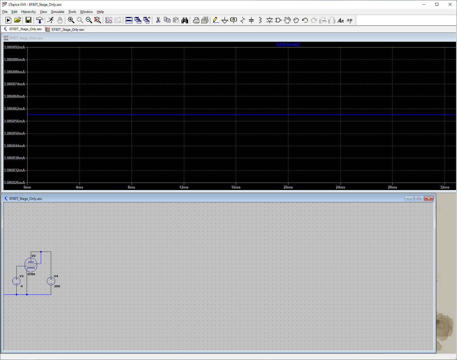

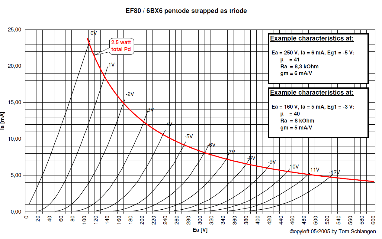

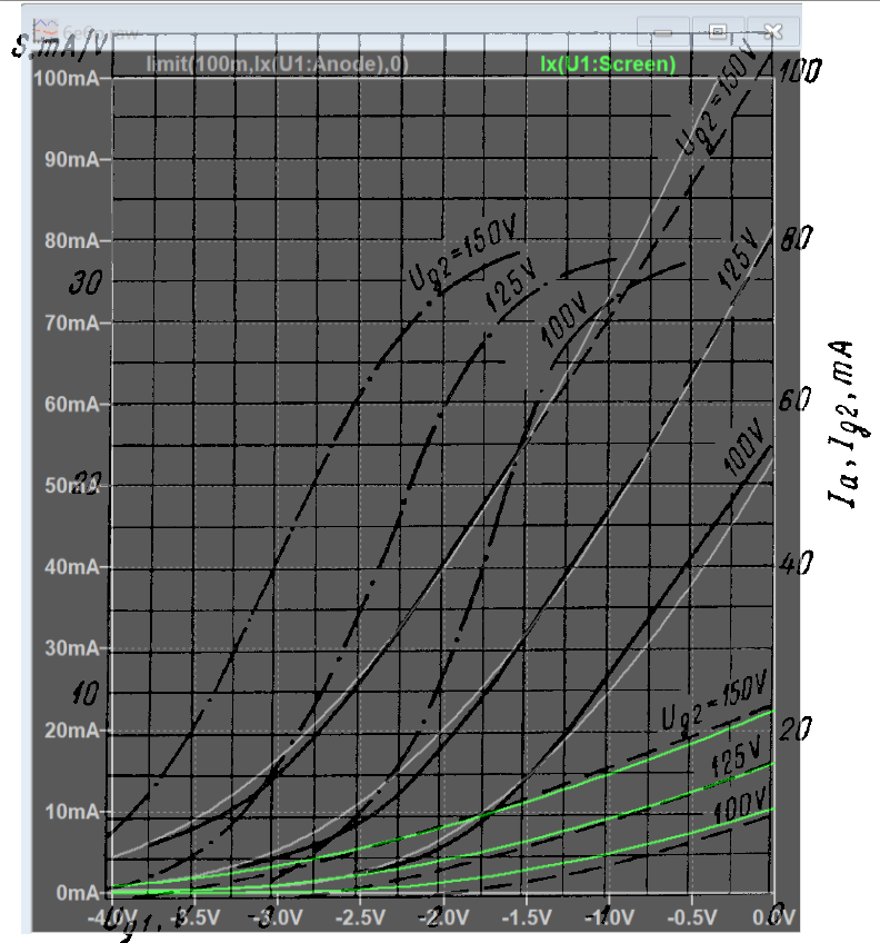

Apologies for my late feedback. I tried the model, but I get very different values compared to the curves in ef80_t.png. For example, the curves show 5mA for -4V bias and 200V plate voltage. I get 3mA:
Am I measuring this in the wrong way?
Thank you!
Jose

The anode current of ef80_t consists of Ia +Ig2, you should also add Ig2 to Ia, by adding a trace like this:I tried the model, but I get very different values compared to the curves in ef80_t.png. For example, the curves show 5mA for -4V bias and 200V plate voltage. I get 3mA:
Ix(U1:Anode)+Ix(U1:Screen)
Or add a common resistor of 1m and measure the current through it.
I got almost 4ma, the difference is due to curve produce from different brand or by sample curve from the tracer is different from original datasheet or sometimes due to limitation or errors in modeling or tracing, you don't get to see the pentode curve with tracer when if only triode curve is traced.
I must admit Paint tools has reached the limitation for this model. If I follow ef80_t curve, I would get a different transfer curve from original.
Yes, the same for me, especially regarding its beautiful glowing! 🙂(...) 5687 is one of my favorite tubes. (...)

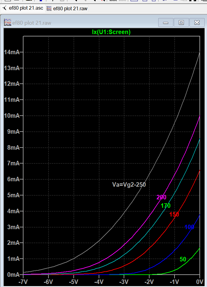

You are right, I should have measured the full current for triode mode, not just the plate. I get the same, as you, 3.8mA.The anode current of ef80_t consists of Ia +Ig2, you should also add Ig2 to Ia, by adding a trace like this:

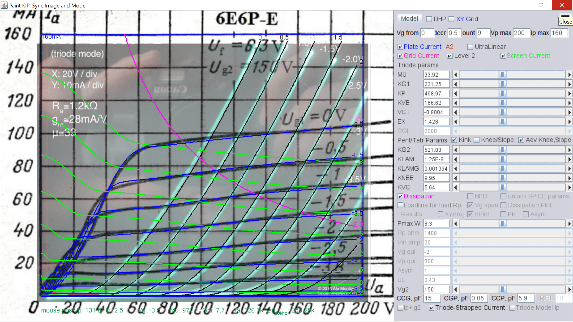

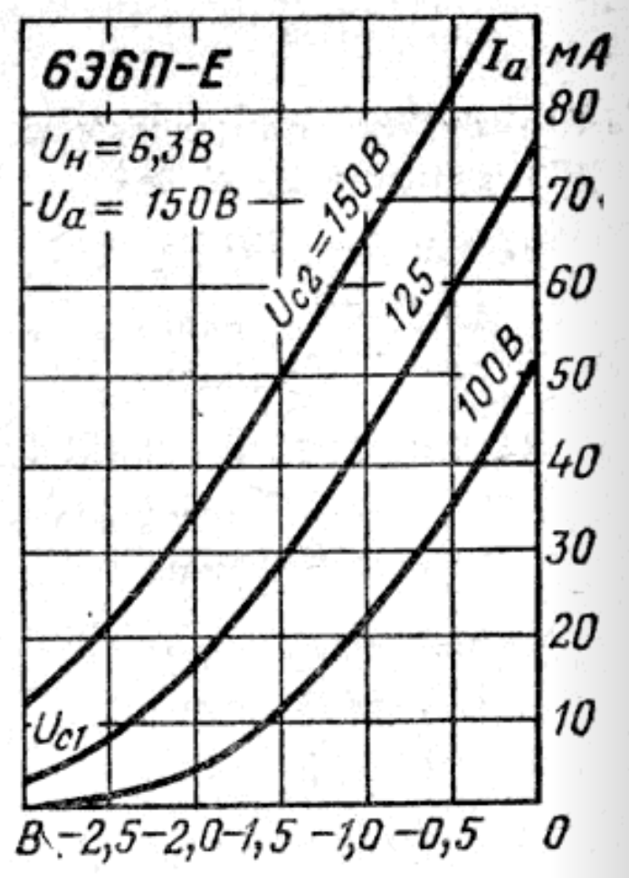

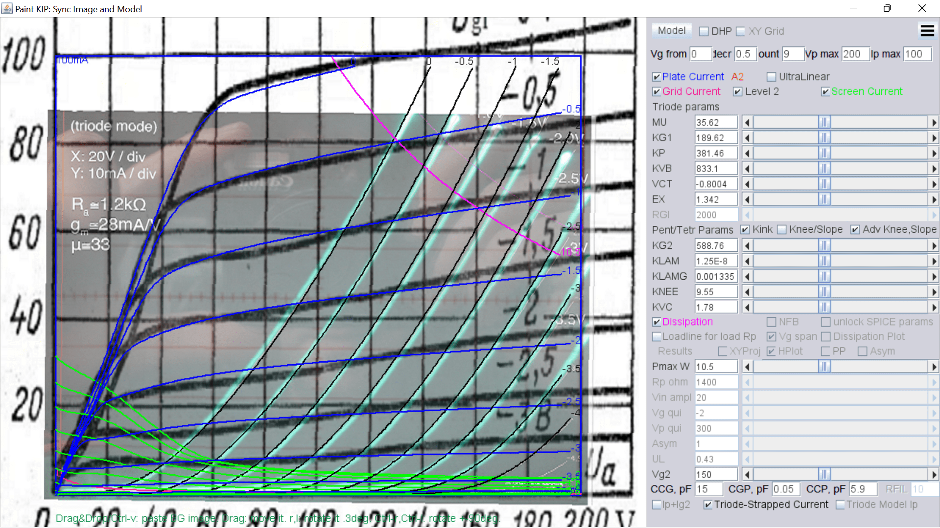

6e6p-e model, similar to 6e6p:
Code:
**** 6E6P_E ******************************************
* Created on 06/13/2022 18:29 using paint_kip.jar
* Plate Curves image file: 6e6p-e.png
.SUBCKT 6E6P_E P G2 G K ; LTSpice tetrode.asy pinout
* .SUBCKT 6E6P_E P G K G2 ; Koren Pentode Pspice pinout
+ PARAMS: MU=33.92 KG1=231.25 KP=468.97 KVB=166.62 VCT=-0.8004 EX=1.428 KG2=521.03 KNEE=9.95 KVC=5.64
+ KLAM=1.25E-8 KLAMG=0.001094 KD=2.641E12 KC=20884.66 KR1=1459.8 KR2=2.154E-4 KVBG=0.008671 KB1=4.793 KB2=5.371E-5 KB3=1.6 KB4=0.368 KVBGI=-0.01113 KNK=0.007938 KNG=0.06088 KNPL=0.000984 KNSL=167.95 KNPR=93.74 KNSR=40.76
+ CCG=15P CGP=0.05P CCP=5.9P VGOFF=-0.6 IGA=0.001 IGB=0.3 IGC=8 IGEX=2
* Vp_MAX=200 Ip_MAX=160 Vg_step=0.5 Vg_start=0 Vg_count=9
* X_MIN=92 Y_MIN=53 X_SIZE=719 Y_SIZE=586 FSZ_X=1296 FSZ_Y=736 XYGrid=false
* Rp=1400 Vg_ac=20 P_max=8.3 Vg_qui=-2 Vp_qui=300
* showIg1=y isInputSnapped=y addLocalNFB=n
* UL=0.43 EG2=150 gridLevel2=y addKink=y isTanhKnee=n advSigmoid=y
RE4 8 0 1
RE5 81 0 1
RE6 82 0 1
RE7 83 0 1
RE8 9 0 1
RE21 21 0 1
G1 P K VALUE={V(21)*(1+KLAMG*V(P,K))+KLAM*V(P,K) + V(22)}
RE23 G 0 1G
.ENDS

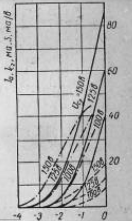

6e5p new model:
Code:
**** 6E5P ******************************************
* Created on 06/13/2022 22:03 using paint_kip.jar
* Plate Curves image file: 6e5p.png
.SUBCKT 6E5P P G2 G K ; LTSpice tetrode.asy pinout
* .SUBCKT 6E5P P G K G2 ; Koren Pentode Pspice pinout
+ PARAMS: MU=32.19 KG1=355.4 KP=224.68 KVB=69.42 VCT=-0.42 EX=1.688 KG2=1270.08 KNEE=10.86 KVC=2.987
+ KLAM=2E-6 KLAMG=0.000923 KD=653.37 KC=7196.6 KR1=1338.16 KR2=0.95 KVBG=0.4795 KB1=7.41 KB2=0.05 KB3=0.15 KB4=0.1527 KVBGI=-1.093 KNK=0.00178 KNG=0.02347 KNPL=0.4778 KNSL=0.001895 KNPR=56.55 KNSR=21.22
+ CCG=15P CGP=0.065P CCP=2.55P VGOFF=-0.6 IGA=0.001 IGB=0.3 IGC=8 IGEX=2
* Vp_MAX=240 Ip_MAX=130 Vg_step=0.5 Vg_start=0 Vg_count=9
* X_MIN=53 Y_MIN=25 X_SIZE=829 Y_SIZE=570 FSZ_X=1296 FSZ_Y=736 XYGrid=false
RE4 8 0 1
RE5 81 0 1
RE6 82 0 1
RE7 83 0 1
RE8 9 0 1
RE21 21 0 1
RE23 G 0 1G
.ENDS

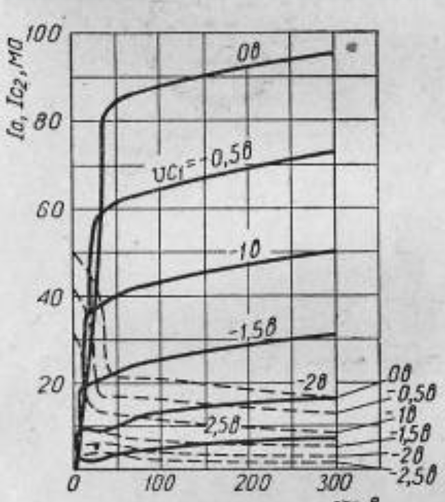

6e23p (6Ж23П) 6Zh23P model:
Code:
*** 6E23P *****************************posted************
* Created on 06/14/2022 07:49 using paint_kip.jar
* Plate Curves image file: 6e23p.png
.SUBCKT 6E23P P G2 G K ; LTSpice tetrode.asy pinout
* .SUBCKT 6E23P P G K G2 ; Koren Pentode Pspice pinout
+ PARAMS: MU=43.52 KG1=146.34 KP=371.67 KVB=837.12 VCT=-0.81 EX=1.4 KG2=435.81 KNEE=12 KVC=2.677
+ KLAM=2E-6 KLAMG=4.838E-4 KD=9.229E16 KC=2.441E-5 KR1=1.148E-7 KR2=0.6752 KVBG=6.385E-4 KB1=8.043 KB2=0.01173 KB3=0.0918 KB4=0.2806 KVBGI=6.747E-5 KNK=0.02125 KNG=0.08169 KNPL=1.872 KNSL=1.608 KNPR=40.08 KNSR=53.64
+ CCG=14P CGP=0.15P CCP=3.5P VGOFF=-0.6 IGA=0.001 IGB=0.3 IGC=8 IGEX=2
* Vp_MAX=350 Ip_MAX=100 Vg_step=0.5 Vg_start=0 Vg_count=9
* X_MIN=108 Y_MIN=20 X_SIZE=446 Y_SIZE=639 FSZ_X=1296 FSZ_Y=736 XYGrid=false
* Rp=1400 Vg_ac=20 P_max=2.45 Vg_qui=-2 Vp_qui=300
RE4 8 0 1
RE5 81 0 1
RE6 82 0 1
RE7 83 0 1
RE8 9 0 1
RE21 21 0 1
RE23 G 0 1G
.ENDS

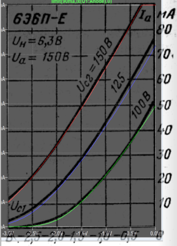

Here is correction of scale of 6e6p-e pentode mode:
** 6E6P_E *************************correction
Code:
Created on 06/15/2022 13:38 using paint_kip.jar www.dmitrynizh.com/tubeparams_image.htm Plate Curves image file: 6e6p-e.png Data source link: <plate curves URL> *---------------------------------------------------------------------------------- .SUBCKT 6E6P_E P G2 G K ; LTSpice tetrode.asy pinout * .SUBCKT 6E6P_E P G K G2 ; Koren Pentode Pspice pinout PARAMS: MU=35.62 KG1=189.62 KP=381.46 KVB=833.1 VCT=-0.8004 EX=1.342 KG2=588.76 KNEE=9.55 KVC=1.78 KLAM=1.25E-8 KLAMG=0.001335 KD=2.493E13 KC=3341.55 KR1=2580.93 KR2=3.533E-4 KVBG=0.004912 KB1=4.793 KB2=5.371E-5 KB3=1.6 KB4=0.1901 KVBGI=-1.022E-5 KNK=0.1727 KNG=0.1479 KNPL=0.00213 KNSL=17.2 KNPR=18.28 KNSR=26.21 CCG=15P CGP=0.05P CCP=5.9P VGOFF=-0.6 IGA=0.001 IGB=0.3 IGC=8 IGEX=2 Vp_MAX=200 Ip_MAX=100 Vg_step=0.5 Vg_start=0 Vg_count=9 X_MIN=76 Y_MIN=53 X_SIZE=715 Y_SIZE=599 FSZ_X=1296 FSZ_Y=736 XYGrid=false Rp=1400 Vg_ac=20 P_max=10.5 Vg_qui=-2 Vp_qui=300 showLoadLine=n showIp=y isDHP=n isPP=n isAsymPP=n isUL=n showDissipLimit=y showIg1=y isInputSnapped=y addLocalNFB=n XYProjections=n harmonicPlot=y dissipPlot=n UL=0.43 EG2=150 gridLevel2=y addKink=y isTanhKnee=n advSigmoid=y *---------------------------------------------------------------------------------- RE1 7 0 1G ; DUMMY SO NODE 7 HAS 2 CONNECTIONS E1 7 0 VALUE= ; E1 BREAKS UP LONG EQUATION FOR G1. +{V(G2,K)/KP*LOG(1+EXP((1/MU+(VCT+V(G,K))/SQRT(KVB+V(G2,K)*V(G2,K)))*KP))} RE2 6 0 1G ; DUMMY SO NODE 6 HAS 2 CONNECTIONS E2 6 0 VALUE={(PWR(V(7),EX)+PWRS(V(7),EX))} ; Kg1 times KIT current E4 8 0 VALUE={V(P,K)/KNEE/(KVBGI+V(6)*KVBG)} E5 81 0 VALUE={PWR(V(8),KB1)} E6 82 0 VALUE={PWR(V(8),KB2)} E7 83 0 VALUE={PWR(V(8),KB3)} E8 9 0 VALUE={PWR(1-EXP(-V(81)*(KC+KR1*V(82))/(KD+KR2*V(83))),KB4)*1.5708} RE4 8 0 1 RE5 81 0 1 RE6 82 0 1 RE7 83 0 1 RE8 9 0 1 RE21 21 0 1 E21 21 0 VALUE={V(6)/KG1*V(9)} ; Ip with knee but no slope and no kink RE22 22 0 1 ; E22: kink curr deviation for plate E22 22 0 VALUE={V(21)LIMIT(KNK-V(G,K)*KNG,0,0.3)(-ATAN((V(P,K)-KNPL)/KNSL)+ATAN((V(P,K)-KNPR)/KNSR))} G1 P K VALUE={V(21)*(1+KLAMG*V(P,K))+KLAM*V(P,K) + V(22)} G2 G2 K VALUE={V(6)/KG2*(KVC-V(9))/(1+KLAMG*V(P,K)) - V(22)} RCP P K 1G ; FOR CONVERGENCE C1 K G {CCG} ; CATHODE-GRID 1 C2 G P {CGP} ; GRID 1-PLATE C3 K P {CCP} ; CATHODE-PLATE RE23 G 0 1G GG G K VALUE={(IGA+IGB/(IGC+V(P,K)))(MU/KG1) +(PWR(V(G,K)-VGOFF,IGEX)+PWRS(V(G,K)-VGOFF,IGEX))} .ENDS *$
