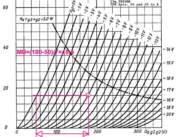

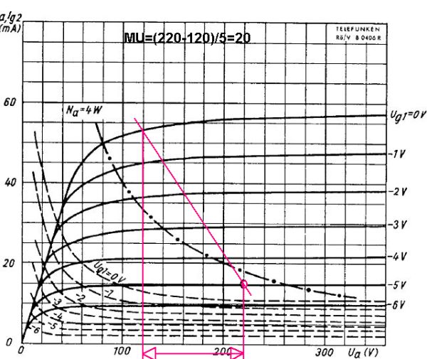

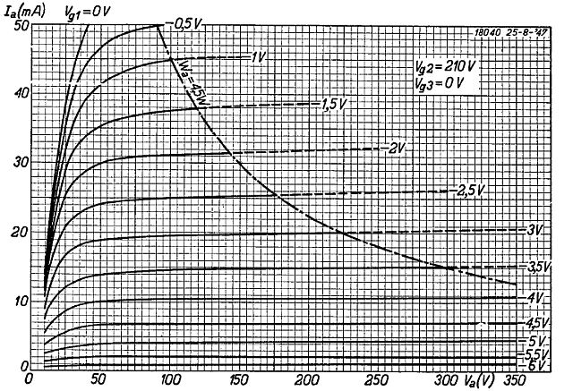

To create your own spice model, the first step is the determination of MU from a reliable diagram. Diagram must include Ug=0V curve.
I took Telefunken pentode and triode diagrams just for example.
The formula for calculation is:
MU=(Ua-Ua min) / Ug
For pentode, the line passes through operating point and the END of knee @ Ug = 0V, as you can see.

Thanks Raj,
This will allow us to determine mu for the model and then work solely with the other parameters - should make curve fitting a lot easier.

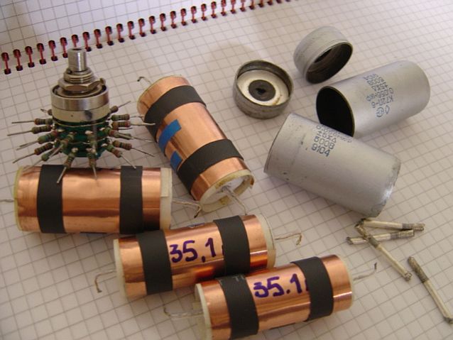

I know a few DIYers who use E180F in RIAA preamp.
One of them has E180F in pentode mode as input, and E180F triode mode on output (LED bias, CCS mu-out). He is very happy with sound. I adapted the Russian Teflon capacitors for his RIAA RC network. Simply unwrapped AL/Teflon foils to the required value. See atach.

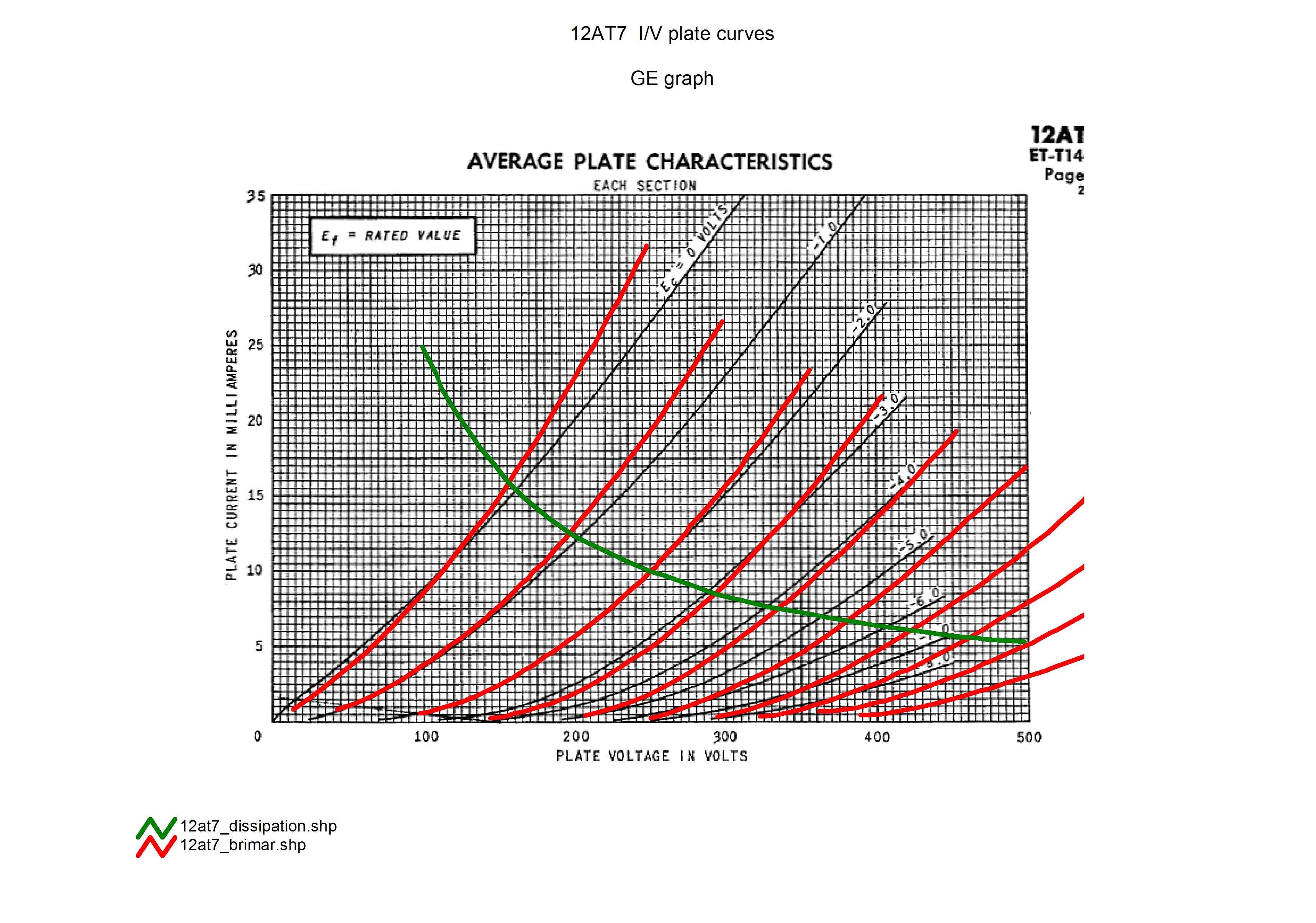

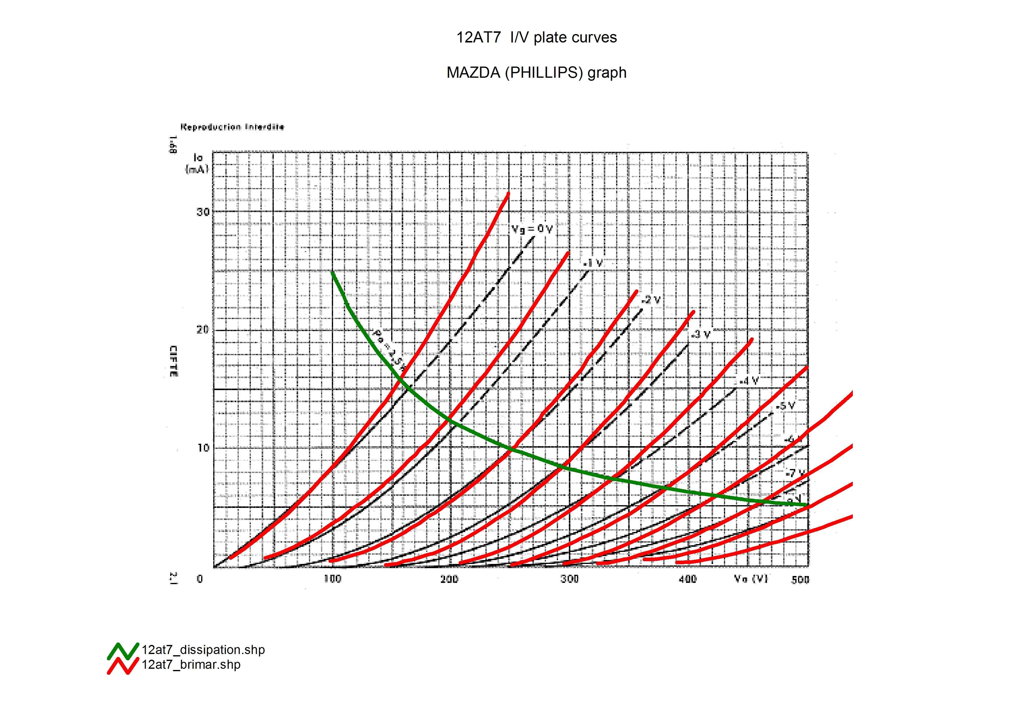

Different I/V curves for different brands of same tube type?

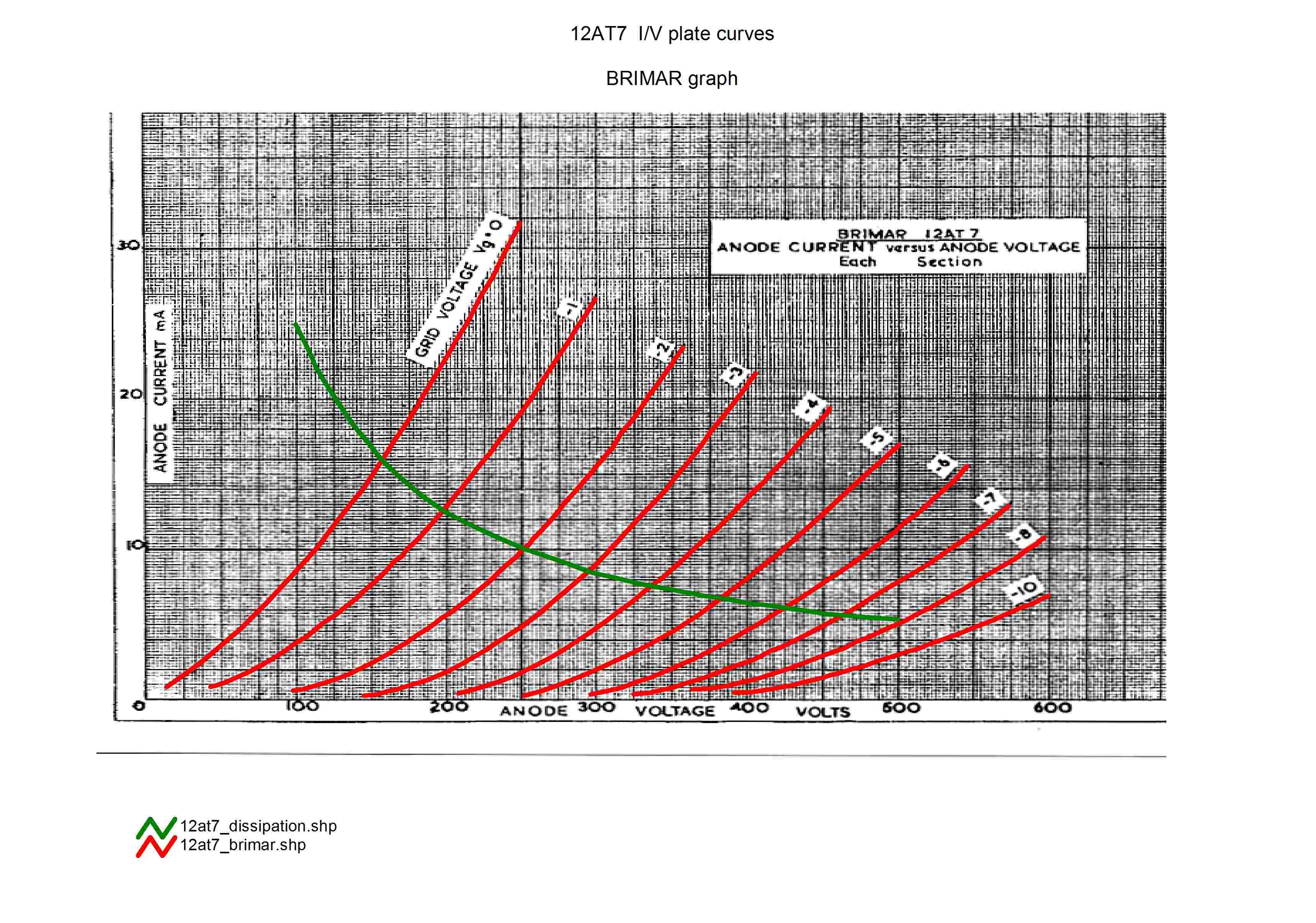

I tried the Joel’ pspice models, and noted that his library refers the tube brand datasheet, for every tube type, so I tried to see how different could be the I/V curves for some different brands of the same tube type.
Surprisingly, I came across with differences in Vp as great as 10% for the same Ip and Vg !
Have a look at the attached graphs, of the 12AT7 from BRIMAR, GE and MAZDA (Phillips).

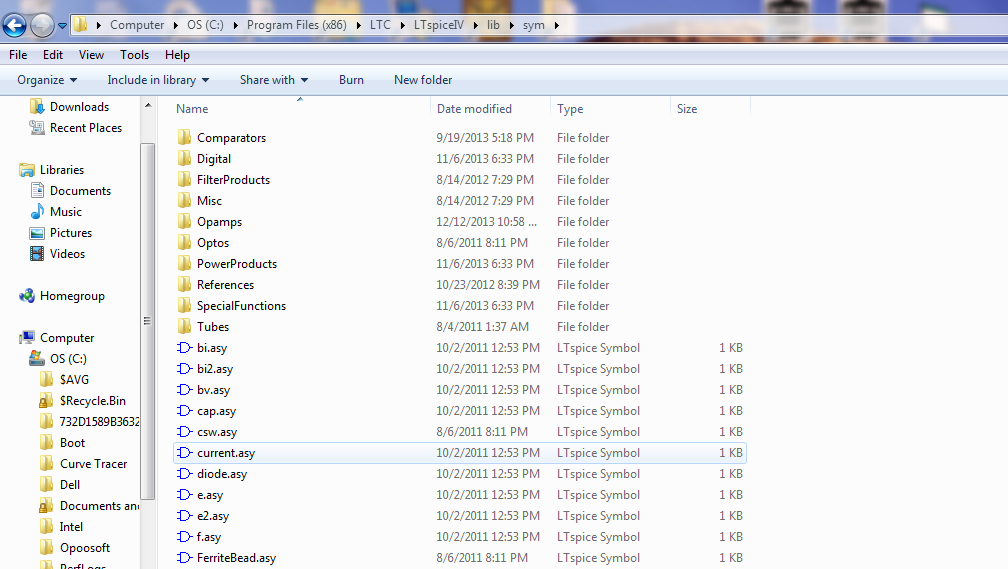

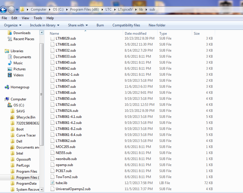

Installing Tube Libraries In LTSpice
OK so you want to install a collection of tube models and their supporting symbols. Note both are provided with no warranty implied or otherwise.
There are two directories you need to locate. LTspice is a 32 bit program and will be installed in program files in xp or Program Files (X86) in Win 7. Locate the LTC folder..
Path to tube symbols is \LTC\LTspiceIV\lib\sym - unzip the tube_sym zip and paste the folder here.
Next step:
Path to tube library is \LTC\LTspiceIV\lib\sub - unzip the tube_lib zip file and paste the file here.
Start LTspice and under the component folder (AND gate on the menu) you will see a folder called 'Tubes' click on this and you will find diode, triode, tetrode, and pentode folders. Click on the folder of your choice and you will get a number of choices. I have lots of triode models and fewer pentodes, tetrodes and diodes. A few models may be funky, but most work ok.
