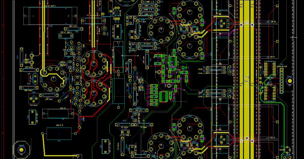

Hi, just noticed this thread. This is very interesting to me, but the pcb prices seem so high compared to Chinese manufacture. Marcel, if you have Gerbers I can run a group buy. I ran one here quite a few years ago, but still remember the in's and out's.
It indeed uses sigma-delta (or delta-sigma, that's the same) modulation. In fact you can choose between three sigma-delta algorithms, a seventh-order chaotic sigma-delta and two fifth-order sigma-deltas with a kind of embedded pulse width modulator with randomly rotated pattern. These last two have the advantage that they are dithered according to dither theory, which eliminates the tonal behaviour that many sigma-delta modulators have. You can also do a blind ABX test, I've included a state machine for that.
The complete design database including Gerber files, KiCAD database and FPGA files (source code and synthesized + implemented) can be downloaded for free from the downloads section of the Linear Audio website, Downloads | Linear Audio. You have to scroll down to "Design data package for Marcel van de Gevel's Valve DAC from Vol 13".

Marcel, I am starting to get some questions back from the PCB houses, and I have some of my own:
The filter PCB gerber files do not include silkscreen or solder mask.
What about PCB specification itself: substrate, thickness, surface finish, etc.? What are they for your prototypes, can we use this, or do you have suggested improvements?
You mentioned that there is a error with the transformer solder pads. Is this because the software library assumed a different Jensen form factor? This may be important if we seek a substitute supplier such as Cinemag.
You mention that the transformer is optional. The schematics in the design package don't show that option. Is it to be found somewhere?

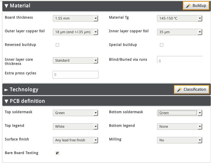

I was surprised at 1.55mm thickness. With this large a board, 4 layers, and the need to survive multiple tube socket insertions and removals, I would have thought that thicker would have been the way to go. Any comment?

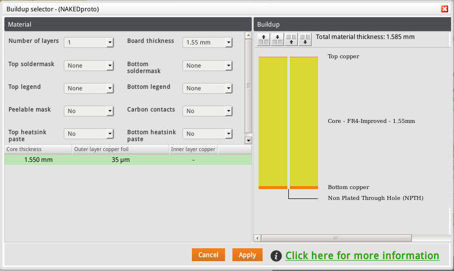

I didn't think about that at all and just used the defaults. At Eurocircuits any change from the defaults makes it much more expensive - except one: I didn't include a backside legend to the main board, but actually adding a backside legend would have cost only 0 euros extra. I can generate a Gerber file for a backside legend if you like.
Anyway, the filter board was made in the Eurocircuits naked proto process. This process is double-sided, but I used only one layer because there was no real advantage in using both.

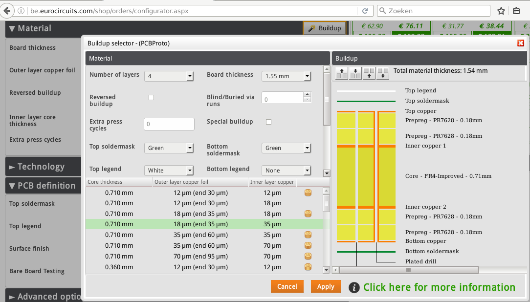

The main board was made in the four-layer version of their PCB proto process (so not naked). It is described here:
PCB proto – the PCB prototype service from Eurocircuits – Eurocircuits
I've attached plots of the layer build-ups. You can find them on the Eurocircuits website when you go to the price calculator.

I have gotten some quotes back from PCB houses.
One question I have is that if I read the screenshots correctly, the prototype PCB is 0.5 oz copper top and bottom (18 um) and 1 oz copper (35 um) middle layers?
Also, I don't have KiCAD, but if I am reading the files right, copper traces for the tubes are on the top layer? I am considering getting a quote on 2 oz copper on the tube trace layer since the currents are more substantial. Comment?
You have read the screenshots correctly.

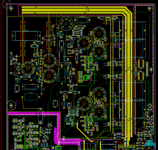

In general most of the traces for the valves are on the top layer, most digital traces on the back and the inner layers are mostly shields.
The heater wiring is an exception, though: it is mostly on layer 2 with the top layer as a shield. The heater currents are the most substantial currents, in total nominally 2.7 A.
See the attachments, which are some screen shots of the layout with the ground and -300 V planes switched off. Red is layer 1, yellow is layer 2, pink is layer 3 and green is layer 4. The big yellow lines on the right and the top with F1 and F2 written in them are heater wiring (placed as F1-F2-F1 to cancel magnetic fields). Close to the valves they are connected by narrower wires, mostly on layer 2, sometimes on layer 1.
So if you want to minimize heater wiring voltage drop or self-heating, layer 2 would have to get thicker metal. The impact on transmission line impedances will be negligible, so the circuit should work fine with thicker metal for layer 2.
Changing layer 1 to 70 um thick metal would affect the transmission line impedances a bit; for a 0.25 mm wide trace (the narrowest I've used), the capacitance per unit length stays nearly the same and the inductance per unit length drops about 8 %. Again I don't expect this to harm the operation of the circuit in any way.
