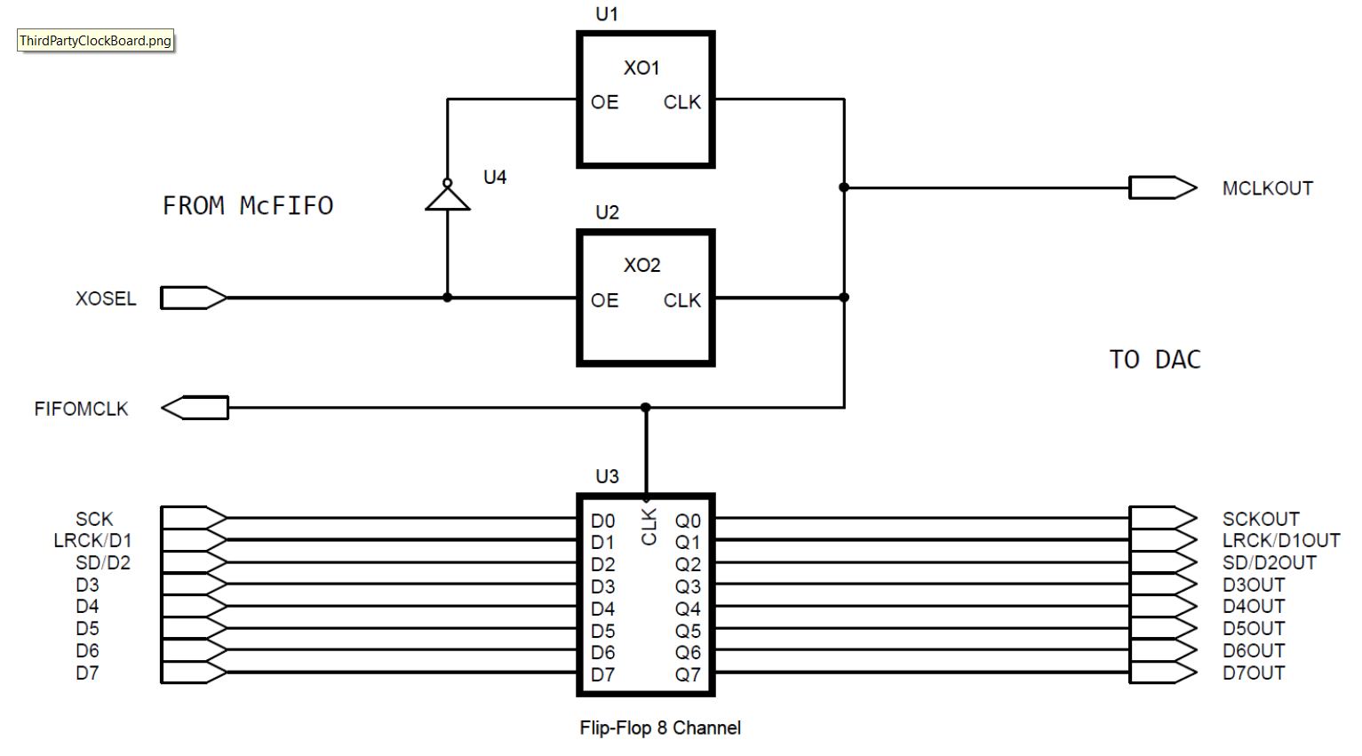

It's a pity because I never understood how reclocking is supposed to work.
Please see attachment below from Iancanada McFIFO manual. The FIFO MCLK may be also be routed back to the USB board either as-is or divided down to a lower frequency, as required. In the case of Cronus, it looks very similar, but without a FIFO FPGA.
Sometimes, two stages of D-flip flops are used.

OK, then I just make a raw DSD interface and leave any reclocking to the reclocking board.
Thanks for the explanation! It makes sense when the USB board gets (a derivative of) the reclocker clock and can adjust its data rate to it.
Yes, that is what the TPA Hermes/Cronus does; the Beaglebone Black (BBB) receives a masterclock input so that it runs at the rate of the incoming data. 'Out of the box' the BBB only has a single cheap (48KHz data) oscillator so would have to resample incoming 44.1KHz data.
