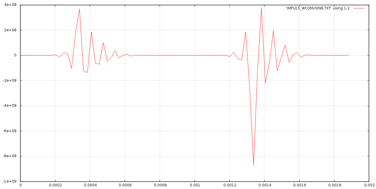

This is the calculated response of my first interpolation filter in the steep mode to your burst, this first filter should be dominant. The burst starts at t = 0 s, the horizontal axis is in seconds and the vertical axis in arbitrary units. I hope this helps.

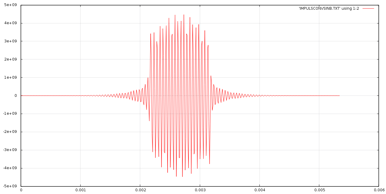

For completeness' sake, the second plot shows the same for the apodizing filter. It shows that at a sample rate as low as 44.1 kHz, 20 kHz is in the apodizing filter's stopband and is hence suppressed.

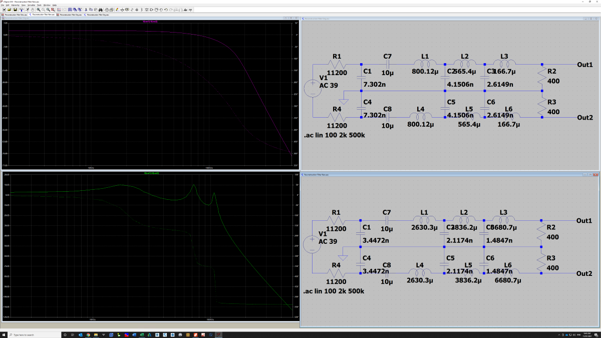

Marcel, have you checked the filters resulting from your interpolation method in some sort of sim? I have, and it is possible that I have misinterpreted something, but my results are not good. If we use the following start point for the calculations (just like the existing filter in the schematics):
Source load 11,200ohm
Termination Load 800ohm
Fc = 82,000Hz
6th order Linear Phase Low Pass 0.05deg phase error
I get interpolated constants as follows:
C1 = 0.7104
L1 = 3.3881
C2 = 0.4364
L2 = 4.9412
C3 = 0.3060
L3 = 8.6052
See the attachment for my sims: top is using the INF constants; bottom is using the interpolated constants.
Something must have gone wrong with the interpolation. It's interpolation between figures 2C and 2D of the pdf file, so the interpolated values must end up somewhere between the values of figures 2C and 2D. By the way, the source impedance is about 5600 ohm single-ended or 11.2 kohm differential.

Btw, Marcel, I was interpolating between two wrong sets of numbers (well, one of them was right) in the filter calculator...have fixed that up now and the spreadsheet has been updated and the sims look perfect...very nice to be able to calculate things very easily...thank-you.

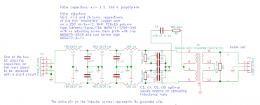

I can calc out differential filters for each channel but would require twice the number of inductors and caps to get the job done. No idea how to alter the filter termination to avoid this though...

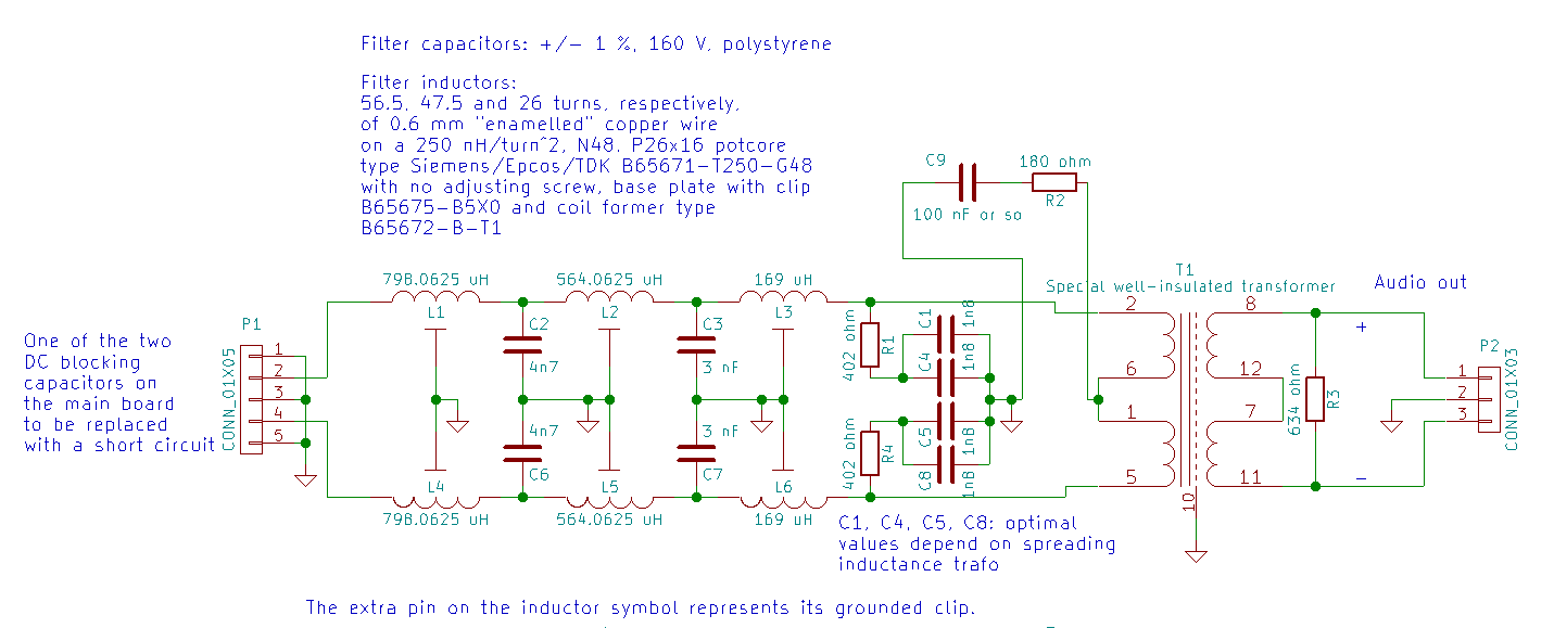

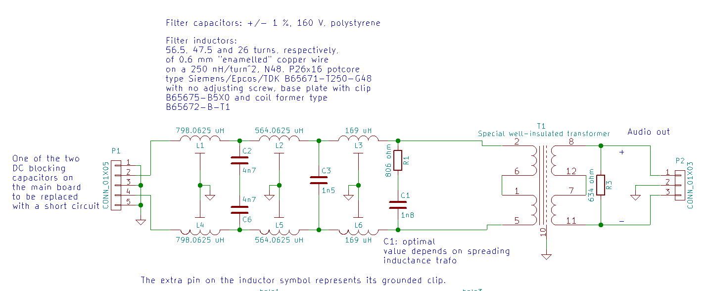

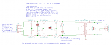

I was thinking about one of the attached circuits connected to a main board where one of the DC blocking capacitors is replaced with a short and the other has only 100 V DC working voltage (all assuming a well-insulated signal transformer).
In one case, the 180 ohm common-mode termination resistor gets a capacitor in series that is much smaller than the DC blocking capacitor, yet large enough to have a reactance much smaller than 180 ohm at 82 kHz. Common-mode hash is then filtered off as effectively as in the original circuit, the termination still prevents nasty resonances in the common-mode response.
In the second case, there is no common-mode filtering at all except for the two 8.2 nF capacitors to ground on the main board. You then rely more on the transformer to get rid of it. Note that C2 and C6 are not connected to ground anymore.

By the way, I'm not going to try it out, but I wonder what would happen to a Jensen JT-11SSP-7MPC with -300 V +/- tolerance on the primary. The insulation voltage spec is 250 V RMS (so 353.5 V peak) 60 Hz for one minute from the primary or secondary to the shield and case. Using such voltages for a longer time is explicitly not recommended, but if they would only result in a short to a grounded electrostatic shield rather than to the secondary, it would still be safe to touch the outputs.
Thanks so much for the filter options Marcel. Looks like I should keep a twin primary winding just in case the filter needs terminating that way.
