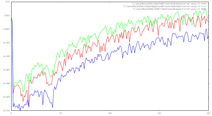

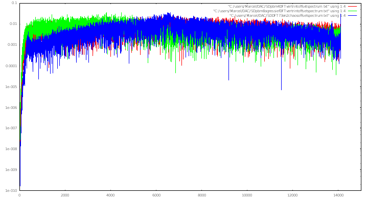

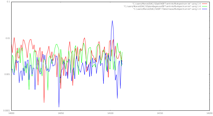

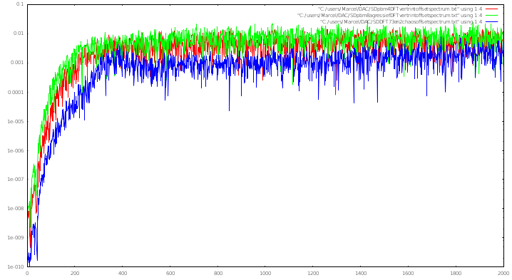

I can't measure that with the equipment I have at home, but I have simulated data for the shaped quantization noise spectra (without any reconstruction filtering), see the attachments. The frequency is in units of 27/28.224 kHz (so 14112 on the plot is actually 13.5 MHz) and the y scale is in arbitrary units that are proportional to voltage. Red is PWM4, green PWM8 and blue is chaos.
Looking at these plots, it seems that the chaotic mode has the best in-band noise floor, but that's because the second-order effects that actually determine the in-band noise floor are not included. In reality, PWM8 works best except regarding the out-of-band noise.
Like I wrote in the ThevalveDAC_PCB.pdf file included in the zip archive on the Linear Audio website, I expect that the Gaussian to 6 dB filters invented by DeVerl S. Humpherys give a much better suppression of out-of-band noise than my phase linear to 0.05 degrees filter. They will especially suppress the noise at a few hundred kilohertz better. Tables for these filters are included in Zverev's book.

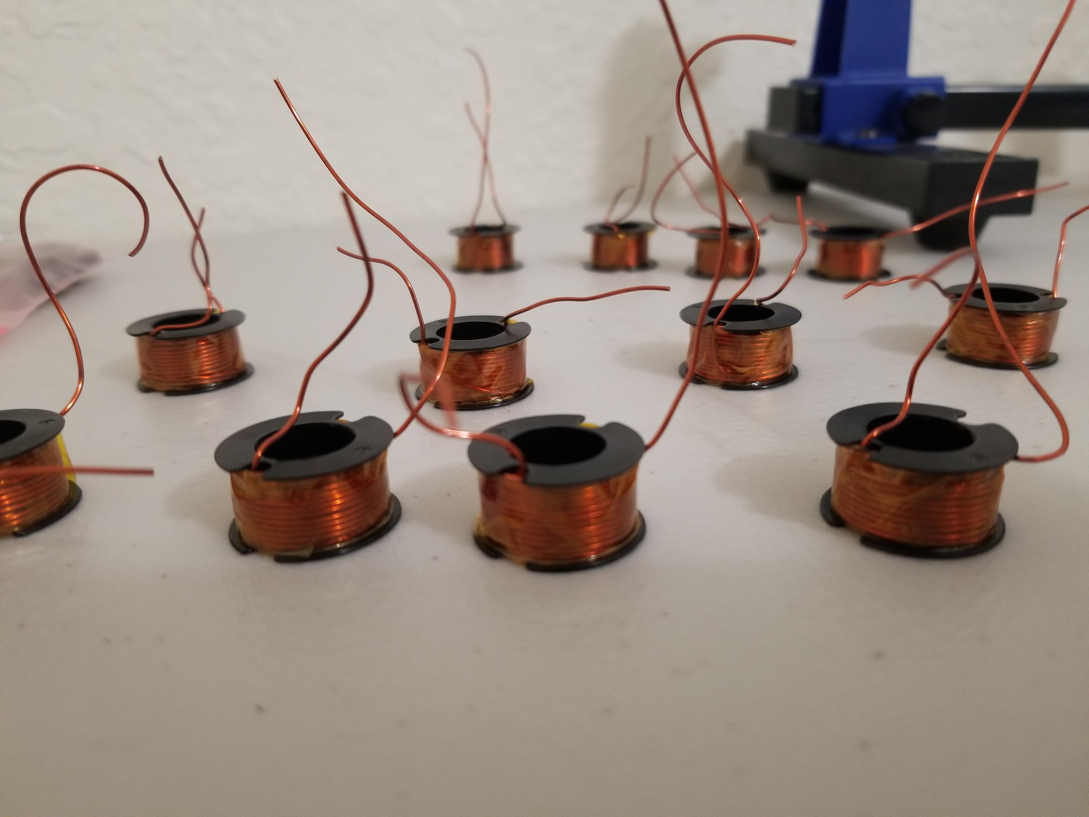

It takes a lot. Not even accounting for the added thickness each time you add a layer of wire around the former, you would need at least 20 meters for the default number of turns. The center of the coil former is about 12mm in diameter, so circumference ~38mm, 130 turns for a set of inductors = about 5 meters. There are 4 sets of inductors, so 20 meters without even accounting for wire thickness. Probably going to be more like 30-35 meters.

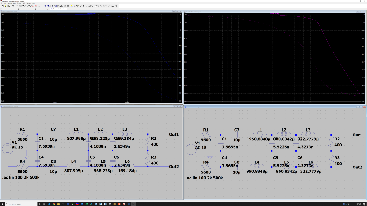

See attached for two things: a comparison of the Linear Phase vs Gaussian 6th order filters for Fc = 82kHz, and the spreadsheet used to calculate the component values.
Note that this spreadsheet is useful only for current sources like the ValveDac and the DSDOnly variant...voltage source output stages need not apply. Both the 0.05deg Equiripple Linear Phase and Gaussian to 6dB filters are in the spreadsheet for all orders from 3rd to 6th and Marcels LC Interpolation method is used which means that filters can be calculated for different termination impedances (I am lowering the load impedance to improve the noise performance a little).
You enter your parameters in the yellow boxes and the green boxes give you the component values...it's that easy.
Standard source and termination impedances are 5600 and 375ohm differential respectively.
