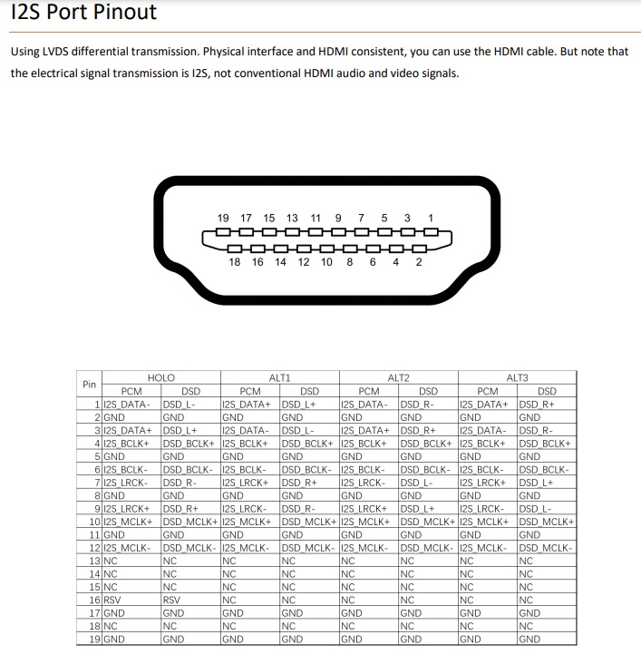

That Audiophile style article was a little misleading as regards the pinout.
I2S enhanced, as it was originally known, does not use unused pins. It uses the same pins as HDMI. There is no compatibility between the two.The manufacturers can use any pins not used by the HDMI standard in the connector for the I2S interface.
Thanks, pity that there are four permutations in use... Do you know what RSV stands for?
On the white I2S connector shown on a photograph in the article about the interface box, there is a signal D_ON which presumably indicates that it is DSD. Is there an equivalent for the LVDS I2S/raw DSD connection?

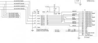

3. It would therefore be handy if a circuit that switches various I2S signals to the single I2S input of the DAC supported raw DSD, 3.3 V CMOS and LVDS levels.
I'm trying to come up with a circuit with four inputs that fulfills the requirements of point 3. It will consist of a couple of three-state buffers and LVDS receivers with three-state outputs and some glue logic.
Not sure if you have had a look but does this board tick those boxes? Possibly not...
It has no LVDS inputs, otherwise it does. The Chinese interface also appears to have 3.3 V CMOS outputs (the white connector), so I don't know if you really need LVDS.
I was thinking about something where you can just use a single eight-position source select switch to switch between optical, three times S/PDIF or AES3 and four I2S/raw DSD inputs. With this board you would end up with a five-position switch that switches between optical, three times S/PDIF or AES3 and I2S/raw DSD and then a separate push-button to select one of four I2S/raw DSD sources.
