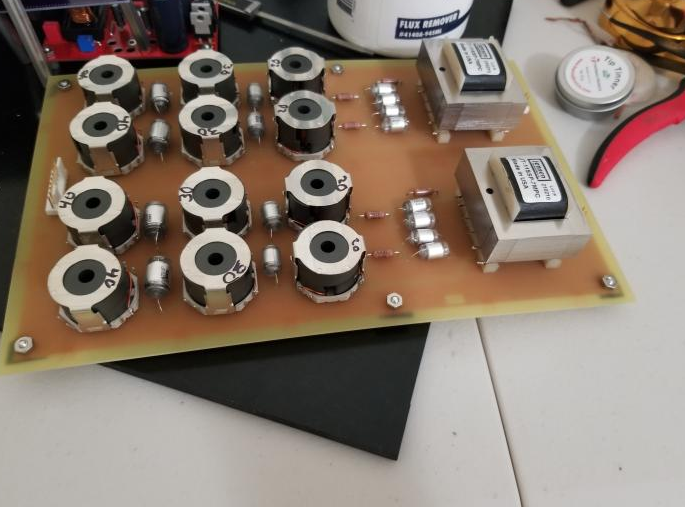

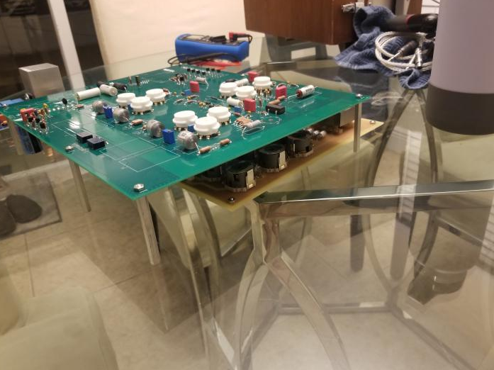

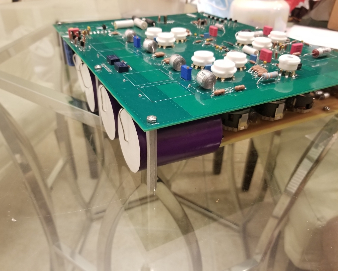

Got the heatsink for the Maida tapped and drilled and got the standoffs figured out for the DAC and filter board.
The 9-pin connectors will be as close as possible to minimize that distance, then the XLR outputs will be right next to the filter outs.
I also added two standoffs/holes to the filter near the output transformers because they are heavy and to combat the flex. Since there is no solder mask, I put some paint and electrical tape around the holes so the standoffs don't touch the ground pour.

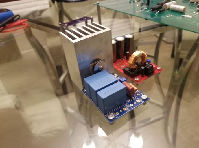

I can't say that any of it is necessary, but since this is an expensive project anyway, I went all-out and tried to minimize any noise, usually overpaying for over-spec'd parts just for my own satisfaction lol. Nothing crazy, Vishay RN/CMF resistors, WIMA, Kemet, etc. Every resistor is at least 1%, then the ones that are specified in the schematic to be 1%, I used 0.1%.
I'm using external PSUs for the -300V, the 6.3V, and a 5V for my USB thing. I'm also using this reg for the on-board 5V supply.
My case layout is also really geared towards separating power things from signal, and the signal ground connects to the chassis at one point using this circuit.

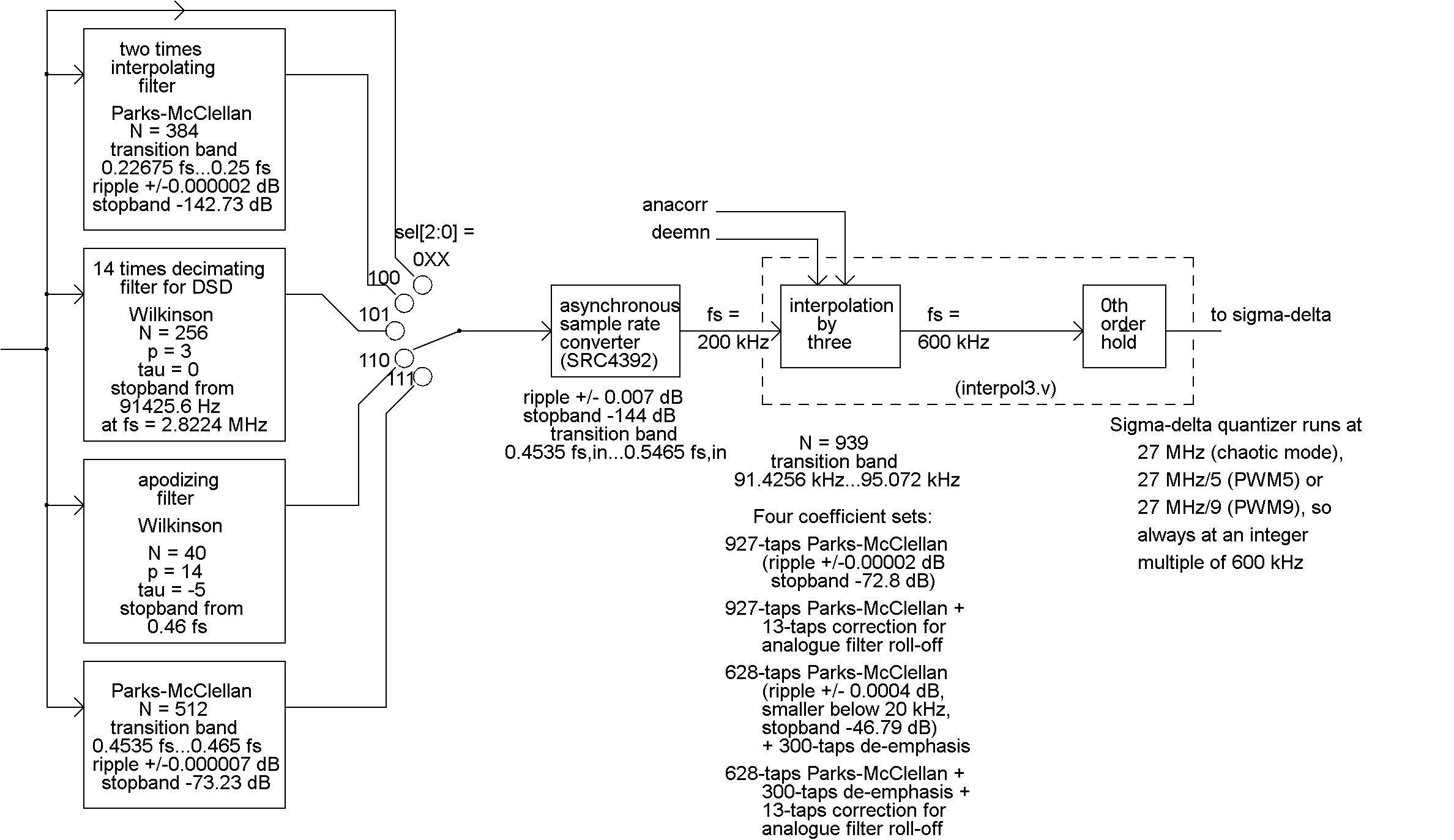

When I finally managed to program the module, the integrator clipping issue turned out to be much improved but not solved, so I had to make some further changes. The attachment is an update of the TE0630 LX45 configuration file with these changes:
1. Last integrator's linear range doubled by giving it one bit extra
2. Sigma-delta modulator's input scaling factors slightly reduced
3. Bit clock for the output side of the SRC4392 generated in a cleaner way
4. Functionality of DIP switch S1C changed: when it is on, the neon lamps also indicate the sigma-delta mode and filter type when the surprise button is not pressed
The attached figure shows the filter chain. It's the exact same as 8 days ago, but I hadn't shown it yet.
