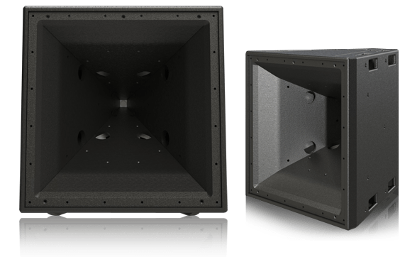

Also I remember Patric Bateman and mark100 say about synergy horns / MEH that they disappear very well, especially depth perceptio disappears. Danleys and most MEHs seen in the forums have hardly any mouth termination so "severe" diffraction happens, reflection back to the horn, and also the taps would diffract some, but somehow at least the disappearing trick and overall good sound seem to be there regardless of some diffraction happening. Perhaps its just that it is a point source, true one in many sense including diffraction, there is only one "diffraction signature" for all ways, no separate ways with their own diffraction fingerprints. Also all room reflections are as similar as direct sound as good the waveguide is. Typically they have quite narrow coverage angle and relatively well controlled so I assume most of the sound is due to how it works with the room and rooms attribution is rather minimal (beong narrow coverage angle point source). Well just speculating, probably many reasons, there is deep mystery to diffraction in this sense.

What is ment with MEH? Ah, i found it multiple entry hornAlso I remember Patric Bateman and mark100 say about synergy horns / MEH that they disappear very well, especially depth perceptio disappears. Danleys and most MEHs seen in the forums have hardly any mouth termination so "severe" diffraction happens, reflection back to the horn, and also the taps would diffract some, but somehow at least the disappearing trick and overall good sound seem to be there regardless of some diffraction happening. Perhaps its just that it is a point source, true one in many sense including diffraction, there is only one "diffraction signature" for all ways, no separate ways with their own diffraction fingerprints. Also all room reflections are as similar as direct sound as good the waveguide is. Typically they have quite narrow coverage angle and relatively well controlled so I assume most of the sound is due to how it works with the room and rooms attribution is rather minimal (beong narrow coverage angle point source). Well just speculating, probably many reasons, there is deep mystery to diffraction in this sense.

I try never to use the term "meh" on these forums because Multiple Entry Horn (MEH) is an important concept.

Danley Synergys have sort of termination, wedges. Jericho series and some diyers leave the wedge off in large horns that go low. In SH50 it obviously is crucially important, like in Danley Hyperion
