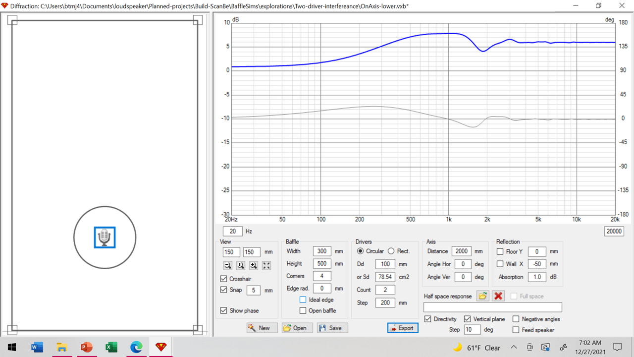

I have confirmed this. There are two ways to get the same answer in simulation.
(1) hold the virtual mic in a constant position in the diffraction tool, and collect the diffraction responses from the drivers. Then when modeling the crossover filters, keep the driver coordinates at 0,0,0.
(2) position the mic on each drivers axis in the diffraction tool and collect the diffraction responses from the drivers. Then when modeling the crossover filters, enter the correct driver coordinates.
Based on reviewing some of Kimmo's past writings, I think he would prefer us to use (2). But both methods generate the same result.
This is the preferred way. The fact that it works the other way (in this idealized situation) simply indicates that the software is mathematically consistent.
In any normal simulation, using measured responses, the designer will need to provide the x, y, and z coordinates anyway. If the virtual mic position is held constant on the tweeter axis, it complicates how the x,y,z coordinates would need to be entered. It is a completely unnecessary complication, because Kimmo has designed the software to use x,y,z locations properly with the virtual mic position. Within the software, the virtual mic position is different than the virtual listening position.

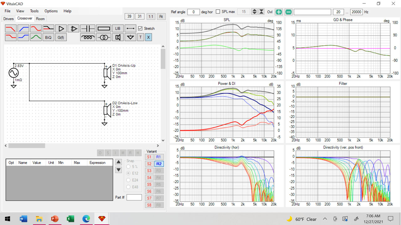

AllenB – perhaps I have not been clear in what I have been saying. I am talking about the very specific case where the VituixCad diffraction tool is used to generate a “pseudo virtual” measurement which is then used in the main crossover tool.
On the other hand, AllenB, most of the time when you tell me I have made a mistake, I have in fact made a mistake. So perhaps I am missing the big picture.

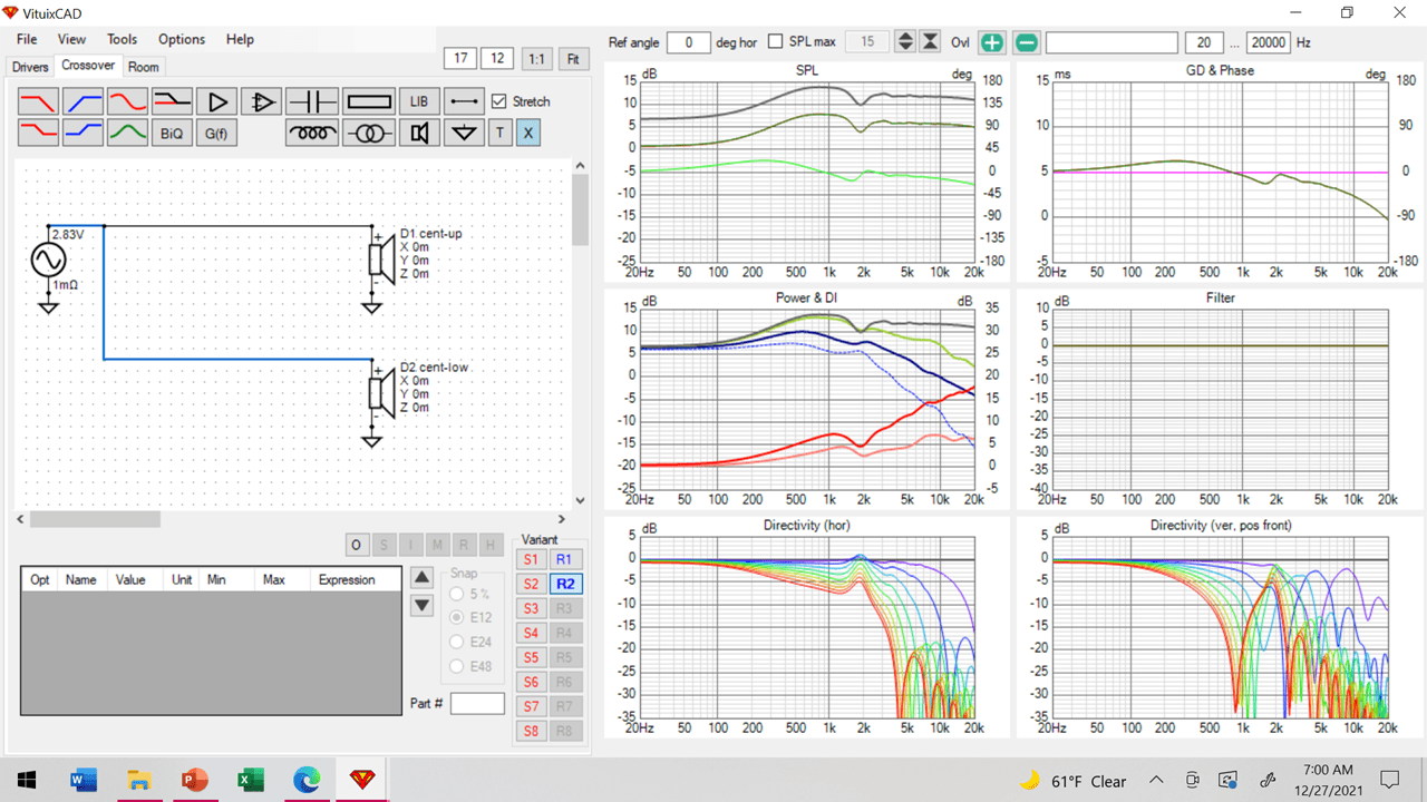

I will make three posts which show my evidence which convinced me that Tmuikku (post 47) and David Morison (post 43) are correct.
I have modelled a 500mm x 300mm baffle with a pair of drivers vertically arranged. The design axis is centered between the two drivers. The drivers are hypothetical cones with Sd=100 cm^2 and are arranged 200 mm apart. A correct simulation should show strong cancellation nulls in the vertical plane, but not the horizontal plane.

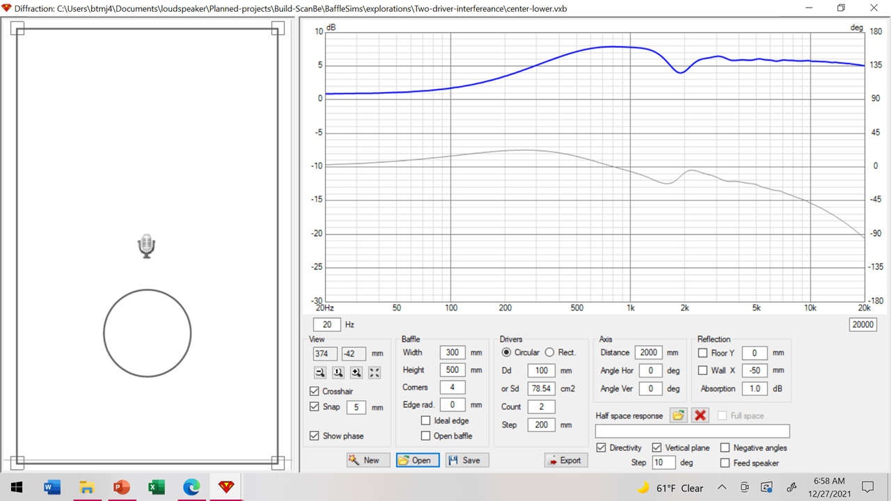

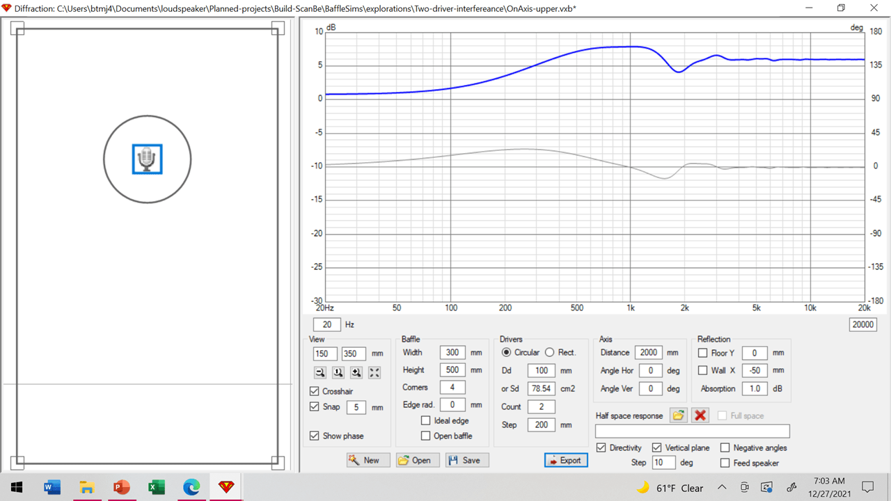

The first example, we do it the preferred way: Using the diffraction tool, we simulate a measurement of the upper and lower drivers by positioning the virtual mic on each driver’s axis. Then in the main crossover tool, we input the y-coordinates to space the drivers 200 mm apart. The upper driver is +100 mm, the lower driver is -100 mm.

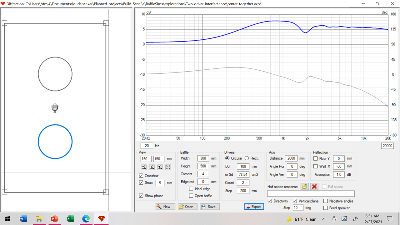

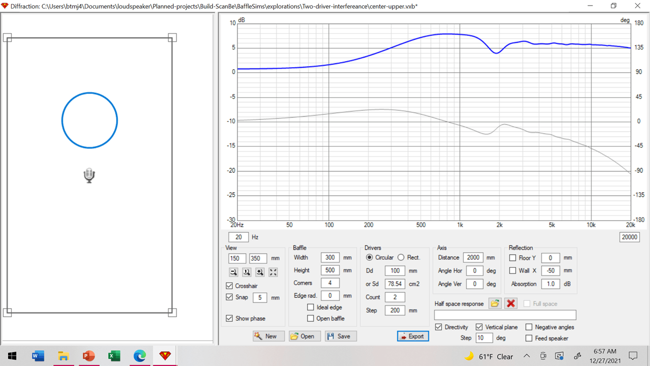

Next I will show the results of using a non-standard technique. I will hold the virtual mic in a constant position in the diffraction tool, and I will collect the diffraction responses from the drivers. Then when modeling the crossover filters, keep the driver coordinates at 0,0,0.
You can see that I get the same vertical response pattern as above, except for very high frequencies as we would expect.
Just to be clear, this is NOT the recommended process for using VituixCad diffraction tool... But the fact that it does give the same response pattern shows that the tool is versatile enough to handle this situation.

Here is a sim which really surprised me. Here I simulated BOTH drivers in the diffraction tool, and exported the response to the main crossover tool... Then in the crossover tool I model the response as if it came from a single driver, in other words, a single loudspeaker system. Once again, VituixCad shows how versatile it is and gives the correct response.
