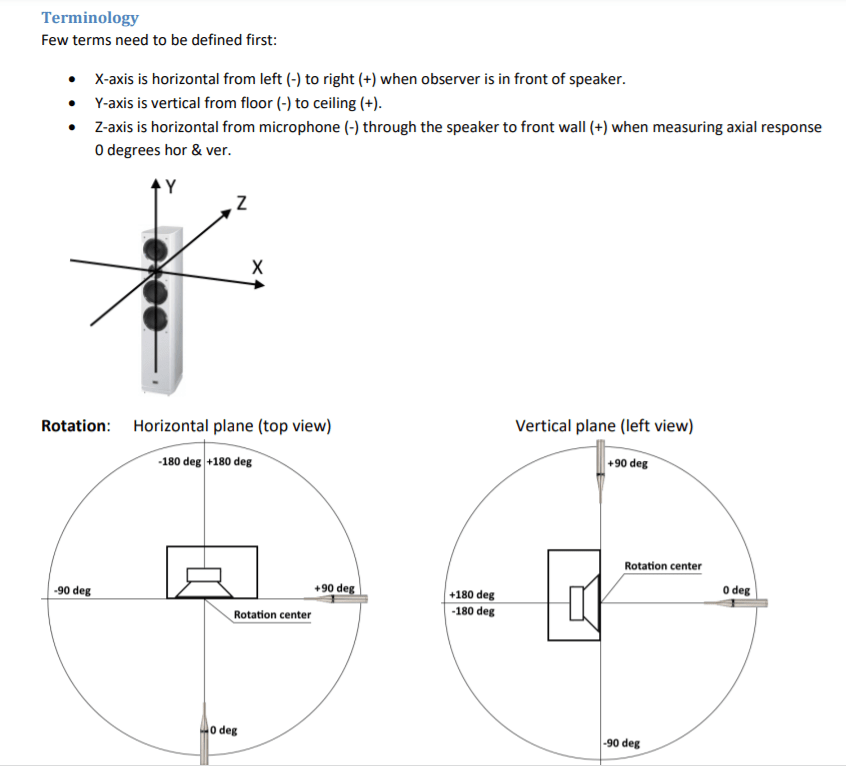

This image from the measurement preparations guide might be useful to help understand the directions
https://kimmosaunisto.net/Software/VituixCAD/VituixCAD_Measurement_REW.pdf

One thing to keep in mind is that the coordinate system in VituixCad does not follow the right-hand rule (which is generally used in Cartesian coordinates in math, physics, and engineering). Instead, it uses a left-hand rule.
A right-hand rule would have either the z-axis or x-axis in opposite sign.

The acoustic centre of a woofer to the tweeter has a negative value. deeper into the cabinet (delay / Z value driver tab)
When using a sloped baffle where woofer is in front of the tweeter it has a positive value. ( Z value crossover tab)
No, Z positive is further away from the front baffle into the cabinet, so a positive z would be needed to represent a woofers voice coil being further into the cabinet than the tweeter.Am I correct if i say.

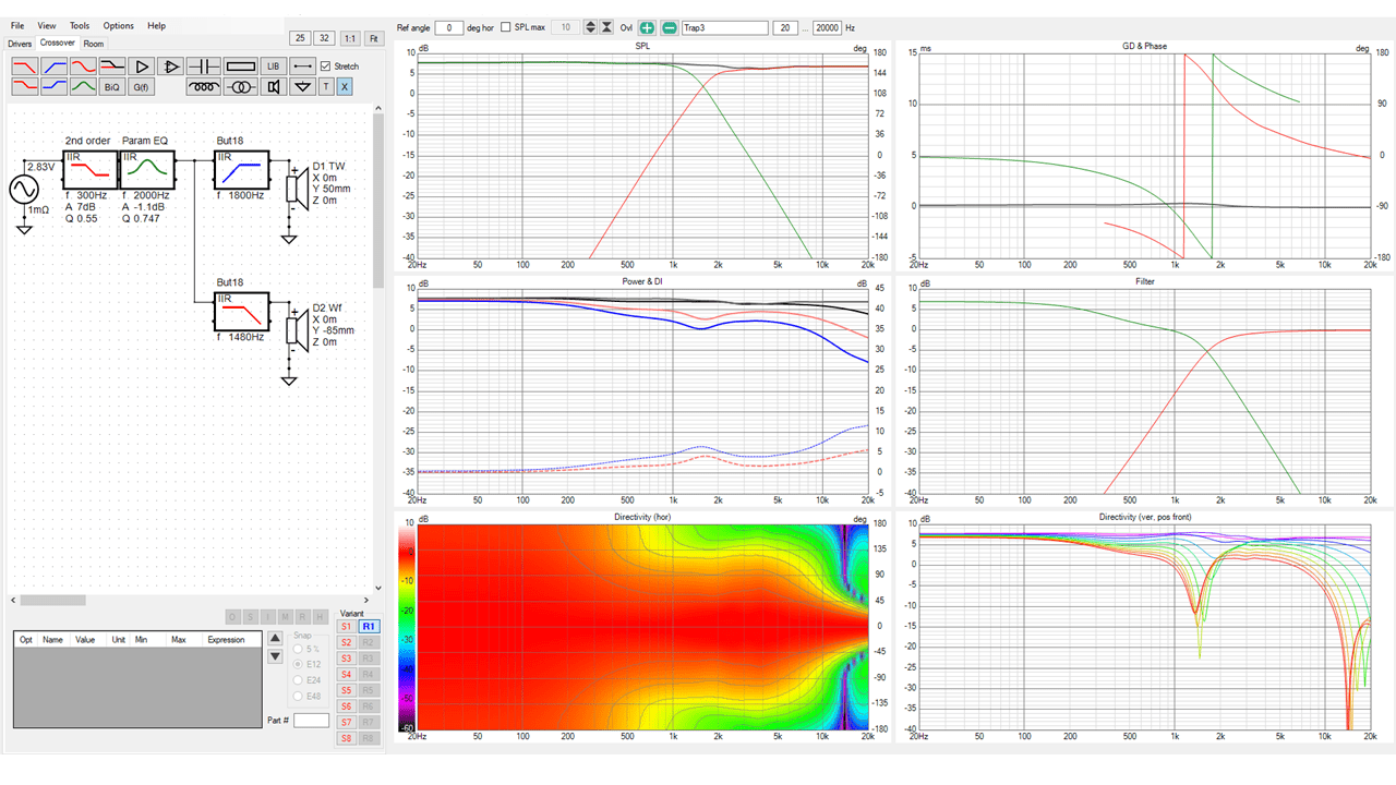

Well, back to the original point of this thread...

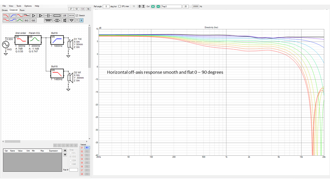

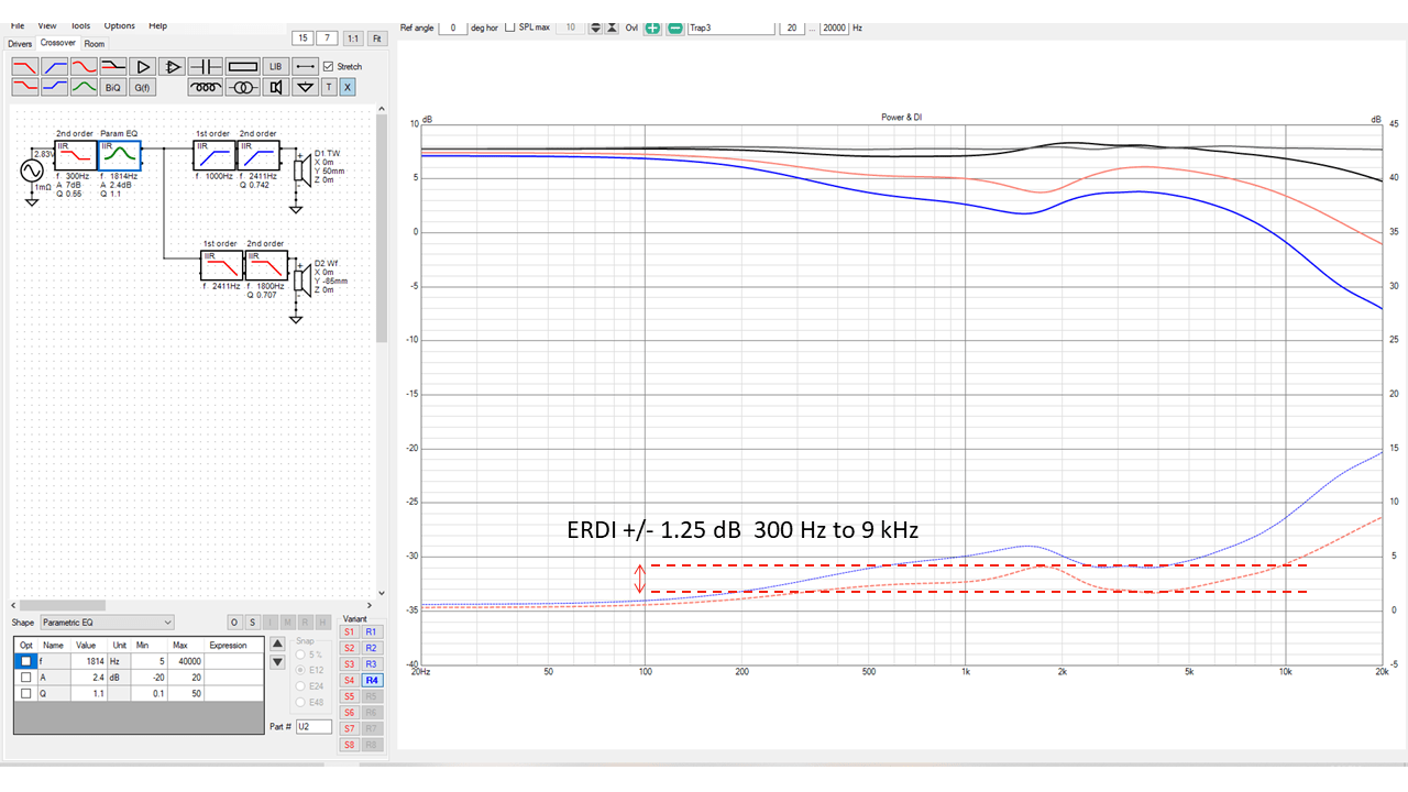

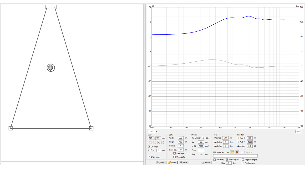

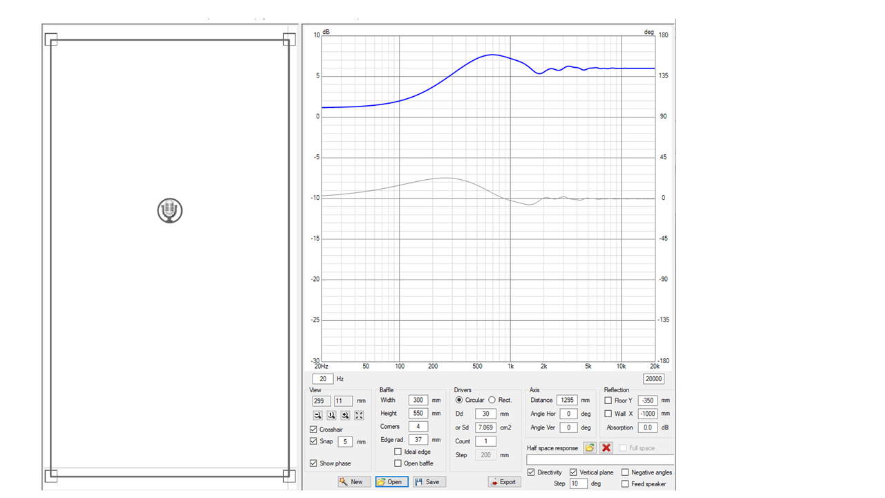

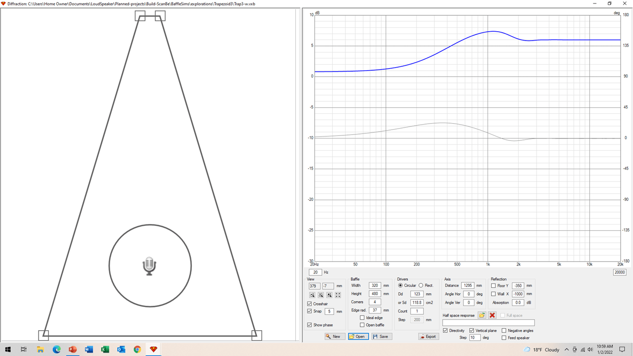

Here is a nice trapezoidal baffle shape that would not be too difficult to build. The edges are beveled or radiused at 37 mm, and there is enough space on the baffle to accommodate a 105 mm tweeter flange and a 165 mm midwoofer frame without impacting the bevel/radius.
The midwoofer has a very mild diffraction hump of 1.5 dB centered at 1.1 kHz. The tweeter has a 1 dB hump centered at 1.9 kHz. After some fiddling and tweaking, I came up with a reasonable filter: The tweeter has a 3rd order filter at 1.8 kHz, and the midwoofer has a 3rd order filter at 1.48 kHz. The crossover frequency nets out at approximately 1.6 kHz. BSC is applied to both drivers, and a mild EQ notch is applied at 2 kHz.

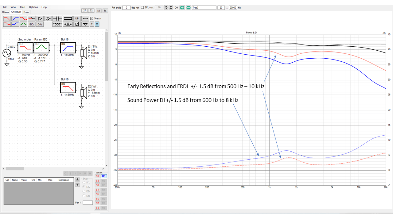

The Early Reflection curve is +/- 1.5 dB from 500 Hz to 10 kHz. The ERDI of course has the same +/- 1.5 dB from 500 – 10k variation. The Sound Power DI is +/- 1.5 dB from 600 to 8k.
The horizontal directivity is particularly nice. From 10 – 90 degrees off axis, the curves are smooth, flat, and basically the same shape. There is just the progressive roll-off of high frequencies as the off-axis angel increases.
I also found that the crossover frequency could be varied from 1.6 up to 2.3 kHz, so this is a rather versatile baffle shape.
j.

Did you compare the quantity and nature of the diffraction?the crossover frequency could be varied from 1.6 up to 2.3 kHz, so this is a rather versatile baffle shape.
You might also want to try out a quasi 3rd order filter that sums at -6dB, useful for in phase crossovers where the needed delay comes from the natural offset of the drivers on a flat baffle.I came up with a reasonable filter: The tweeter has a 3rd order filter at 1.8 kHz, and the midwoofer has a 3rd order filter at 1.48 kHz.
There are targets for it built into Vituix, also for 5th and 7th order too.

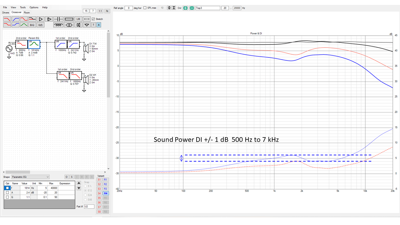

Regarding the Trapezoid baffle of post #111

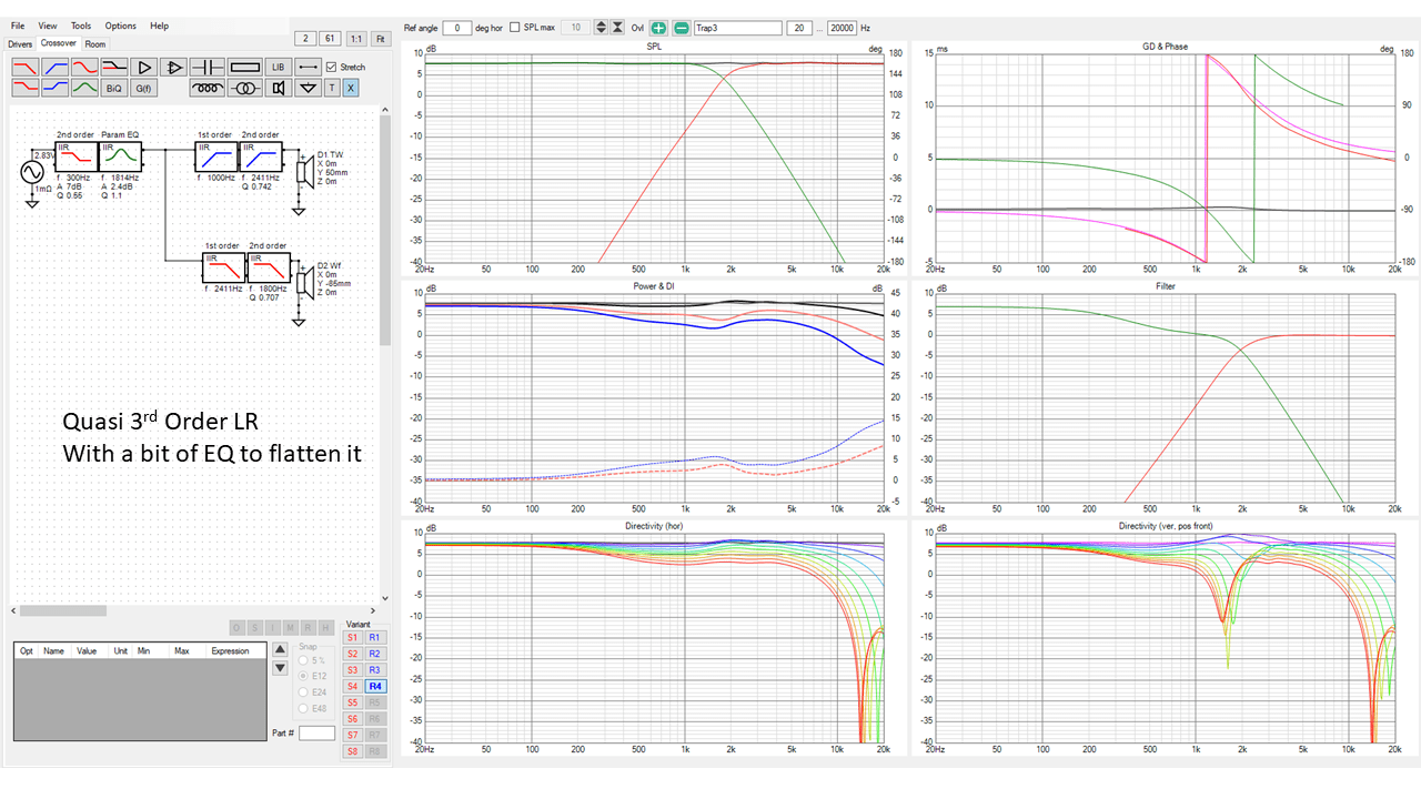

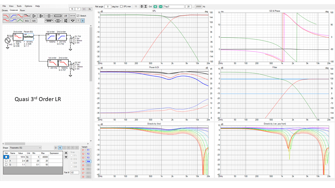

Quasi 3rd order LR. This looks slightly better than my previous efforts. I should point out that all these sims assume no delay between the drivers.
The EQ at the crossover frequency may or may not be beneficial... a small dip between 1k-2k is pretty harmless. Using real drivers in a real system would change the EQ anyway. But the important point is that EQ does not change the DI or ERDI.
j.
Phase seems to be about 90 degrees apart through the crossover, which makes the response. That's it, it is a feature not a problem and the implication is seen in the polar responses (which sound power and DI summarize). No need to reverse or anything to see if it works or not since all the data is visible all the time, beauty of "spinorama".
But, i suspect Hifijim might have tuned some parameters looking at the phase traces. At least this is what I've done many times with phase aligned crossovers. It is quite easy to see if the mouse is scrolling a parameter to right direction, if the phase traces get to better/closer alignment or worse, even if the frequency response was a mess it is rather easy to navigate towards working configuration this way. Slopes, phase reversal of drivers, delays, all easy to get into ballpark looking at the phase traces especially with phase aligned xo like LR4.

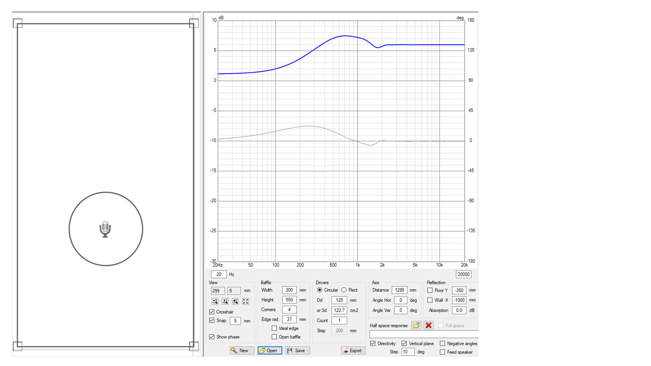

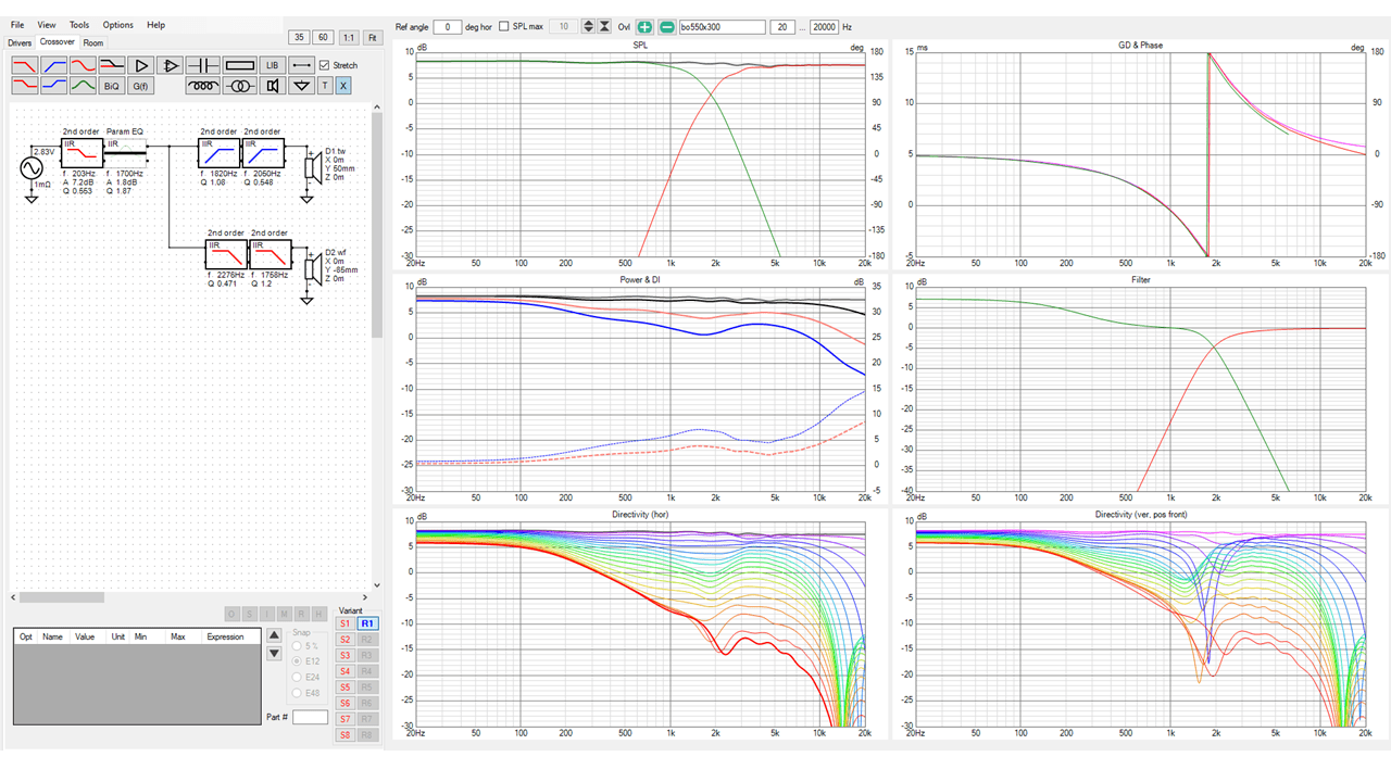

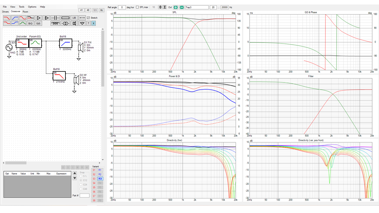

For the next sim I use a simple rectangular baffle. It is rather large for a 2-way, 550mm x 300 mm. Unlike the previous sims, this one has a lot of baffle surface above the tweeter. This seems to be a feature of many well-regarded speakers, so I wanted to experiment with it.
Once again, the mid driver is a typical 6” cone with an Dd of 125 mm, and the tweeter is a typical large dome with a Dd of 30 mm. They are placed as close together as practical. My goal is a crossover nominally at 1.8k. I use a low-q second order shelf as the BSC to get the response as flat as possible from 100 to 1000 Hz.
The first sim is LR4 crossover. For both drivers, I used two 2nd order filters cascaded in series to produce the 4th order slope. This allows more flexibility than simply using a straight LR4 filter element. I used the VituixCad2 optimizer function to match the ideal LR4 slope for each driver. Using the woofer for example, I initially set both 2nd order low pass filters with f=1800 and Q=0.7. The optimizer cranked for a few hundred iterations and came up with filter 1 at 2276, Q=0.47 and filter 2 at 1758, Q=1.2. The result, when combined with the woofers natural diffraction response and the BSC, is very close match to the ideal 1800 Hz LR4 curve.
Looking at the 6 pack, the result is pretty nice. The on-axis and listening window curves are flat, and they match each other. The ERDI curve is +/- 1 dB from 300 to 9k. The sound power DI is +/- 1.25 dB from 500 to 8k. All that is very good. Looking at the horizontal off-axis response, we start to develop a 2 kHz dip at 40 degrees, and it by 70 degrees it has grown to -4 dB. This may or may not be important, depending on the room. Another possible issue with an LR4 response with this baffle is that the mid and tweeter are in the same plane, i.e. there is no z-offset between them… if this is an active crossover application, adding some delay to the tweeter to bring them into alignment is no problem. However, if this a passive crossover, additional tweaking will be needed.
j.
