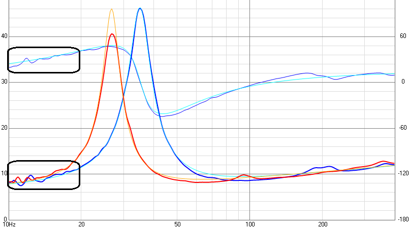

It seems the T/S calculation function may be broken.
All files work here so it's just sensitive to some noise or extra resonances in your files. Could you send problematic files to my e-mail that I could make some filtering or double scanning to focus correct peak?
^Impedance response measurements are very bad within 10...14 Hz. That quality would be impossible e.g. for dual added mass method. Try to reduce noise or mechanical resonances especially at LF (stepping frequency, environment noise down, mechanical resonances damped, ...). Single added mass and sealed volume are not so sensitive and T/S extraction is possible with the following workarounds. Risk is that some other functions in the program are now worse / less accurate due to wider range for slope detection at LF.

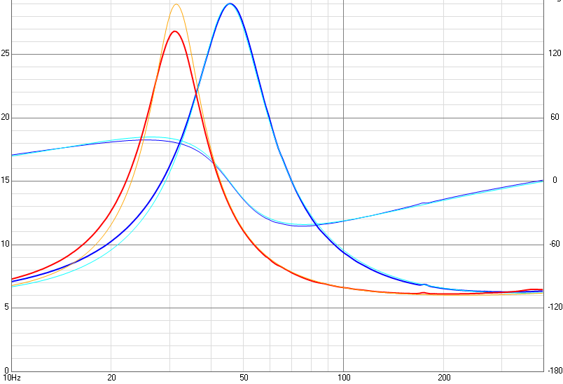

^Sample rate, bit depth and lowest frequency are not so relevant. Measurement signal, silence of environment and robust mechanical connection of the driver and added mass are more important. Steady state stepping sine is good. Very fast sweep or MLS or white periodic are not.
Two examples. The second one is measured with Smith & Larson Woofer Tester Pro (WTPro) at Seas, steady-state sine wave signal which is stepped 384 times in the frequency range 10 Hz...20 kHz.

Thanks for this sanity check, Kimmo. SoundEasy doesn't seem to mind the noise. Nevertheless, I was able to improve (reduce) the noise by maxing out the sound card settings and only doing attenuation in the analogue domain. There was still some noise, though. I usually use 1/24 octave smoothing. I could get the curve much smoother in SE by going down to 1/6 or 1/3 octave, but it seemed to change the curve too much for my liking. SE uses MLS signal and it appears that I have reached maximum performance with this setup.
Best SE-measured curve with 1/24 oct smoothing:
![ExtrSEfa.jpg](https://elipse.co.za/Images/ExtrSEfa.jpg)
I next redid my measurements with REW and the curves are smooth, like the ones you showed above. The hardware is the same; REW uses a frequency sweep.
REW-measured curve:
![ExtrREWfa.jpg](https://elipse.co.za/Images/ExtrREWfa.jpg)

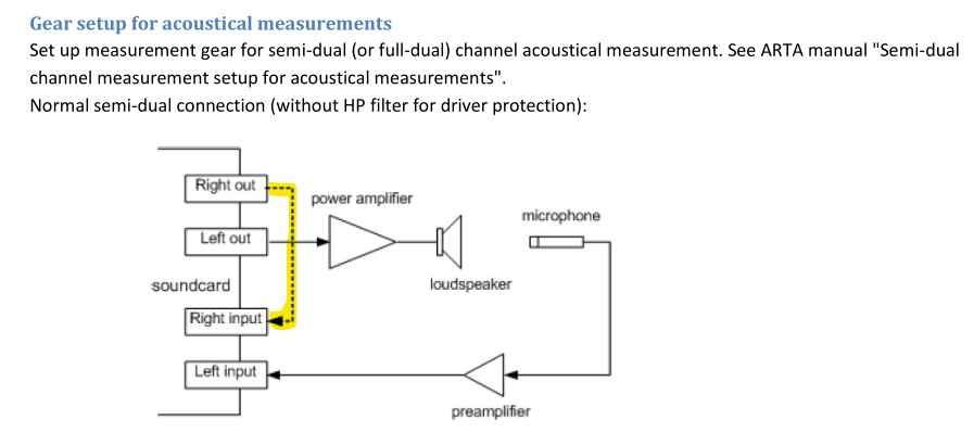

I'm a little puzzled about what sort of microphone, sound card, etc, I should use with VituixCAD. I see that USB mics are not recommended. But what would be good? I have seen the Dayton mic recommended, but what sort of sound card will work well? (I'm on Linux, but most sound cards work fine with it.)
From Kimmo's Measurement with ARTA doc page 2
The most important to have is a two channel input (left and right), so you could create a loopback signal. this is what the USB mics are missing. This is the only reliable way to know the exact timing of playbac/record as you can't trust any of the OS-es to keep it constant... probably even with Linux.
Search for other threads in this or other forums. The soundcard selection has been covered tens of times. There are many many pro and semi pro soundcards that are suitable.
Thanks for the reply. I did try searching, but if you just search for "sound card" or "soundcard" you get 20K hits, and if you search for "sound card vituixcad" you get less than 20, none of which are helpful.
It would be nice to collect this information somewhere specific. It must be a frequently asked question.
I see things like the Focusrite Scarlett 2i2 mentioned often. But, as far as I can see, that's only for recording, not playing, and I'm not sure how I'd loop a line-level signal into it.
