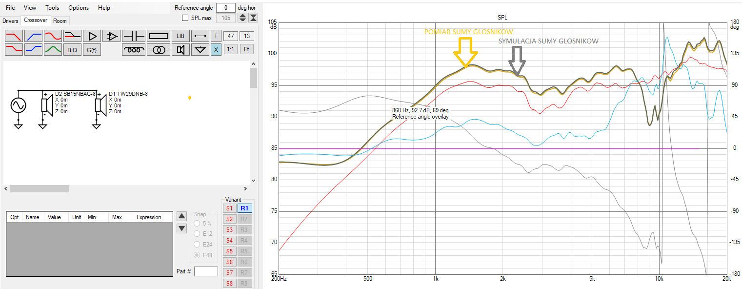

You can make measurements with most of the sound cards on the market. Important is to check if the latency is constant. The only thing to do is to check if the measured sum of the drivers matches simulated sum of the drivers. My advice is to try to do some measurement with any sound card (some integrated in laptop are fine too). Let me say You will try to do 2 way monitor, please prepare three measurements:
-Tweeter
-Midwoofer
-Sum of the drivers
First task is to make simulated (gray on pic bellow) sum of the drivers look exacly the same with measured (yellow on pic bellow) sum of the drivers. In case of floating latency of the sound card You can cheat it a bit with Z-axis to get rigt results.

This is not according instructions. Programs such as REW and ARTA normalize timing in single channel mode i.e. impulse peak is moved to 0 ms so constant latency and non-constant latency produce the same result which is not valid for design style VituixCAD is designed for.
