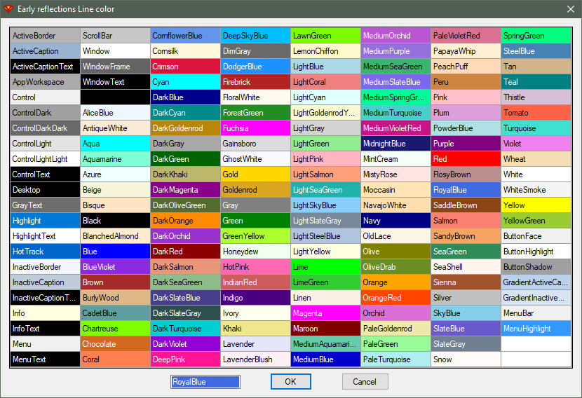

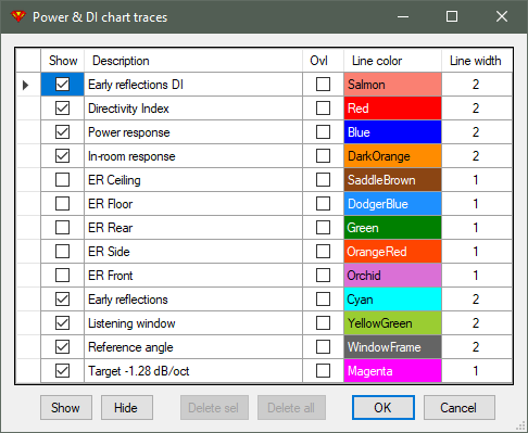

Hi Stankor. VituixCAD is able to automatically calculate the 'Early Reflections' curve from CTA-2034A or 'Spinorama' standard. But the Early Reflections Curve itself is made up of five averages:
Front: Horizontal Average of 0, +/- 10,20,30 degrees
Side: +- 40, 50, 60, 70, 80
Rear: 180, +/- 90, 100, 110...170
Ceiling: Vertical +40,50,60
Floor: Vertical - 20, 30, 40
These curves can further be combined into total horizontal and total vertical reflections.
I like to look at the individual components of the Early Reflections curve, because I like to know which parts are influencing it. For example,many speakers show a crossover dip in the early reflections curve. I like to see how much of that dip is because of the horizontal data and how much of it is vertical, since we know the horizontal data has a bigger influence on our perception of imaging/soundstage.
If you combine the horizontal averages to get 'Total Horizontal reflections,' I feel this is the most useful individual curve for describing soundstage performance. You could also calculate the difference between this and REW to get a 'horizontal DI' curve. This is not a part of CTA-2034A, but I like calculating it for my own analyses.
You can of course also gather this from the polar maps, but I personally prefer to work with SPL charts.
With the latest update to vituixcad, you can both view and export the full component curves for early reflections.

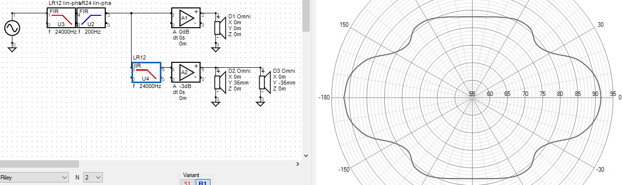

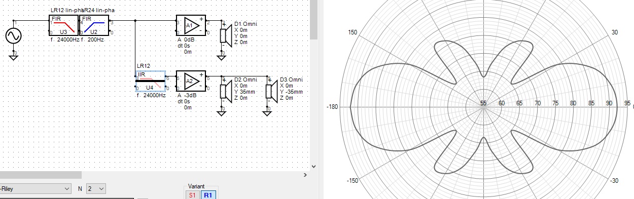

I tried to simulate a 3 driver arrangement as below and noticed something surprising. Its a fullrange center driver surrounded by 2 low passed outer drivers. The outer drivers' LP is LR12@24Khz and the resulting polar at 6Khz is shown.
Here is the polar with the LP
Here is the polar without LP
I expected to see no effect of the LP on polar chart at 6khz because the chart is being observed at two octaves lower than LP, but the polars with and without the LP are drastically different. Can you pls check?
Note:-No directivity files were specified for the drivers

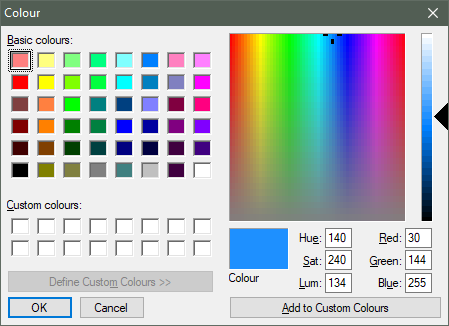

Graph overlay system renewed in the main program and Calculator, Diffraction, Enclosure and Merger tools. Add and Delete overlay buttons replaced with commands in context menu of each chart.
* Added 'Traces...' command to context menu of chart. Opens chart properties window allowing user to change visibility, description, colors and line width of each trace. Selected overlays are removed with 'Remove sel' button. All overlays are removed with 'Remove all' button. Multi-selection with row headers or top left corner. Line color and fill color with Area and Surface charts is selected from list of 'named colors' or with standard Colour dialog. Default color selection window can be changed by pressing Ctrl-key while clicking color cell.
* Added 'Save as overlay' command to context menu of chart. Saves selected (bold) trace, or all visible traces if none is selected. Overlay traces are not possible to overlay again.
* Added 'Open overlay...' command to context menu of chart. Response files are selected with file open dialog. Selection of primary/secondary Y-axis is automatic and not always reliable.
* Added support for Drag & Drop of overlay files. Traces are scaled with primary/left Y-axis if the files are dropped closer to Y-axis on the left. Traces are scaled with secondary/right Y-axis if the files are dropped closer to Y2-axis on the right.
* Total number of traces including overlays is limited to 37/chart.
Significant difference is actually obvious because LR12 low pass @24 kHz has phase shift of -28 deg at 6 kHz.
