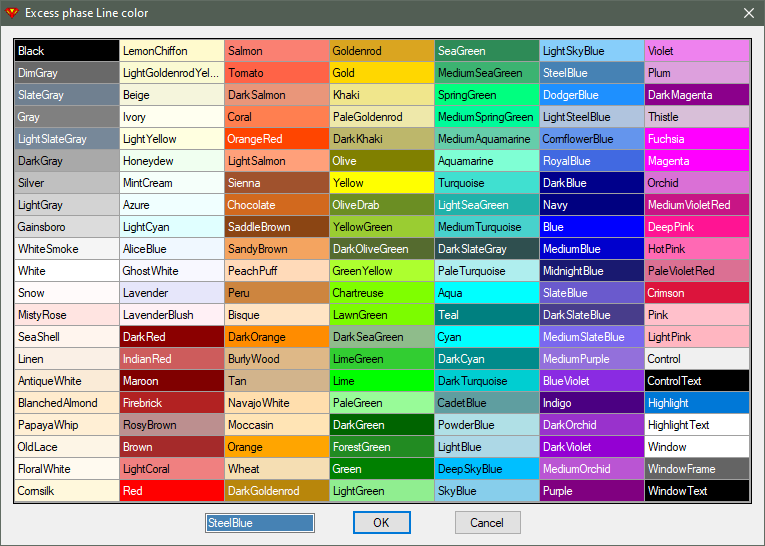

List of named colors is now shorter, grouped and sorted by hue.

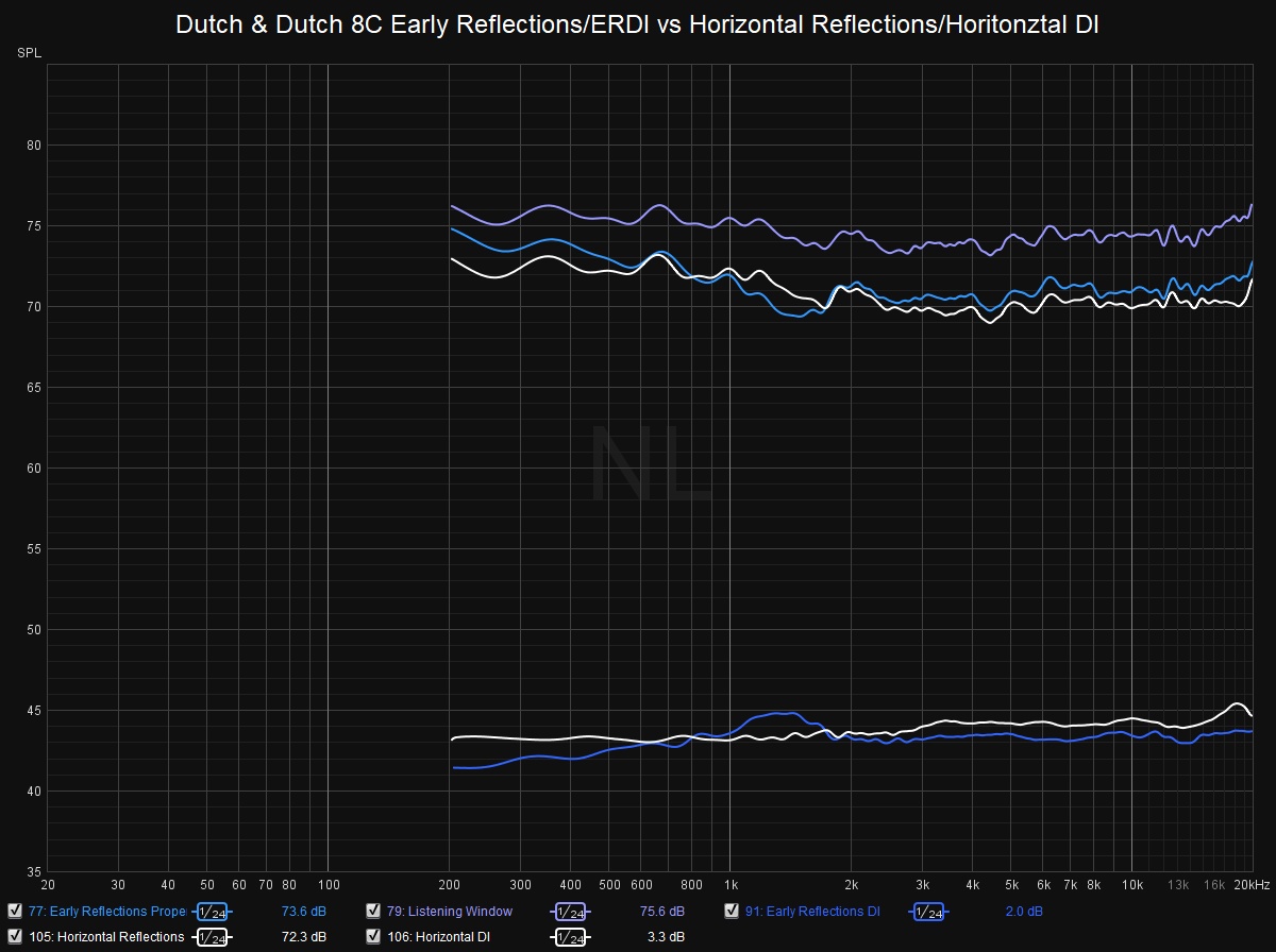

Yes, of course you're right about most modern speakers being very good in this regard and I personally prefer looking at the individual angles, or at least the front side and rear breakdown. But I was thinking more directivity width or narrowness. For this, I believe it is Horizontal ERDI more useful than the standard ER is.
For example, when I measured the Dutch&Dutch 8C, the standard ER hides the constant/cardioid directivity because it is of course not constant directivity in the vertical domain, whereas the horizontal DI makes it obvious.
Of course normalized polar maps show this more clearly, but I tend to prefer working with SPL plots. Makes it a bit easier to compare several speakers at once.
Ok, I understand this need when comparing and reviewing several already designed products, but very original traces (years ago without a single ER curve) provide adequate information about directivity and power spectrum for designing product with balanced sound.
P.S. Narrow resistance enclosure with constant horizontal directivity was quite popular on local market few decades ago, but not so much anymore. Maybe designers have noticed that "too constant", leaking and not so dynamic is not so good decision for sound and commercially after hype is faded :)
Oh yes, absolutely agree with you. I personally like to look at what is happening at every individual angle anyway. I am indeed coming from the unusual perspective of using VituixCAD a lot as a speaker evaluation tool rather than a design tool, though hopefully I'll get to do some of the latter soon =]

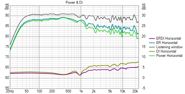

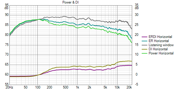

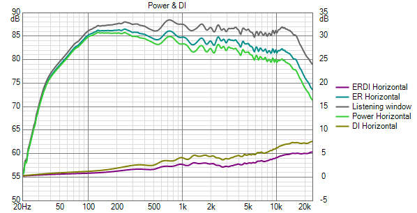

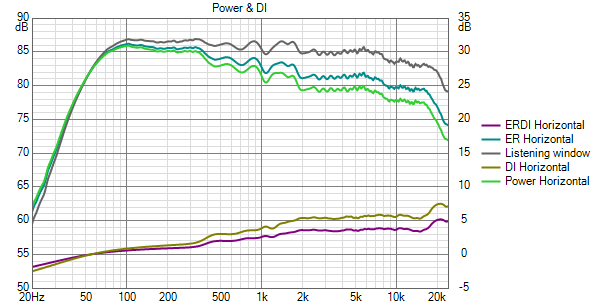

Few examples about similarity of power+DI and ER+ERDI in horizontal plane only. "Problem" is that ER+ERDI hor is now much easier to view than power+DI hor though importance is not necessarily that way.
