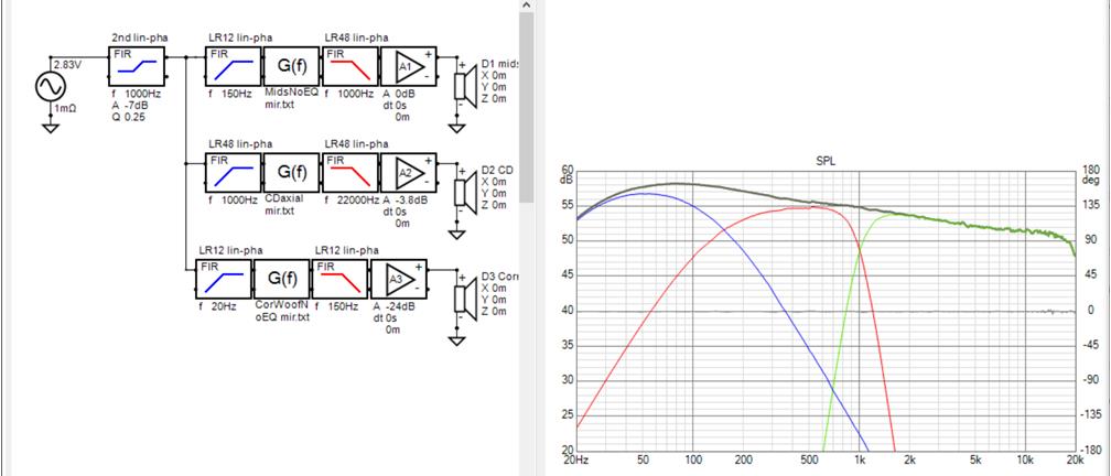

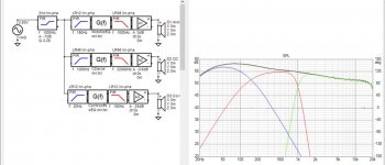

I'm implementing a crossover in JRiver so I need to create IR.wav files for the filters. I've made the filters in Vituix by using the mirror function of the calculator in a G(f) block to flatten a smoothed driver measurement followed by high pass and low pass filter blocks to establish roll off at each end of the range. That gives me a textbook perfect crossover in minutes, although I have to be careful not to make too detailed a correction.
I can export filter frequency response but I can't find a way to export a filter impulse response or convert the FR to IR and then export. Would it be possible to add that to Vituix? That would allow me to do keep the entire process except for the measurement itself in Vituix.
Maybe you've already received some instructions from Draki for this. At least he has inbox quite full of instructions and discussion how to create filter transfer function files for FIR convolution.
Main thing is that this functionality is already done to small TF button in top left corner of Optimizer window so Mirror function in Calculator tool is not needed and recommended. User manual tells quite shortly:
"Driver's target response divided by response to reference angle can be exported with TF button in top left corner. Response file is loaded into Transfer function file G(f) block currently selected in crossover. This could be helpful while designing FIR filters with exported impulse response files because crossover can include single G(f) block and active buffer for each driver/way, and response is shaped automatically to ideal textbook curve with tilt given or detected from total SPL target line."
First you need to load frequency responses of drivers to Drivers tab. Smooth by 1/12 oct. Then create simple XO with single G(f) block and single Buffer block for each driver (or way). Open Optimizer, select "Axial response of driver" and driver from combo box on the right. Create driver's target response. Note that high pass of woofer should be minimum phase and low pass should be linear phase to create minimum phase multi-way speaker. Then select G(f) block in the XO and export filter response with small TF button.
Repeat the same for mid and tweeter with multi-way.
Add extra EQ block(s) between G(f) and Buffer to make compromise between axial and power responses if needed.
Finally export impulse responses of Buffer outputs or Driver inputs as wav files with Impulse response window.

Thanks for those tips. I hadn't paid any attention to optimizer because I assumed (shame on me) it was for passive XOs. I built XO using methods familiar from other tools, which Vituix makes easier. But now that I'm aware of it I will try it out.
I can't complain about my results though. I invert the driver impulse response with mirror, then add filters to restore high pass and low pass slopes as desired, similar to target creation process. I'm sure the optimizer does as well with amplitude response, not sure what its phase result will be, or if it matters. I'll second what you say about minimum phase for the woofer low end roll off for natural sound although I used linear phase here without thinking about it.

Looks like I need optimizer to improve results with limited number of taps...
TF button uses drivers' target responses but not optimizer algorithm. Export of transfer function for G(f) block was earlier in File->Export but it was inconveniently far from driver targets. Feature was moved in rev. 2.0.47.3 (2020-04-12).

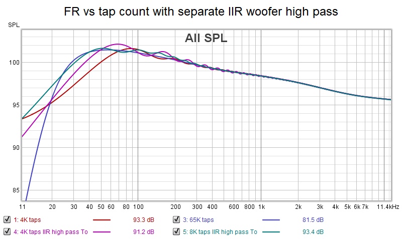

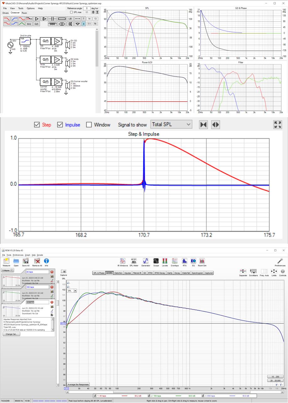

After I got the hang of it, I was able to get better results using TF mostly from working on woofer time alignment but it didn't help with tap requirements.
I imported IR(taps) into REW to evaluate. Doing this, I couldn't help but think how nice it would be if there were an (Save as Overlay) button right above the export button on the IR screen. The finite tap count FRs are plotted at 2 db per division so the error is not as bad as it looks
Taking the woofer high pass filter out of the G(f) and into a separate IIR block brought me about 1 db closer to the 65K tap curve in the 20-40 Hz region with 4K taps. 4K taps aren't quite enough; 8K looks great.

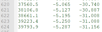

Can you extend the upper frequency of exported curve in the SPL tracer tool above 40kHz ? I need to digitizes a calibration curve of my mic which goes up to 100kHz. SPL tracer tool traces it ok up to 100kHz, but when I export the traced curve to txt file the highest frequency is 39793.9Hz.
Thank you.
