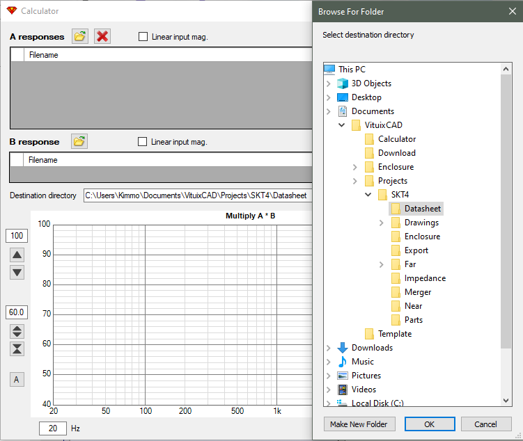

This happened on the last update.
When the calculator tool is opened, the last used destination directory is shown on the line. Should you click the browse symbol to change it, the window used to open up with that directory highlighted. Now it opens up at the root of the file system, which requires clicking down through umpteen layers of hierarchy to get to the desired location as opposed to up one branch and down another.
Folder browsing has not changed in a year, but temporary strange behavior is possible because root directory of browse folder dialogs was 'Desktop'. It's changed to 'MyComputer' in the latest build of 2.0.51.6 (2020-07-05) which should list full tree from 'This PC' down to previously selected folder. Should not need extra clicking of Projects folder (or full tree) to select sibling directory.
Could you test how it works in your PC.
^Folder browser dialog is windows feature so folder and search options could have some effects also to .NET apps.
Open File explorer. Select File->Change folder and search options. Restore defaults in General tab, View tab and Search tab. Apply and Ok. Restart VituixCAD. Should look like this:
