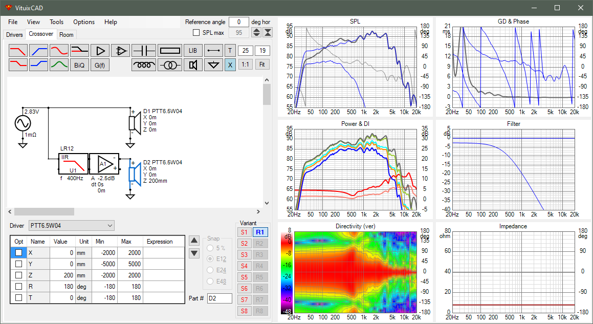

dipole response
I tried to model dipole response with two drivers co-located and one driver fed an inverted signal delayed by the equivalent of 15mm thick baffle. The results are not what I expected.
I do see dipole rolloff and in directivity I see some suppression of radiation to sides and back but not the expected figure 8 response. I wonder if I'm doing something wrong. Its curious that the shape of the polar chart doesn't change when I mute/unmute the delayed driver. The same is true when I invert/un-invert that driver. Frequency response changes but not directivity shape (just magnitude)
Is there something in Vituix that accounts for this or am I doing something wrong? I would love to be able to model dipole and active cardioid from single driver measurements or SPL trace + diffraction.
^If you are using simulated omni-directional response data or off-axis measurements (0-180 deg) of boxed driver:
- Add two drivers. Both have the same signal.
- Delay rear driver with Z mm parameter by sound travel distance difference between front and rear driver (towards listening spot). Typically baffle width / 2 + baffle thickness.
- Rotate rear driver 180 deg to aim it back.
- Invert rear driver.

That was very helpful. I built up a dipole array model and it had less trouble with wall reflections than a monopole.
How would you model a cardiod? I tried adding a monopole behind the dipole but didn't get much directionality. I may be on the right track but its far from dialed in.

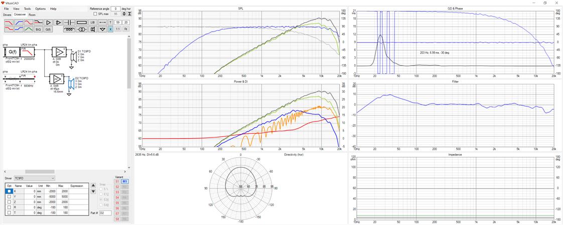

There are several ways to create simulated cardioid with actual or simulated measurement data. This one has two boxed drivers; one in front and another in back wall. Box depth 200 mm is entered to Z mm of rear driver and signal is inverted. Delay and required LP for rear driver (to prevent dipole pattern at HF) is done with single LR12 low-pass. Distance difference to virtual mic is compensated by dropping rear level a bit.
