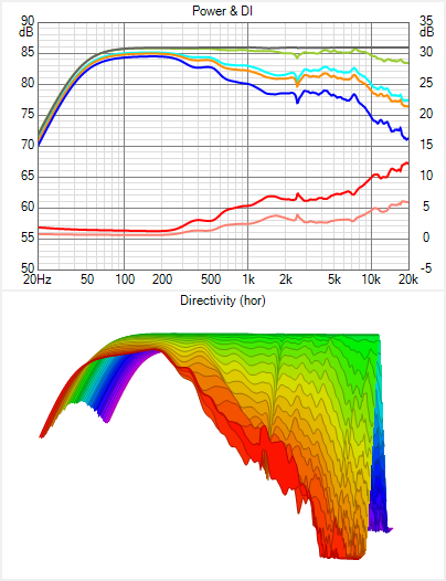

None of the methods from 0,5 to 4 piradians actually imitate any listening conditions.
In DIY scene it's not very rare idea that speaker could or should be designed for certain environment (to our home); construction materials and shape of the building, predicted location of the speakers and location of each radiator (driver/port) in the speaker.
Of course that part of sound balancing can be included in crossover design by weighting or preprocessing measurement data captured in anechoic, but this should apply to designs what really require help from some room boundary.
More common goal - especially in commercial scene is that speaker is as universal as possible: does not have to be located very close or very far from the wall(s), works far from the walls and quite close to walls if e.g. compensation for floor dip at mid-range is needed.
The most common and recommended measurement and design method is to make excellent sound source which radiates as healthy sound as possible to available space. Available space for other than flush-mounted wall and corner speakers is full space. Measurement data should be (quasi) full space and compatible with anechoic to enable full perspective to radiation from speaker.
Half space radiation below Schroeder frequency can be predicted with help of power response (e.g. flat power below Schroeder) or some simple thumb rule; tilt up on-axis response at bass range based on own experience or opinions on discussion forums or features of known commercial/diy speakers.
Personally I'm not a fan of radiators requiring boundary reflections because it makes the design more sensitive to room modes and requires certain location which reduces possibilities to find the best overall location. So radiation to full space is weighted in my communication.

Ok, can understand this, and some of the pros and cons.In DIY scene it's not very rare idea that speaker could or should be designed for certain environment (to our home); construction materials and shape of the building, predicted location of the speakers and location of each radiator (driver/port) in the speaker.
And this is I guess where many DYIs not comply with the average listerer as we try at least in some way to get a fairly good environment, and select gears from what might fit in the environment. So when we have the chance we could be to some extent more adaptive to "ourselves", or am I totally wrong here?More common goal - especially in commercial scene is that speaker is as universal as possible: does not have to be located very close or very far from the wall(s), works far from the walls and quite close to walls if e.g. compensation for floor dip at mid-range is needed.
Full Space =free air. Isn´t half space more close to room situation or even quarter space? Or is it just that we measure full space and let the software(s) use algorithms to find out what the best would be for a more room like situation?The most common and recommended measurement and design method is to make excellent sound source which radiates as healthy sound as possible to available space. Available space for other than flush-mounted wall and corner speakers is full space. Measurement data should be (quasi) full space and compatible with anechoic to enable full perspective to radiation from speaker.
Tried to find "schroeder frequency" but only did find a lot of well known "schroeder" men and woman.Half space radiation below Schroeder frequency can be predicted with help of power response (e.g. flat power below Schroeder) or some simple thumb rule; tilt up on-axis response at bass range based on own experience or opinions on discussion forums or features of known commercial/diy speakers.
Both commercial hifi and diy enthusiast are individuals. Arrogance and ignorance about environment and setup are as common in diy as commercial hifi imo. Diy is just a hobby including some resources such as tools and measurement gear, but nothing more by default.
This was already answered. No it's not.
Also this was already answered. Please read and don't make me repeat.
Should be measured to available space so everything not flush mounted in the wall (or ceiling or floor or corner) is full space.
