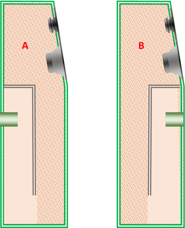

If you really decide to do such a design, leave port band e.g. ~3 dB lower to get flat power below 150 Hz, and locate speaker so that balance at listening area is okay. Port signal will be separate and location/material dependent and generate resonances which are not features of healthy concept.
In the enclosed picture alternative A is quite common both for TL and bass reflex speakers. It´s also what I have read and "learned" over the years (and todays reading). But as I understand it you would say alternative B is a better option for control, less placement dependency etc. Or do I misunderstand you?
A is more common because it usually looks better and simpler, and rear port produces deeper sound stage and less direct mid-range noise/resonances.
B is not necessarily any better due to possible noise at mid-range though total signal is more integrated.
My concern was rear port close to floor.
Thank you Kimmi,
So once again as almost always it´s a trade off.
I guess, at least from a theorethically perspective, I, as many DIYs and manufacturers seem to, prefer the A version. For it´s possibly less problematic mid doe to less "leaking and interacting mid signals" from the port. There are so many discussions on the internet, with various "thinking" but less actual theory that doesn´t really help if one like to understand.
This mean that the most important thing now is to integrate the measures from the port position in A in a correct way into the XO design. 🙂
