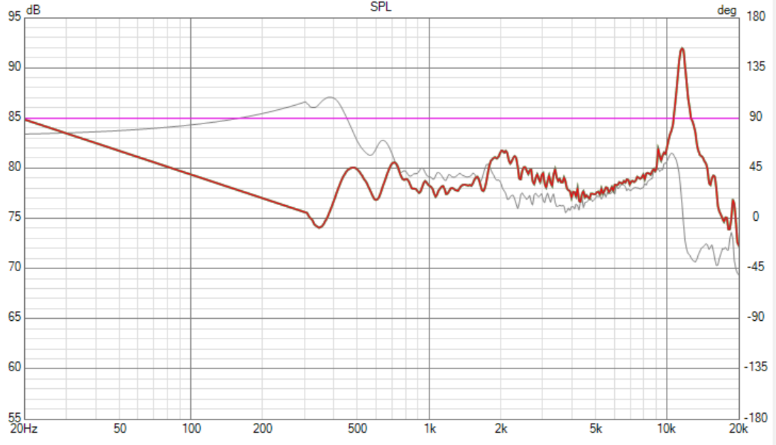

The file is essentially missing data, so Vituix is attempting to fill in the gaps by observing the slope of the response at the end of the data. It’s not doing a great job here due to the lumpy response, likely your measurement window is too long causing this.
The question is how would you like to fill in the missing data? Usually the far field response would be merged with a near field measurement, or you can merge with a cabinet model with diffraction simulation.
To use the measurement as is, you can fill in the missing data yourself using the calculator tool in VituixCAD. The "minimum phase" feature allows you to manually determine the slope of the response for the missing data, and it has a check box there to maintain the measured phase.
